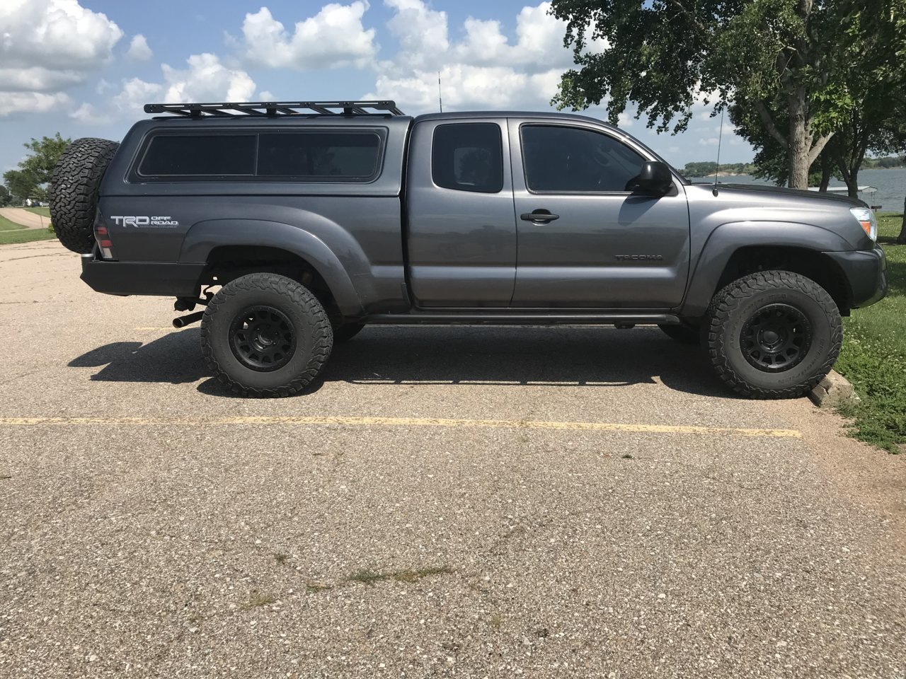

    Here’s my current ride height, I suppose a little drop in the front wouldn’t hurt.

    Put the bumper on then make the decision for yourself. When it comes down to it, you’re the only one who can decide if you like how your truck sits. You can swap out coils in a few hours as well by yourself so the $180 for new ones (if need be) isn’t outrageous. I’d stick with all coil if you wheel, there are springs to solve your issue.

    I say hang the bumper and winch and let it "settle" for a few days then decide. Ive got 887s and a 3/8" spacer on the ds and 1/4" spacer on the PS. With my winch mount and winch and s/c components I'm just under 3" and the ride is GREAT.
