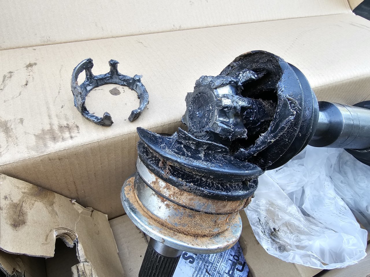

    It was really in there. I had 2 spare CVs with me but I ended up having to pull the tube out to have any luck getting a good weld. No more Advance/AutoZone CVs. Hopefully Nanos luck is better :)
    I'd try pulling the extension tube and smacking the entire thing downwards on a block of wood to see if you can get it to eject itself without disassembling the stub shaft.

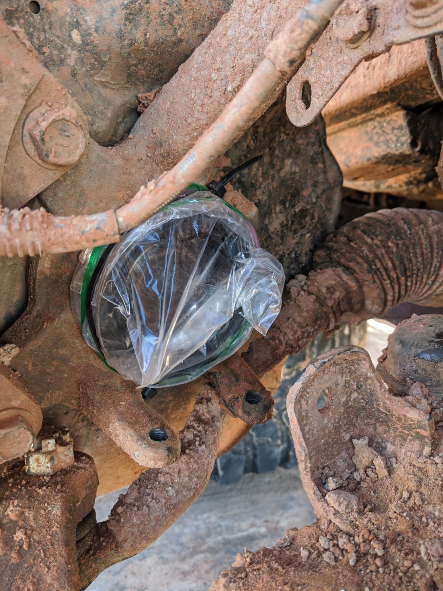

    Since you're far from home you could try and separate the outer stub shaft from the CV so you can assemble it to hold the wheel bearing together to drive on. Cap the tube as well as possible and make sure that shit doesn't leak

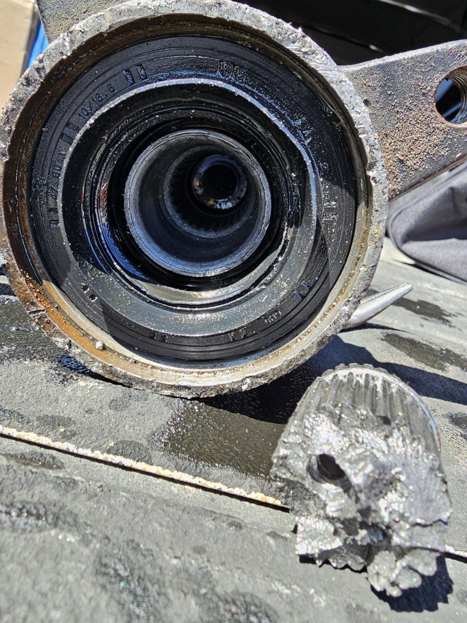

    Update: took the diff tube off. I did a few things to try and remove the lil stubby to no avail. At the end I was pissed and just started slamming it on the floor and it popped out :rofl:

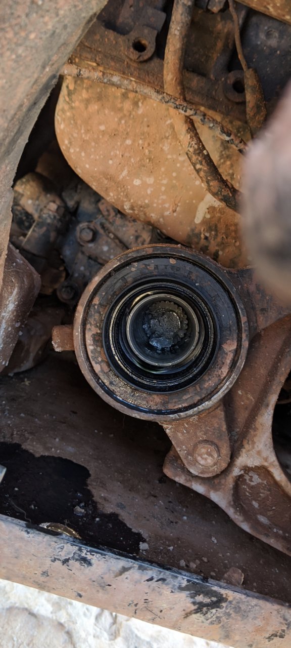

    By the look of it, you'll need a new cv axle seal as well. Just remember, 5.5mm seating depth.
    Reason why I suggested tapping it out is because the diff tube is cast and you don't want that thing cracking on you.

    I pulled the seal off yesterday cause I wanted to get the chunks of metal out. I'll fix it all up and do it right when I get back home.

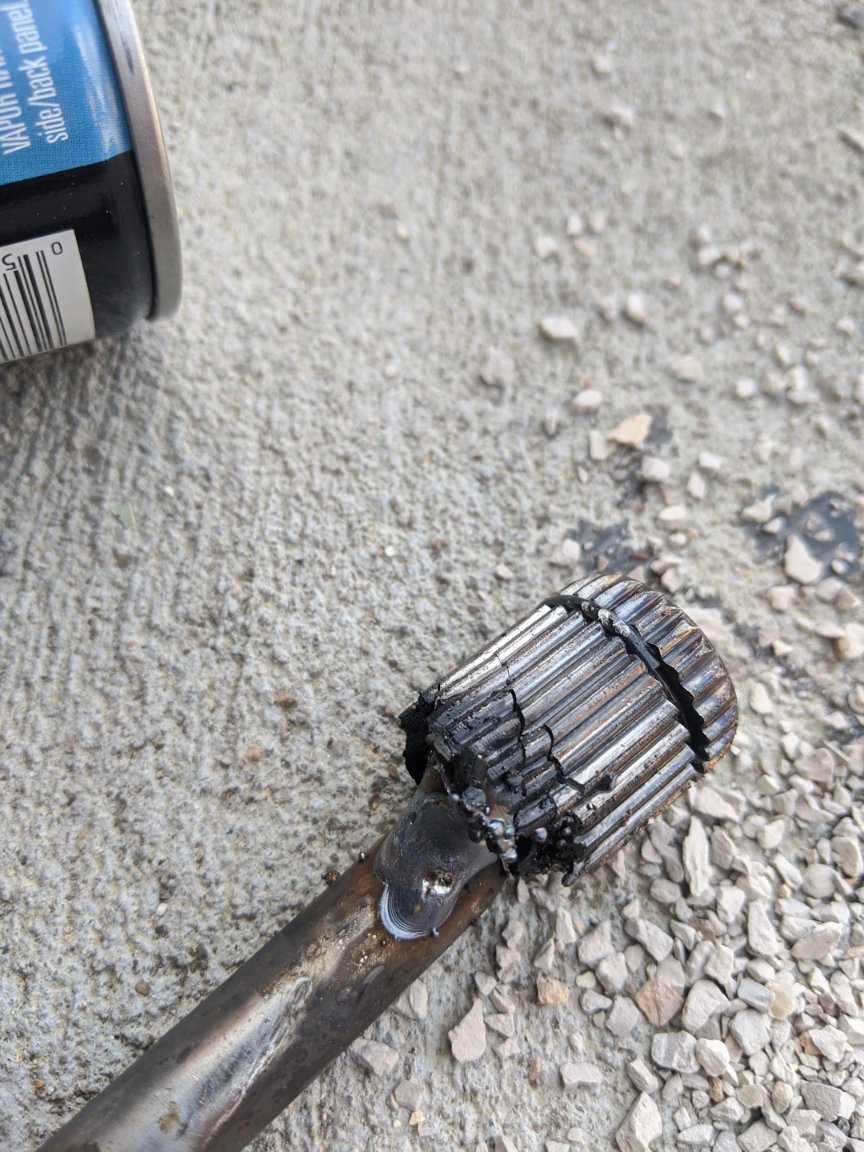

    Update #2: Broke an axle again yesterday lol. Good thing it was at the end of the trail. So I went to the nearest Oreilly's and got it warrantied then swapped it in the same night.
    Maybe these Oreilly ET axles aren't so great after all :notsure:

    Perhaps this one was a bad batch. I did far worse things with the other axle and it didn't break. This one broke out of nowhere.

    Weird thing about your other one that broke in the diff looks like the c clip released the axle partially when it broke. It looked to be over an inch outside of the c clip engagement point in the differential where it snapped off. I figured that is why it dropped out of the diff tube so easily when it hit the ground.

    Oh no, it didn't come off easily :rofl:
