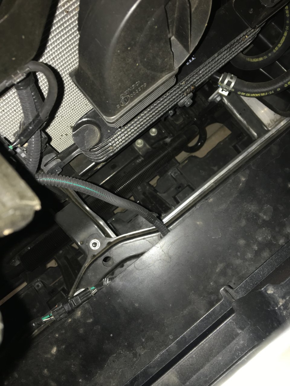

    Yes. Tow package comes with trans cooler., The cooler is under the horns
