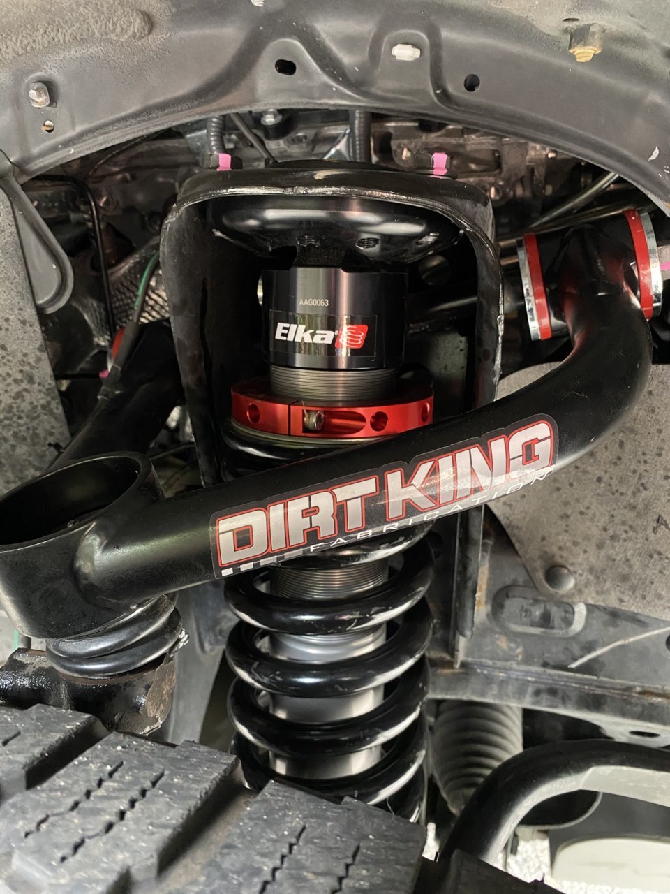

    Exactly the route I’m going

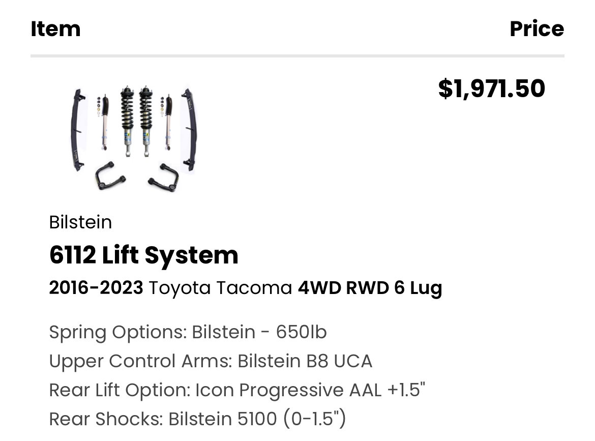

    My first Taco!
    This seems like a decent setup. Now it might be completely ignorant of me to ask this but after reading the lift FAQ it seems like I could skip the new suspension on the rear? Just upgrade front and add AAL for the height? Is it possible or should I get the 5100 on the back. Overall goal is to get 2.5” front and 1.5” on the back.IMG_2287.jpg

    Your question seems legit to me. Hopefully someone with more expertise chimes in, but I think you need the new shocks in the rear because the AAL would "stretch" out the stock rear shock. Not sure, I'm probably the dummy.

    Looking pretty similar over there. Been really happy with the dirt kings compared to my old spc's
