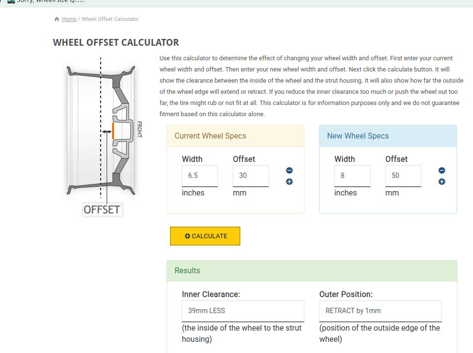

    If you get the correct bolt pattern 5 x 114.3 and hub center 67.1 or BIGGER then you just have to work out the offset.
    Like 1995 mazda rx7 wheel 16x8 is 5 x 114.3 with hub center 67.1 but the offset is +50. I think that would hit on inside. It would probably need wheels spacers and I am guessing probably longer studs to go with the wheels spacer. etc...
    using the factory srunner wheels 6.5 width +30 offset vs rx7 wheels at 8 width and +50 offset shows it almost exactly the same on the outside but on the inside it goes in an additional 39mm. I am thinking it

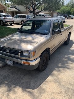

    IMG_3243.jpg :(
    ahhhhhhhhhhh!!!
    seriously, now I would rather re-install the $160 in Rockauto parts that took me 3 weekends and several school nites then do math on this wheel swap!
    enough of my whining.
    1st of all, thanks for all responses/advice
    I absorb.
    as I just found out, I’m kinda looking in wrong areas/sections. Appears I’m applying incorrect info….ugh
    Seanhwy…..thanks correct….60.1 for 75% of CL toy rim ‘deals’ I have found
    Not grinding away 7mm of a circle
    Not an option now
    Jeez, after a week of searching and writing down possible direct rim swaps, I’m more frustrated than ever
    I’m going to start searching for mustang rims on CL
    AND
    Look at your threads
    Thanks again
    dustem….NP
    Hell might buy your stuff for cheap if u find what u want!!!
