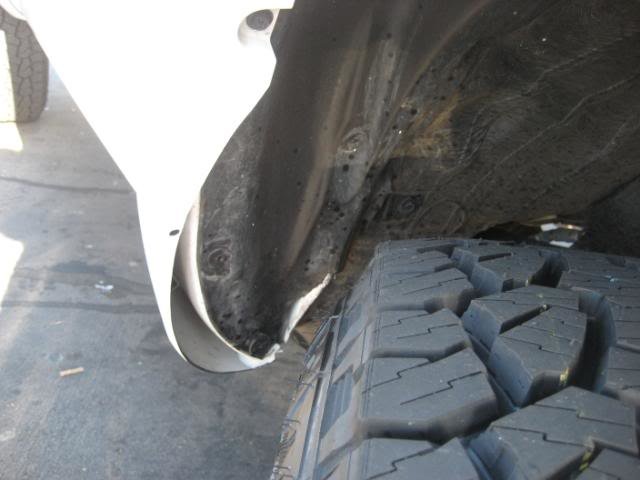

    I also had the body mount trimmed... but you could get away with it.

    I have 285's with 16" wheels... (see my signature for all the specs) and this is a pic of all I had to trim. Im still running the mudflaps. No rubbing at all after a very minor amount of trimming to the inner fender plastic shown below:
