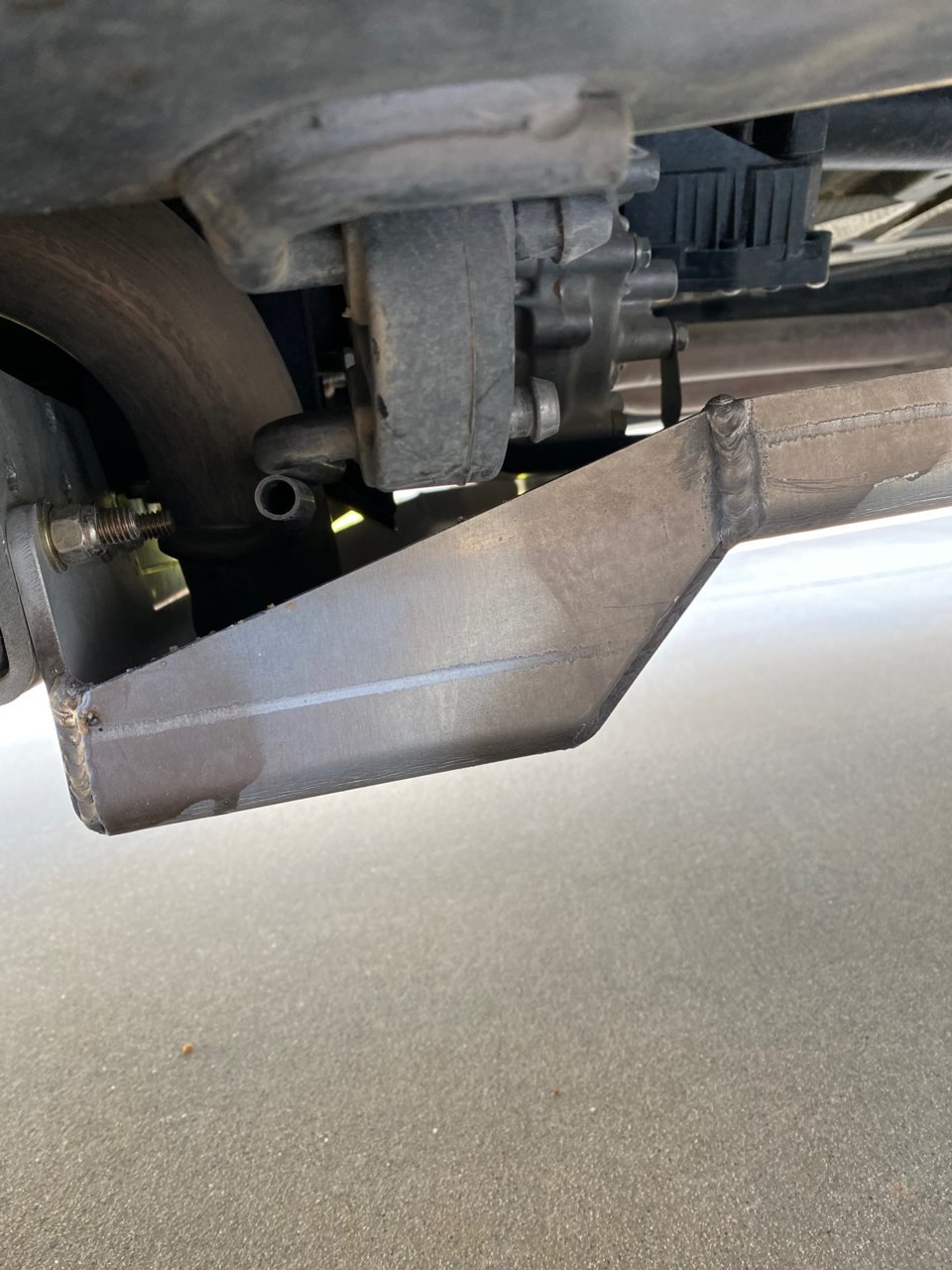

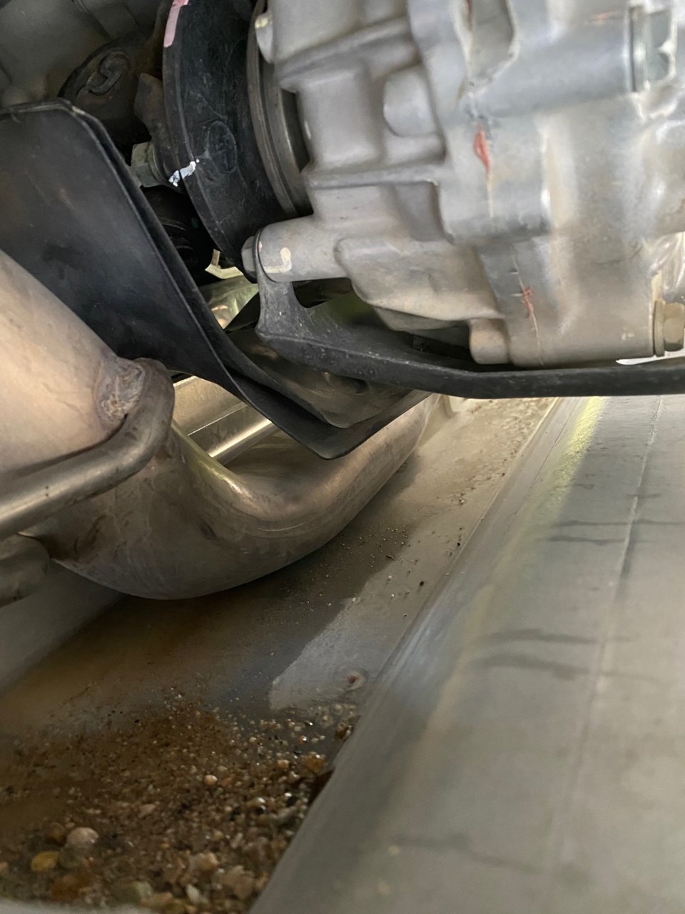

    I came across this thread while researching a similar issue on my 2017 OR 4x4. The noise seems to be drivers side front not insync with the engine but does go away when I am going faster. Only at very low speeds under very low throttle do I hear this moaning/grinding/vibration noise. It started out on the Mojave Road after a bunch of woops. It only used to happen in reverse but today coming home from work I heard it until the truck warmed up then it went away and I could not hear it anymore. But... a week a go I had just got home from work, the truck was good and hot and I heard the noise backing slowly into my driveway. It almost sounds like a loose skid vibrating when the engine is at a certain RPM but I have been unable to figure out where exactly it is coming from. By the time I get somewhere or get someone to help me listen to where it is coming from the noise is gone. Any ideas?
    Hear me out for a sec..... could it be the low hanging exhaust vibs on the transfer case skid?? But only at certain low RPM?
