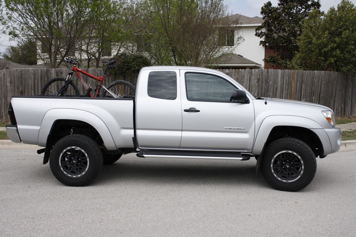

    Here's a pic after I finally finished everything.
    Bilstein 5100s all around + Toytec 2" AAL
    I haven't even made my first payment on the truck and I've already bought new wheels, tires, shocks, aal, and did the tinted tail light mod. On top of that, I have a grill on order and materials for the BHLM. This forum is evil.
