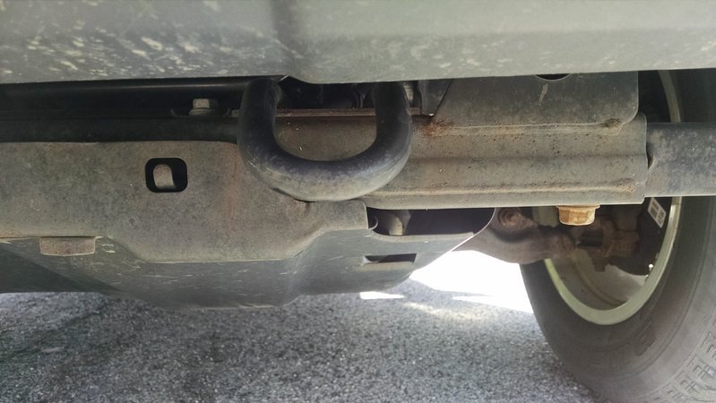

    The other issue is that the front bumper requires me to chop off the driver's side tow/recovery/tie-down loop/hook.
    OK. That sounds easy enough. But then I realize I don't have the right tools for the job. I was going to go at it with a 20V reciprocating saw, but noticed it's welded on the inner sides too. So, now that sounds like a bad idea, if it was ever a good one, or just won't really work.
    I thought of picking up the Harbor-Freight-special angle grinder(?), oscillating tool(?), but would those really fit in there? I know there will be more room once the stock bumper is off, but it still seems tight from videos I've watched.
    What is the right tool for the job? Reciprocating saw? ? ? Something else?

    I picked up an angle grinder. Getting that hook off was still not what I expected. I was hoping to cut the welds and take the whole thing off, but it's too tight in there I just chopped off the offending end and grinded it down so the flat surface of the bumper had no chance of contacting it.
