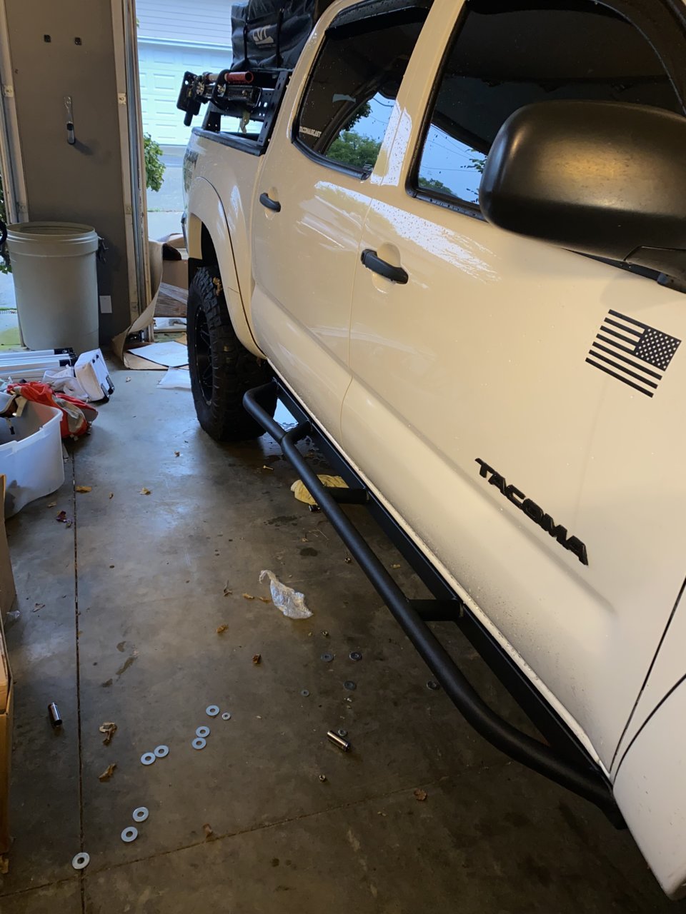

    Hey tacomaworld. Having trouble fitting my SOS sliders. so backstory my good friend ordered sliders from sos about a year and a half ago and had a problem with the fitment on the driver side. He explained it thoroughly to me because SOS had apparently gone cold on him saying it was his truck that was the issue. He ended up having to grind down the corner of his driver side slider to get it to fit. Fast forward a year and half later, I decided to bite the bullet on sliders from SOS as well despite the problems he had. I got them in today and installed the passenger side in not time - what a breeze I thought. I then moved on the driver side and after getting everything bolted down I noticed there was still a gap between the slider plate and the frame. Hmmm.. take a peek under and low and behold there’s a pin on the driver side that’s not on the passenger side, and there’s no cutout for it in the slider plate. I immediately FaceTimed the said friend, and it’s the EXACT same problem he had that went ignored and blamed on him. I’ll attach some pictures so you guys can visualize the problem. Super frustrated because I’m going on a trip in 2 days and was told by Eddy I don’t need to do ANY cutting for the sliders whatsoever.
    So here is the passenger side 100% installed. Took me about an hour.

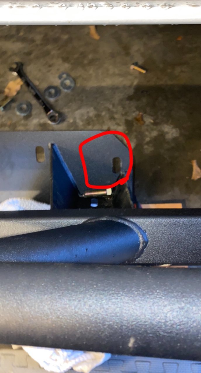

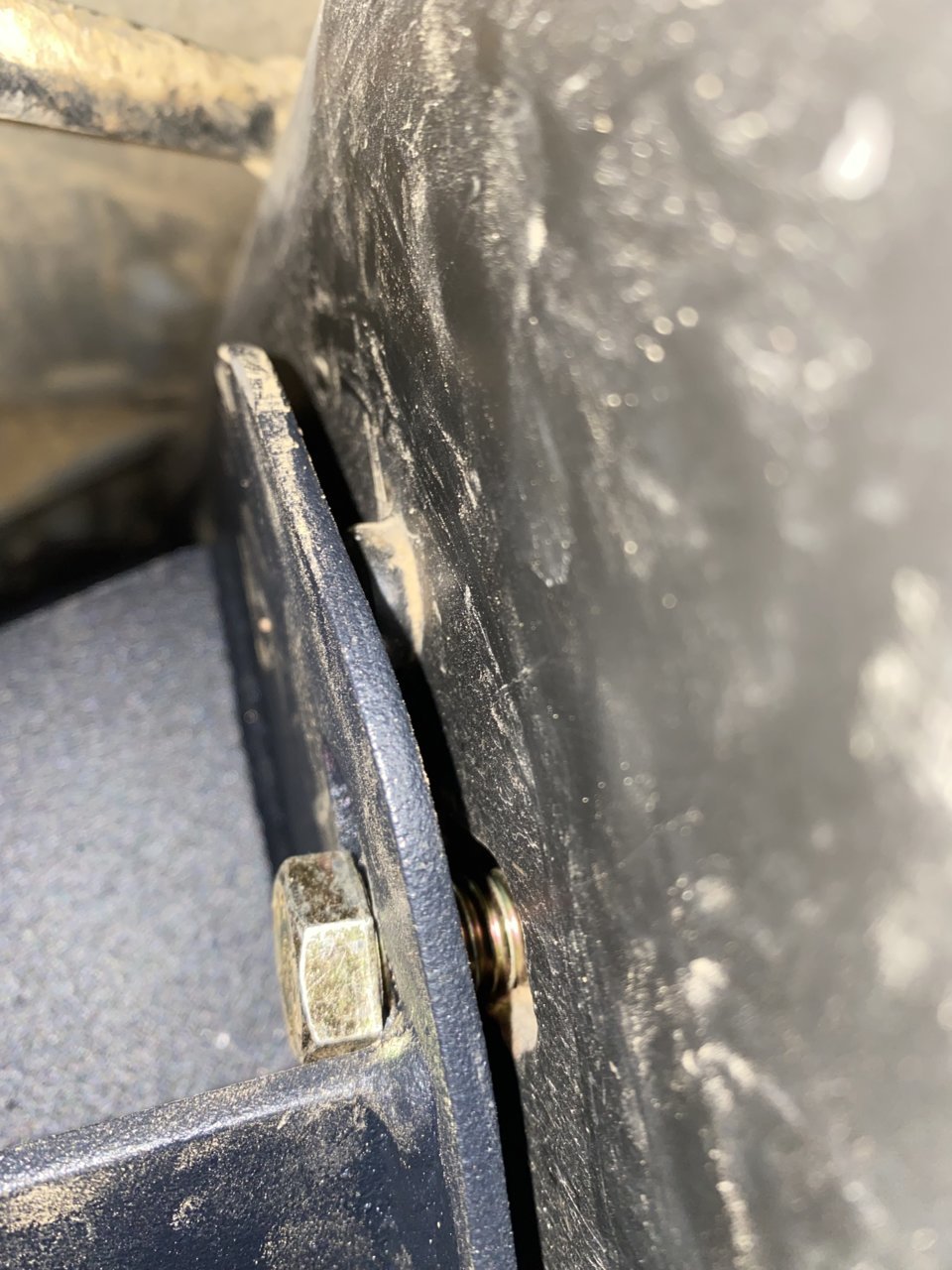

    Now here’s the driver side. Got everything bolted on and noticed this pin that has no cutout for it, leaving a gap. And yes, this pin is definitely stock.
    Notice the gap? There’s a pin directly above the bolt as you can see. But no cutout for it. This pin is ONLY on the driver side.
    I’m just frustrated that a 2 hour install is about to turn into a 5 hour install. I emailed Eddy before ordering to make sure they were 100% bolt on, and he assured me they were. Thinking if they would’ve listened to my friend a year and a half ago when he had this problem, they would have fixed it. Rather than blaming it on him. Sorry for the rant and I would appreciate any ideas. Super bummed

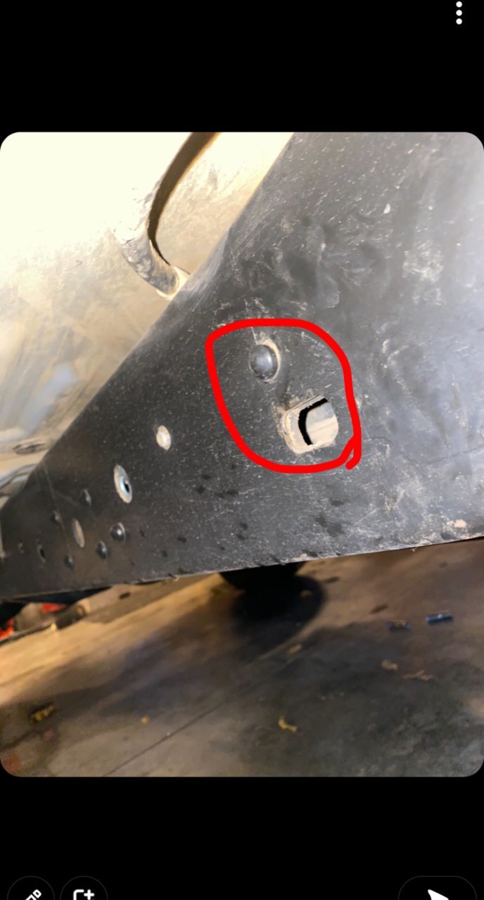

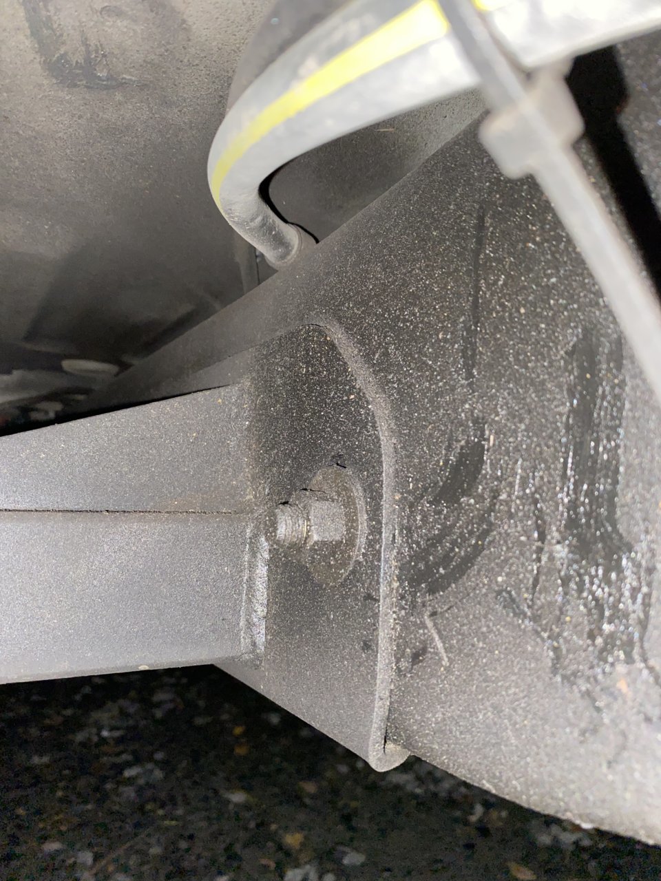

    Here’s some more pics of the driver side for reference.
    the frame (notice the pin above the hole)
    The slider plate (Notice no cutout for the pin)

    But at this point I'd drill a hole in the proper place on the plate and hit it with a rattle can. :burp:

    Best bet is to use a grinder with a cutoff wheel and make a notch where that rivet is it won't harm the slider at all. Is the trip you're taking going to need to use those sliders?

    2005 TRD OR. Can you check to see if there is a pin above the farthest back mounting point on the driver side?
    Like this

    Just went out and looked. My 2011 doesn’t have that pin. The slider is flush against the frame.

    I had the same problem with my 08
    I drilled out a hole..
    I’ve had my sliders for about 5 yrs..
