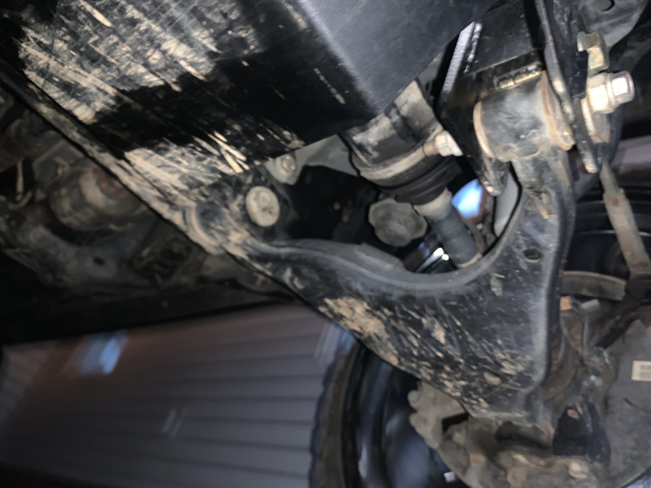

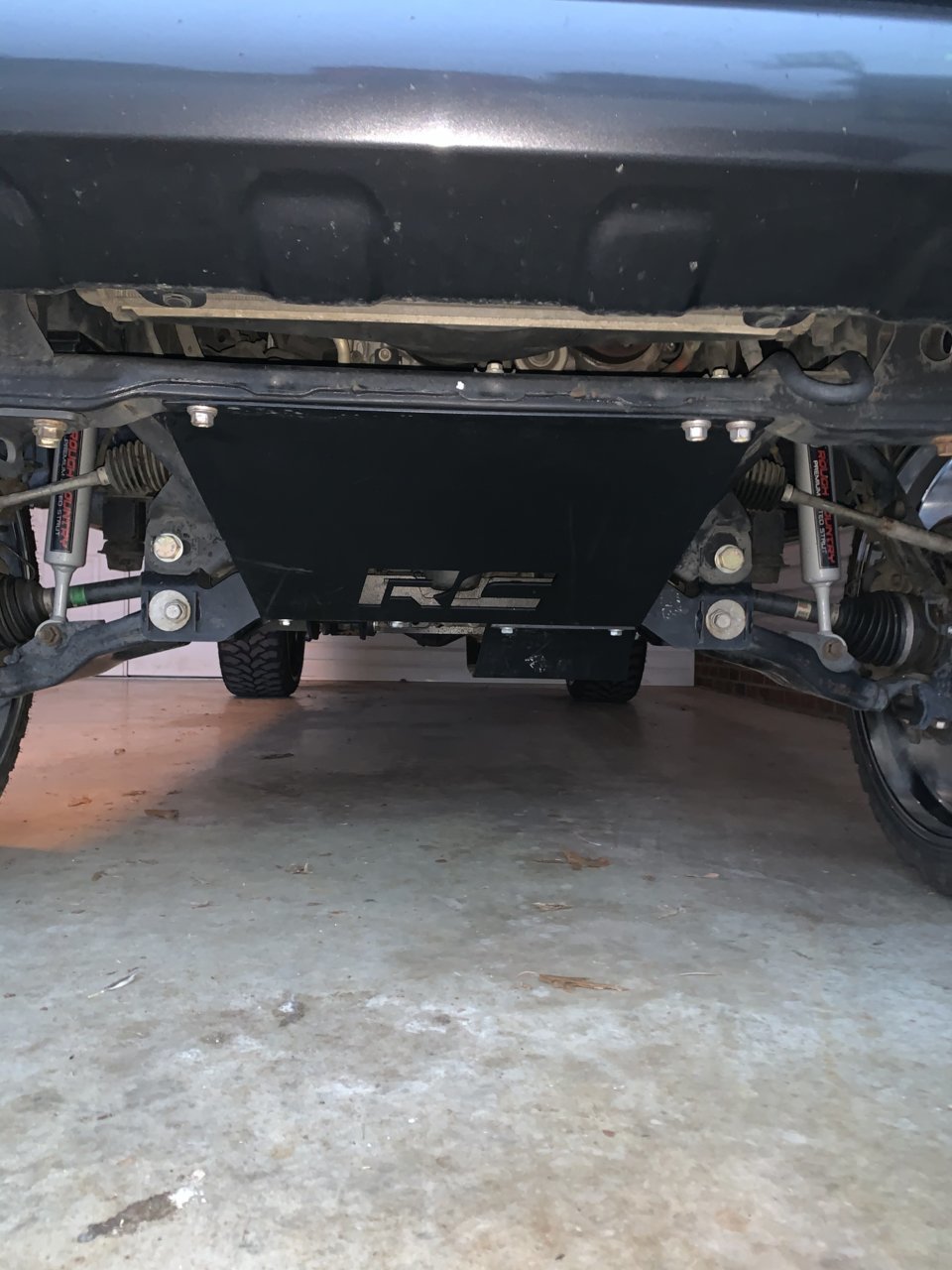

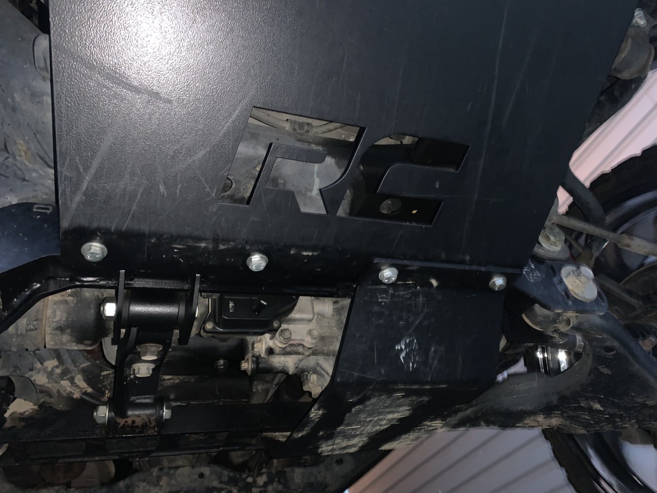

    1. Those coilovers have probably lost a bit of performance over the years, since they cannot be re-built you might consider replacing them.
    2. Looks like it was modified to bump stop off the UCA, you could remove that and replace the stock bump with a softer, larger version (dynastar, wheelers, timbrens, etc.)
    3. Check all the ball joints and bushings on the UCA, LCA, steering rack and sway bar, they might need replacing.
    4. Looks like the steering rack has a leak or something causing the staining on the lower portion of the boot. Steering rack might need to be replaced.
    5. What everyone else said, big wheels and thin tires are not helping your cause....
