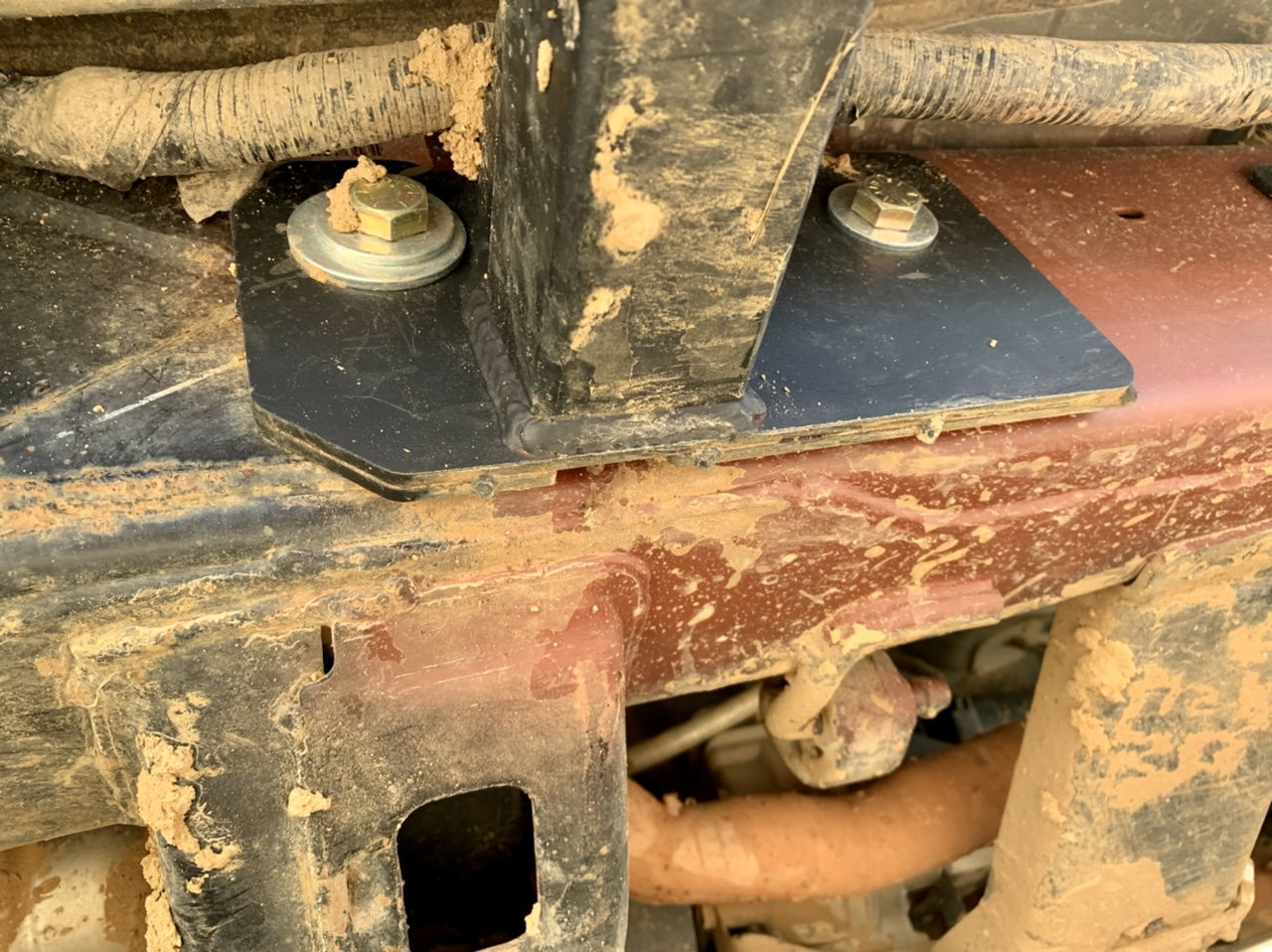

    Resized952020110295120423953678.jpg Resized952020110295120423953678.jpg rear mount pad

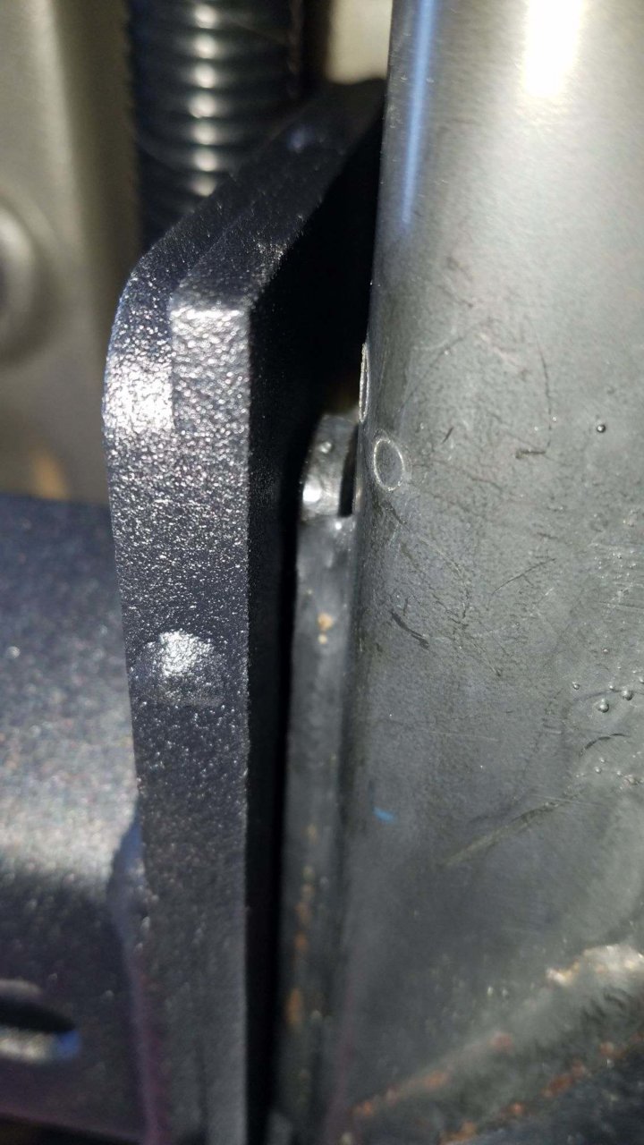

    Resized952020110295120534957573(1).jpg forward mount pad

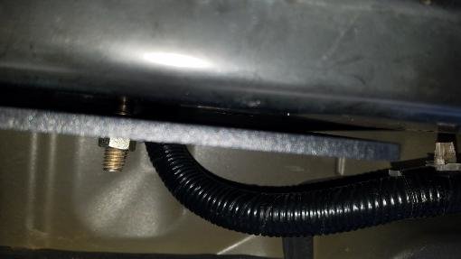

    Resized952020110295120634959665.jpg center pad gap.
    I'm sure it'll close some as i torque, but thats a lot of gap to close. I'm worried about pulling the frame out as i torque down the center?

    Is this because the front of the slider is hitting where the cab mount is?

    You have a bolt on the bottom? I’d run the bolt up in the bottom to keep the lower tight.
    then tighten up all the side bolts.
    TacomaDad18 likes this.

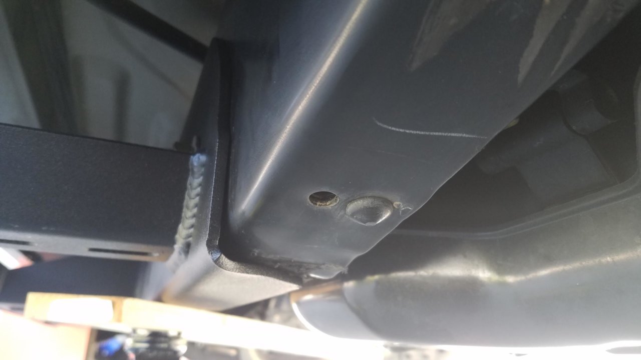

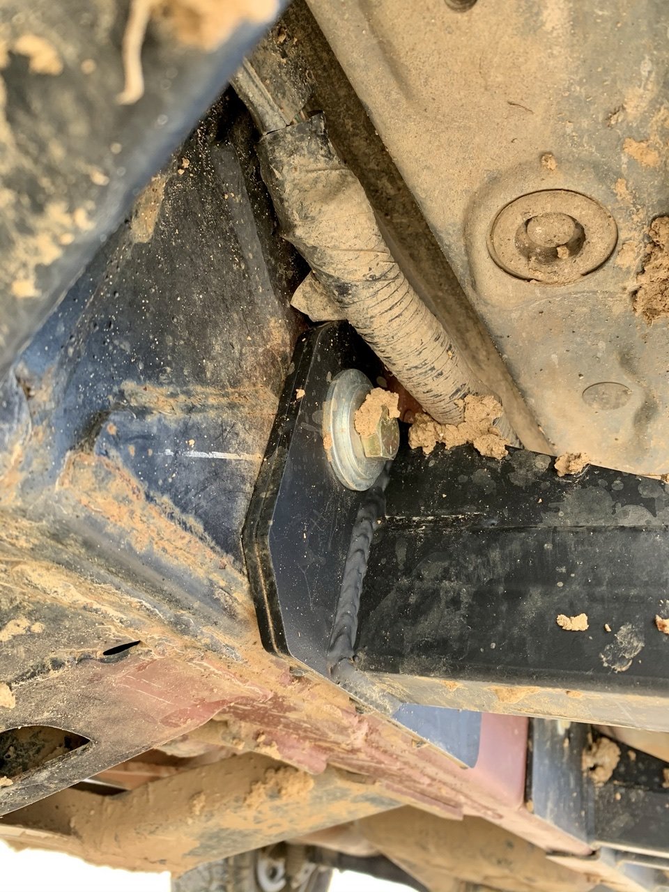

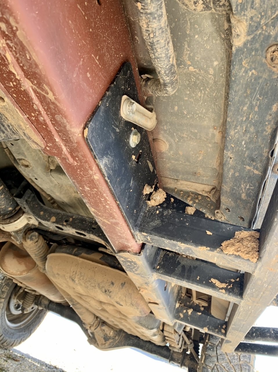

    Here are what mine look like. Just took these.
    446C4C4B-8667-4DCB-B7F1-589A8E179A16.jpg 3DC4B0D3-26D6-4F6C-8391-D1A785D9DD86.jpg 1C005848-9D33-401A-B3BC-7FE26FB4CDCA.jpg

    He upgraded the design.... the arms are different but the mounting should be the same. Did you pop all the plastic pieces off the frame that may have been in the way?

    Torque it!! My money is on the gap will close, or the bolt will snap. Doubt you pull or tweak the frame.

    Send it. Just talked to the guys at sos. They said gap is normal. @AnaRandy

    That's not that bad a gap. Make sure there's the big included washer on the side where the frame is.
    If you use your sliders offroading, they (and the frame) will flex a whole lot more than that much. You won't do any damage here.
    He's not Walmart, he's a small business. It may take him a while to get to help you, but he'll take care of you.
