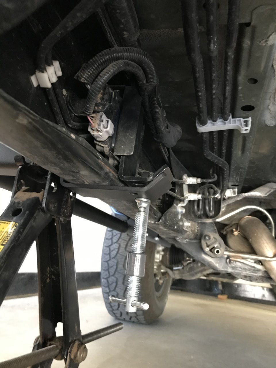

    loosen the front back and torque the middle ones first, or try even tightening or use a c-clamp here or there. Wiggle and jiggle. I am betting big money against you torquing the frame out of square with 1/2" drive ratchet. Not the same sliders here but just to give Ya an idea or two.
