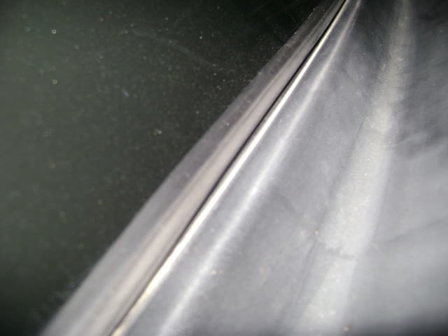

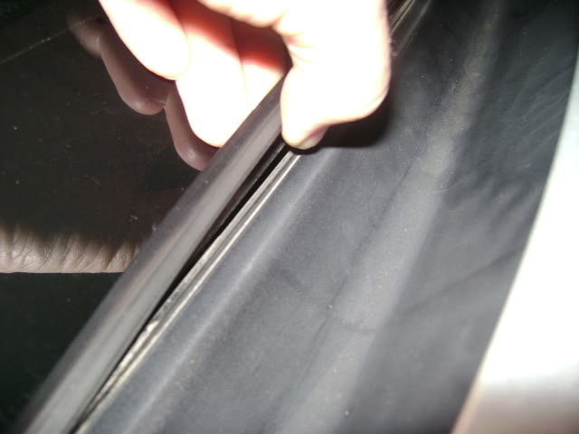

    I know yall are saying it is inside the vehicle but check outside at the base of the windshield there is a little black strip that ties the plastic and the windshield together it sometimes comes loose. I had a humming sound but could never find it after a while it turned into a thwacking sound and only happened at 65+ mph.
    First maybe get someone to apply pressure to your dash from inside to see if it will stop.
