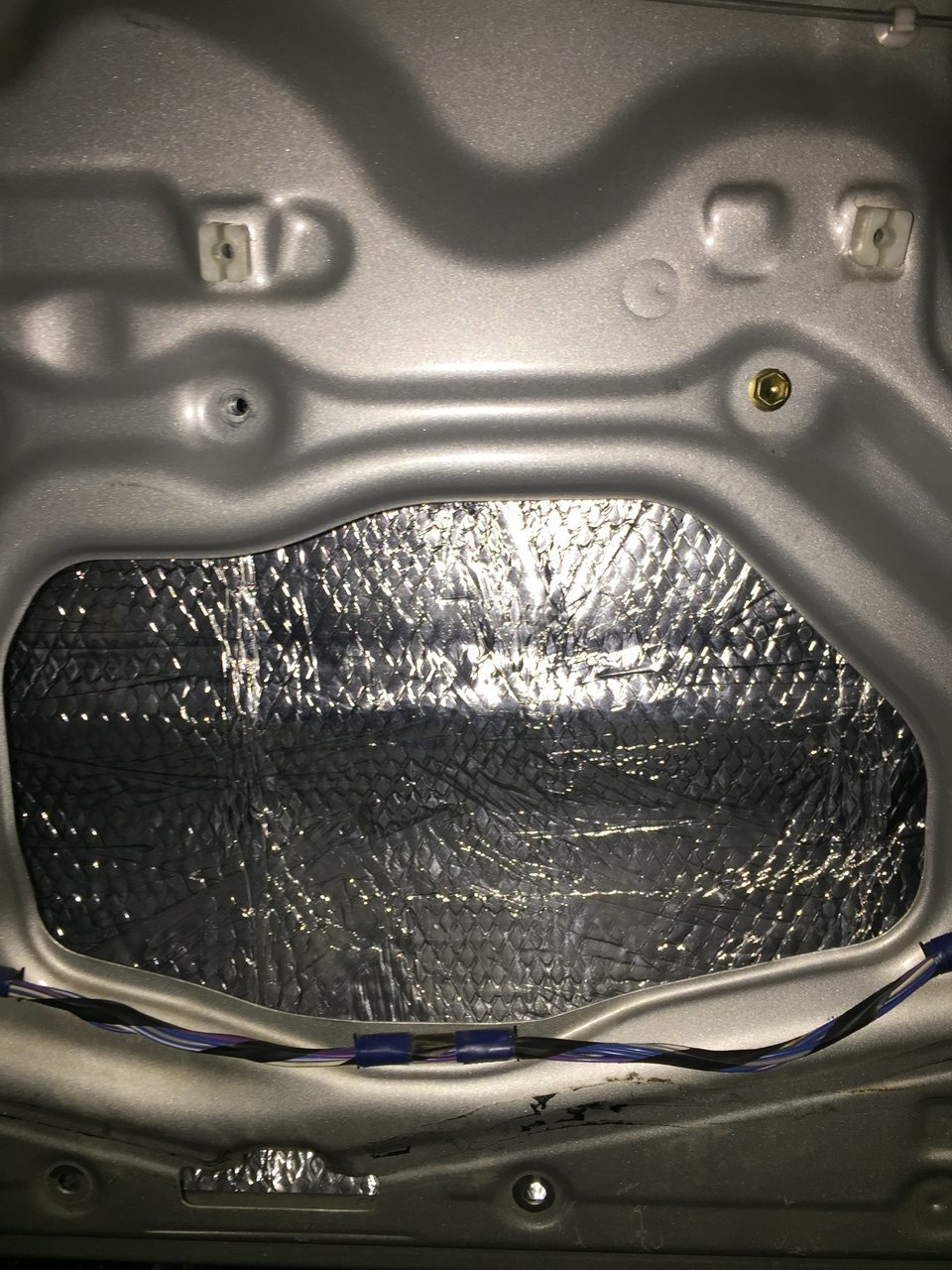

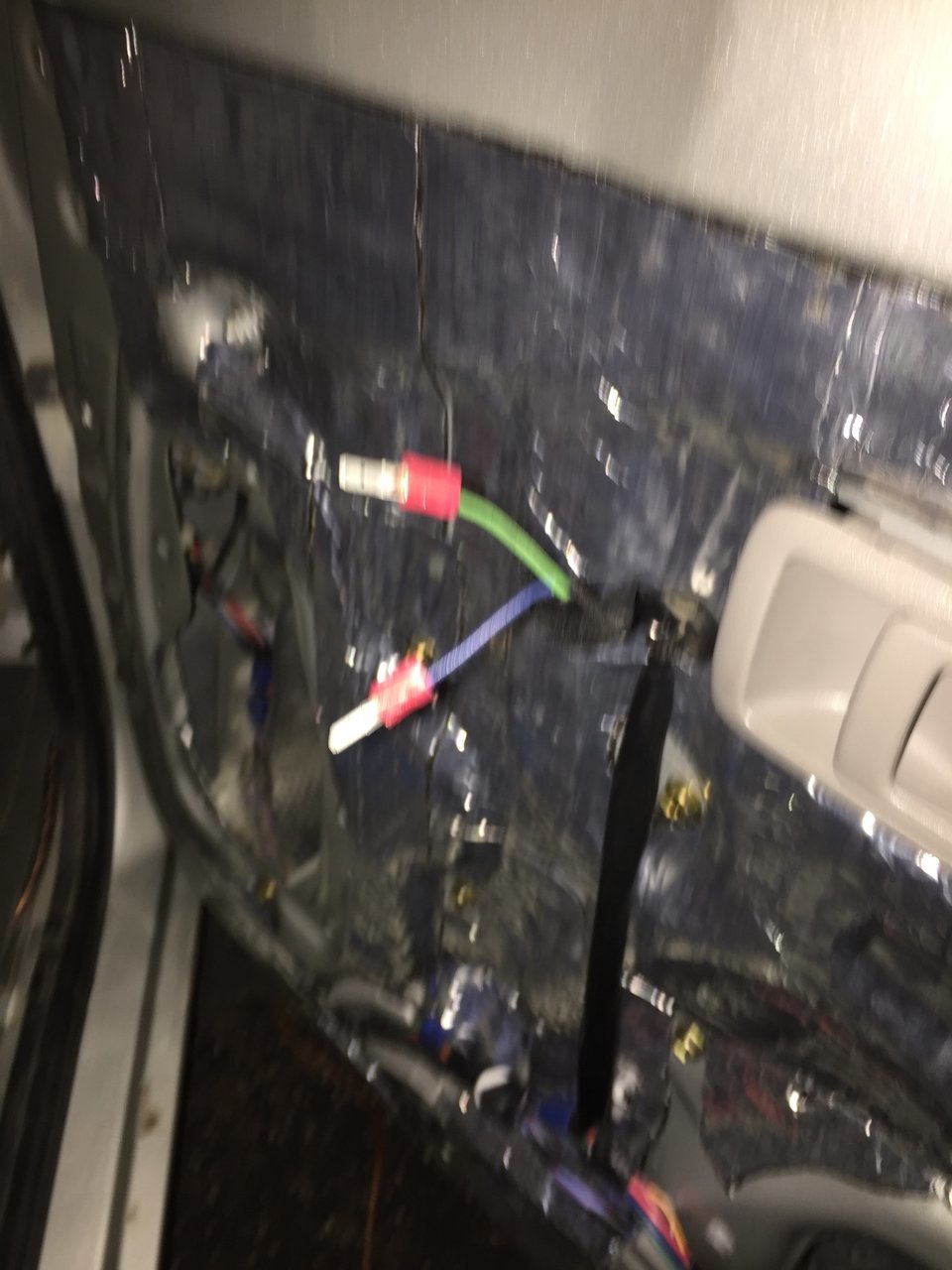

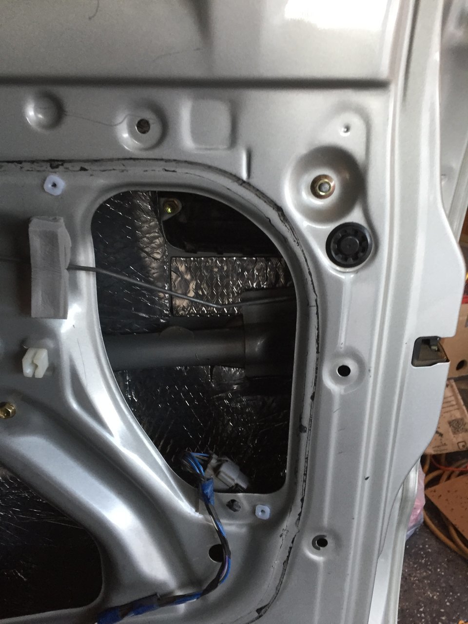

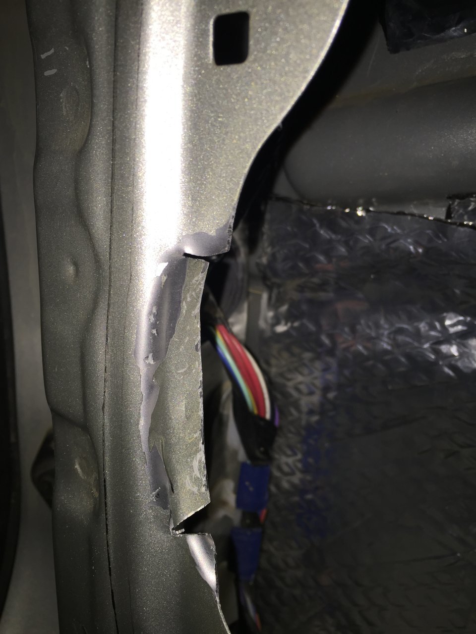

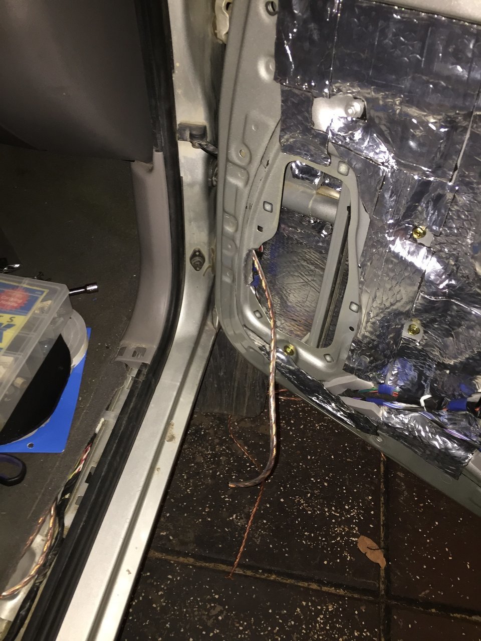

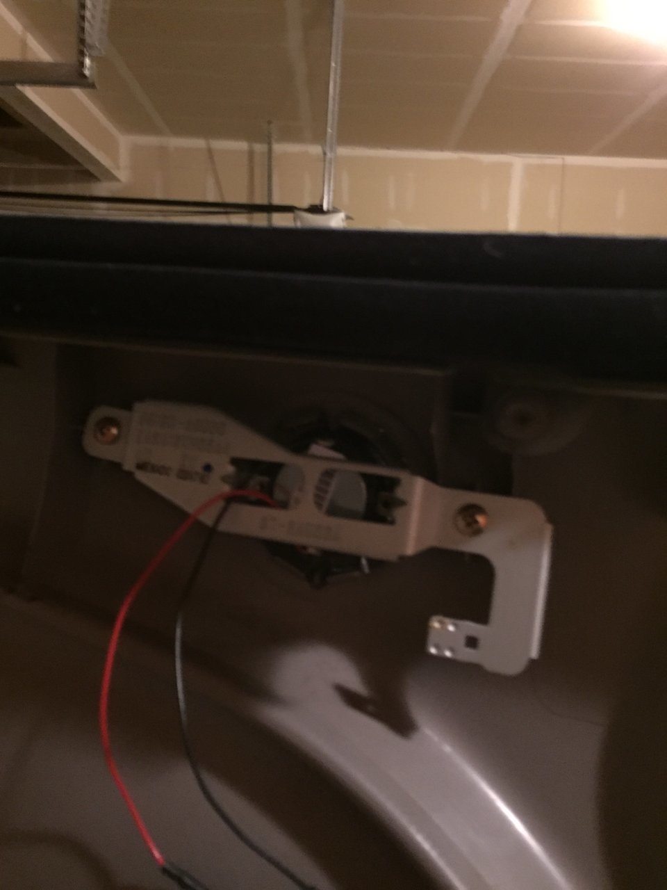

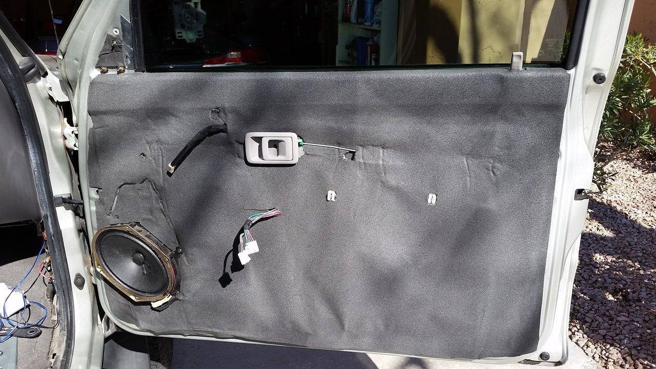

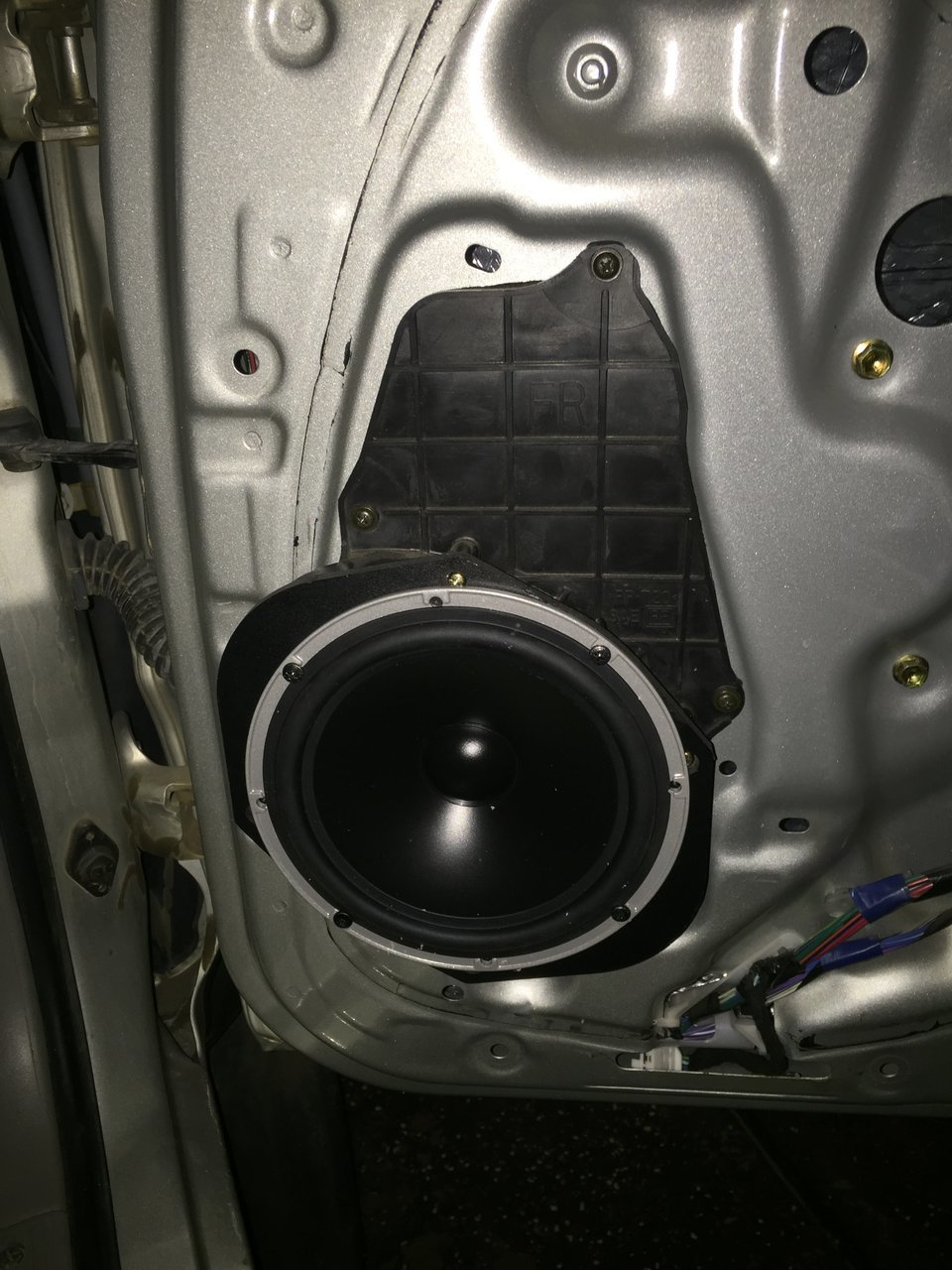

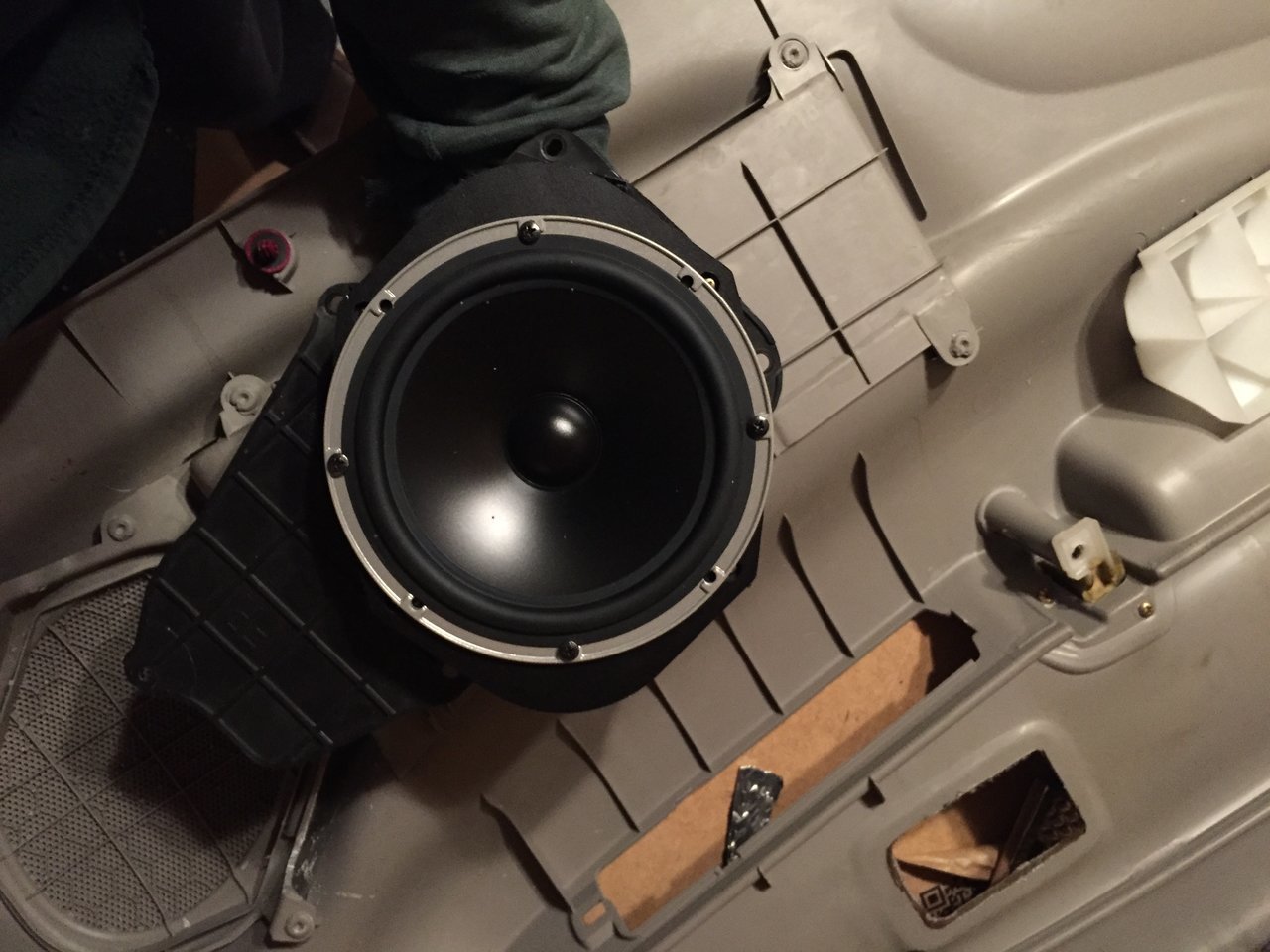

    Here’s another update on a JL audio speaker system in my 2002 taco. Just to give you other 1st Gen folks ideas.
    Tweets fit nice and snug with no mods.
    More pics to follow

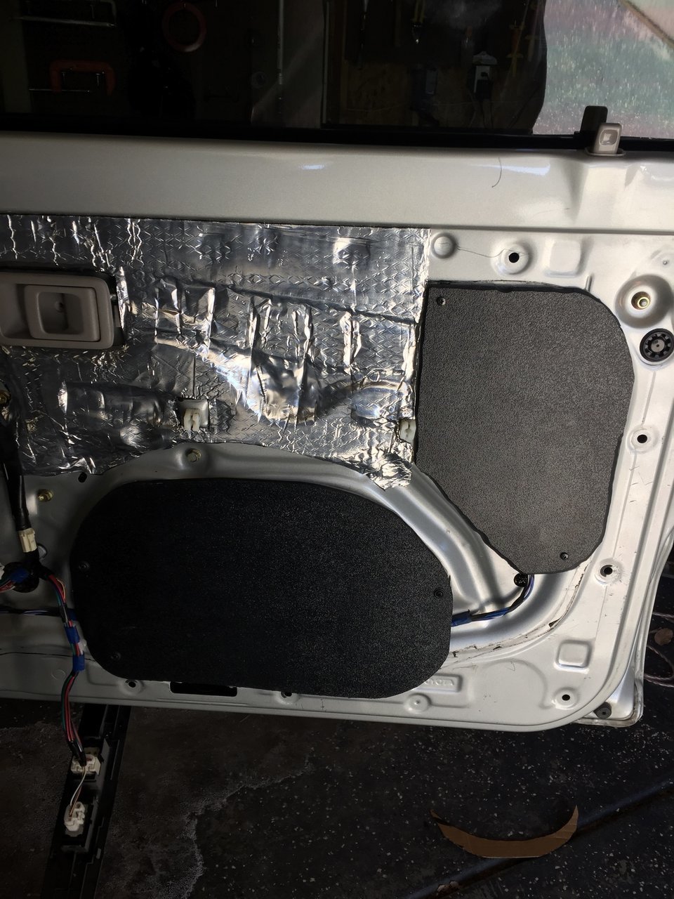

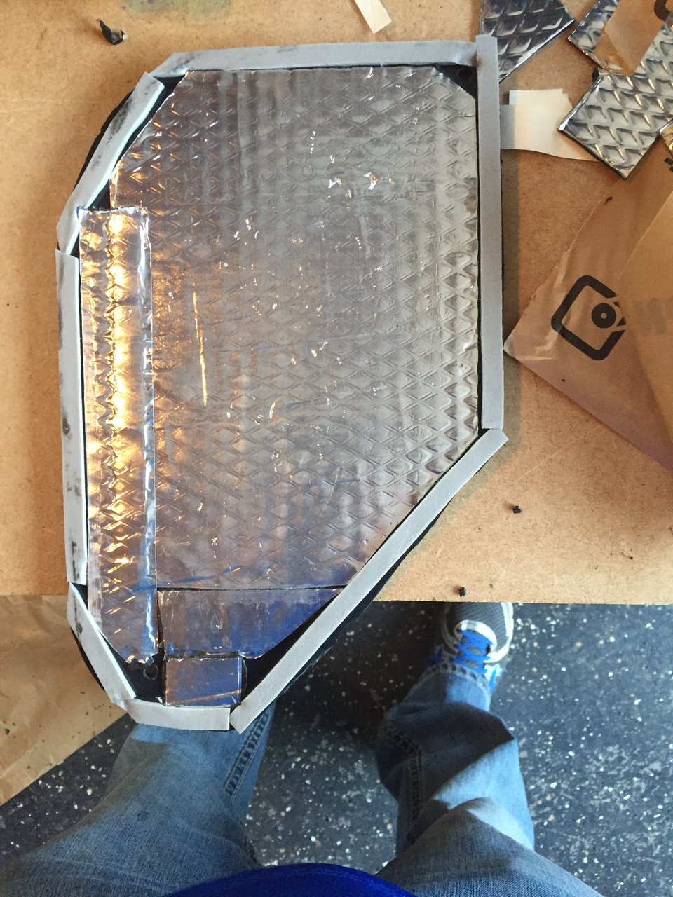

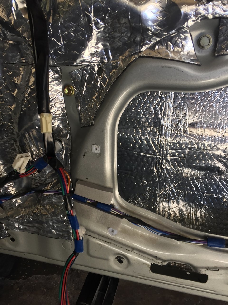

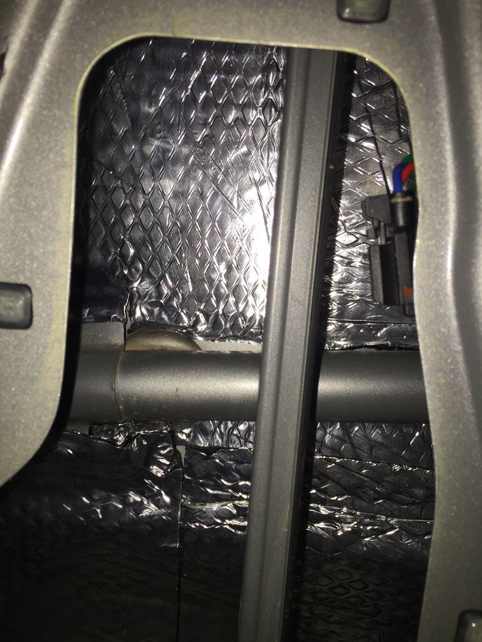

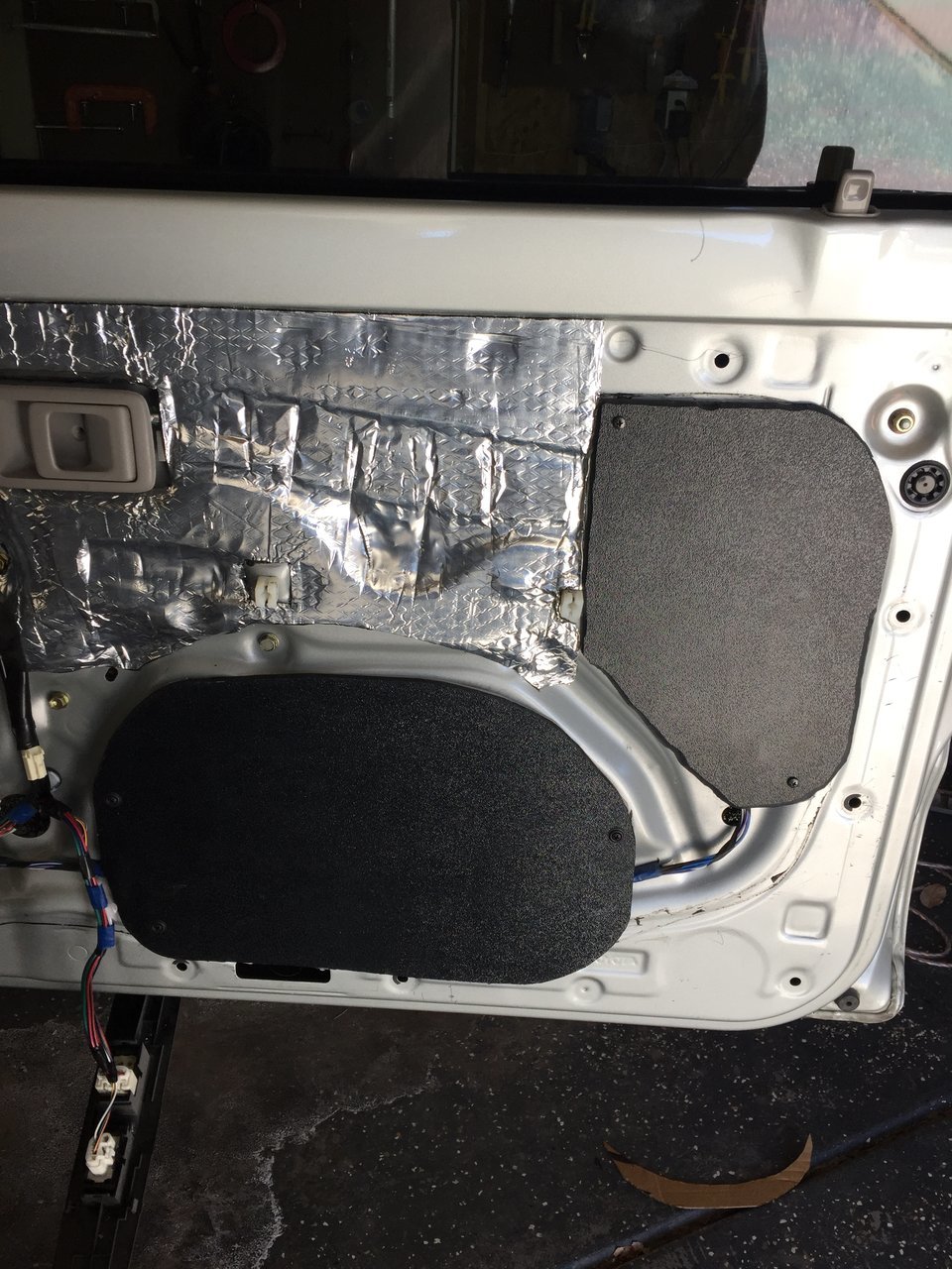

    20170204_123724.jpg Were did you pick up the plastic you made that cover with. I just put a later of GTMat them Rammat foam draped over the whole door.

    What was that black piece for Ryan?

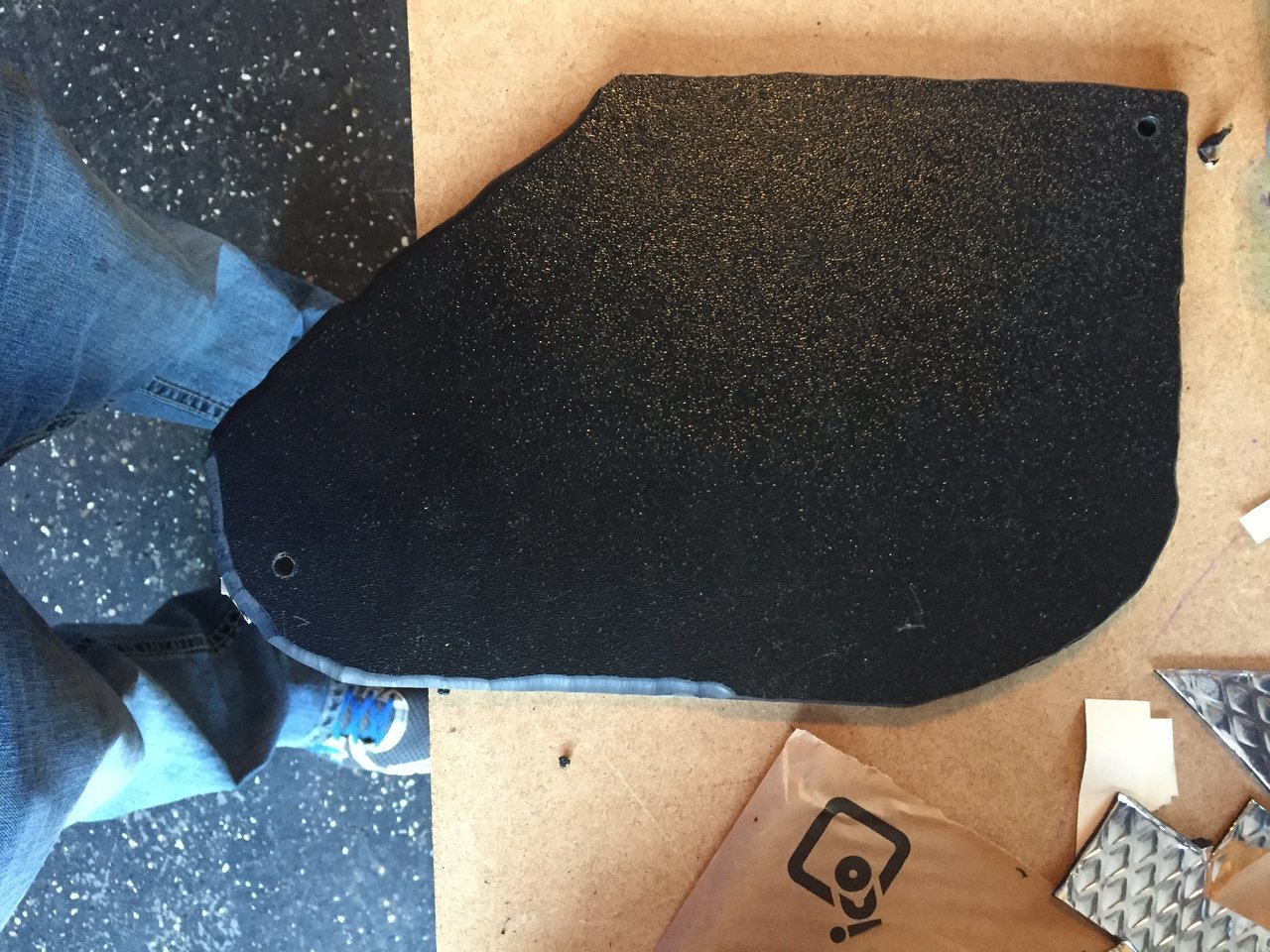

    Black piece is a piece of ABS I bought on Amazon . Used tape on window sealant (gray stuff)on the back. I will create another piece to cover the other hole. This will seal the entire door for the speaker.
    More pics coming soon

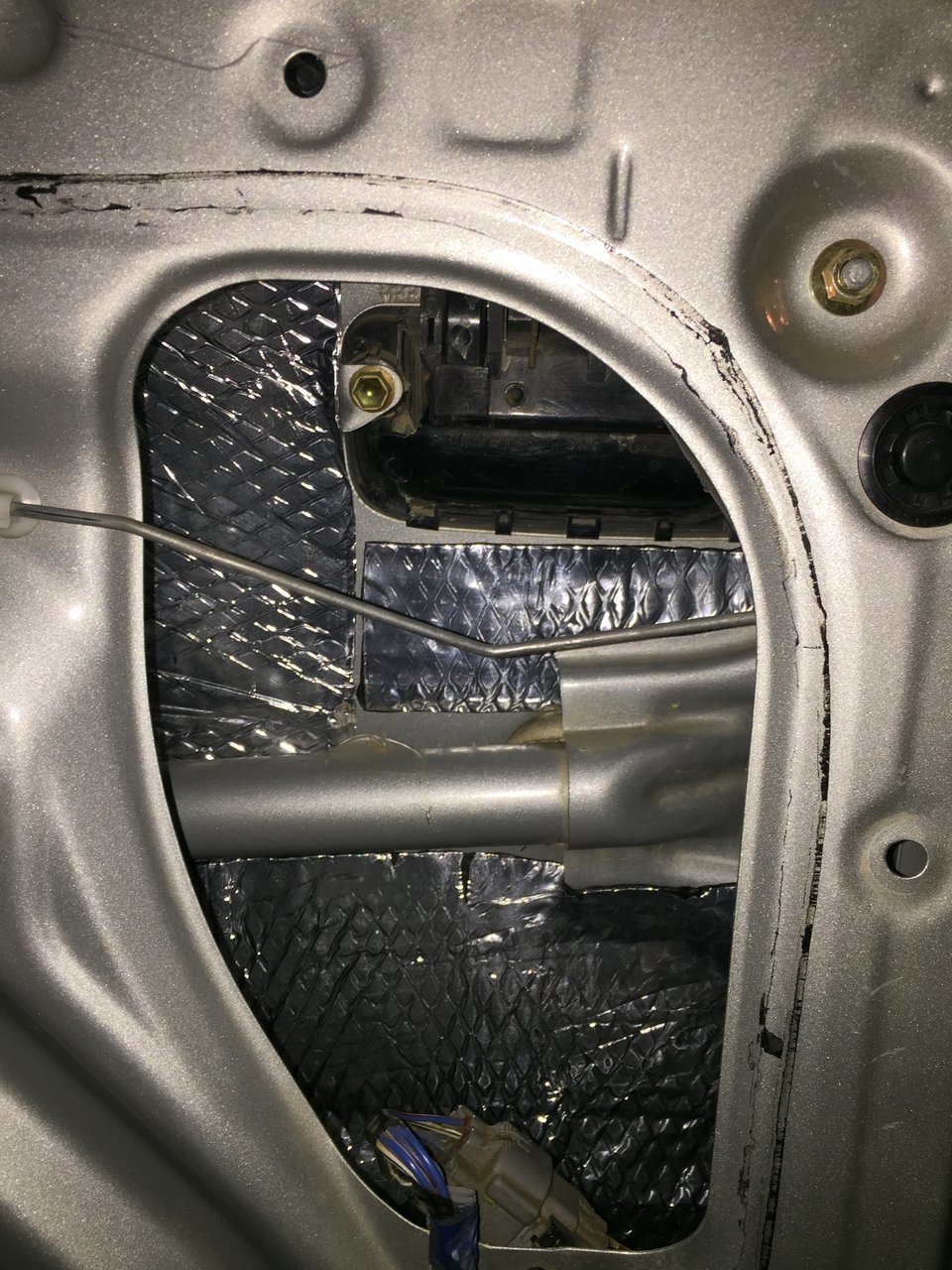

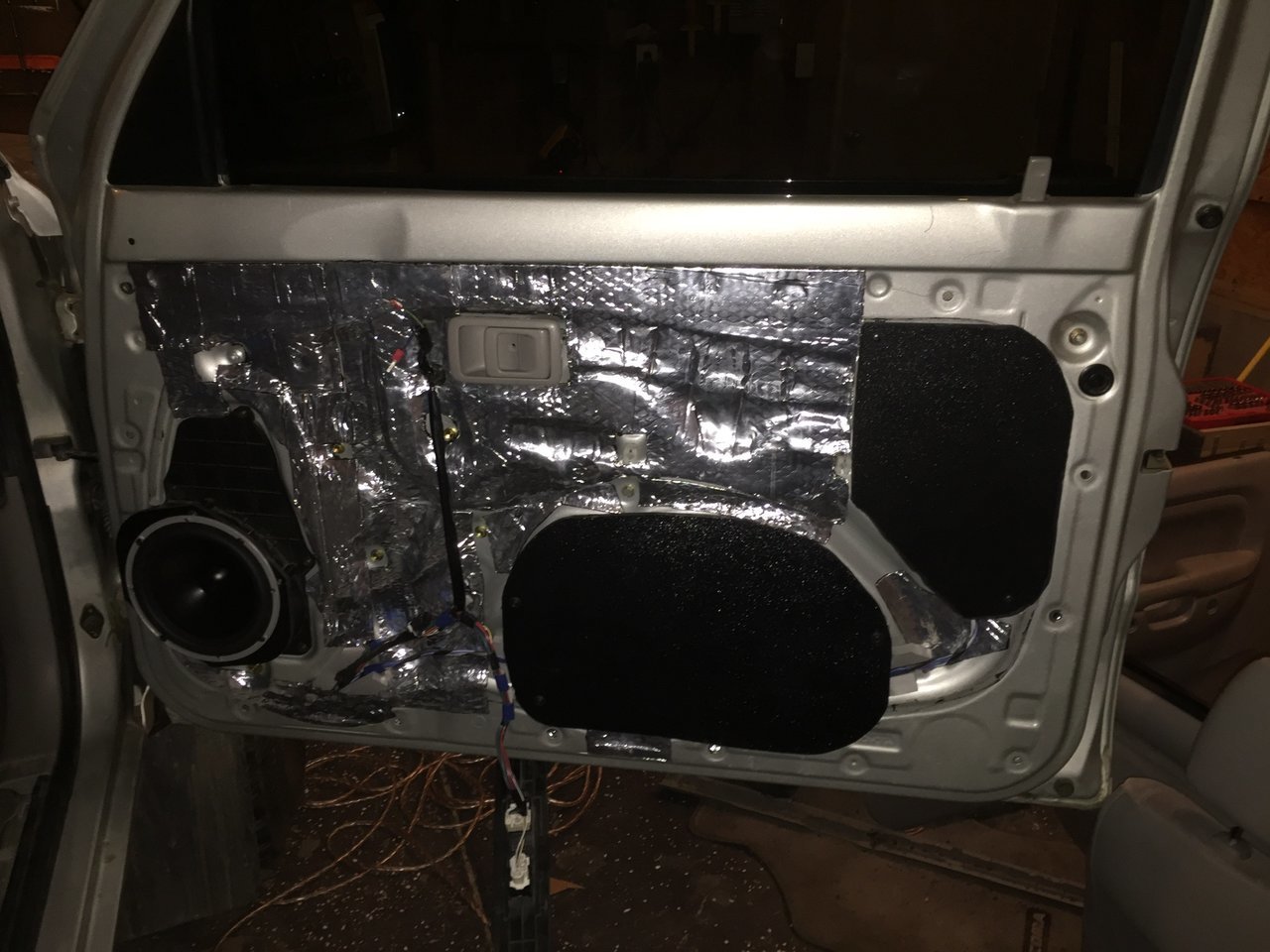

    Done with doors
    Next, sound dampening back wall behind subwoofer.
    Then moving on the the engine for headers!

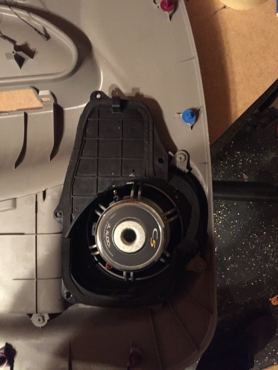

    Hey Chance,
    These C5 sound amazing! You can really hear all the details. I don’t even need rears anymore (which I removed).

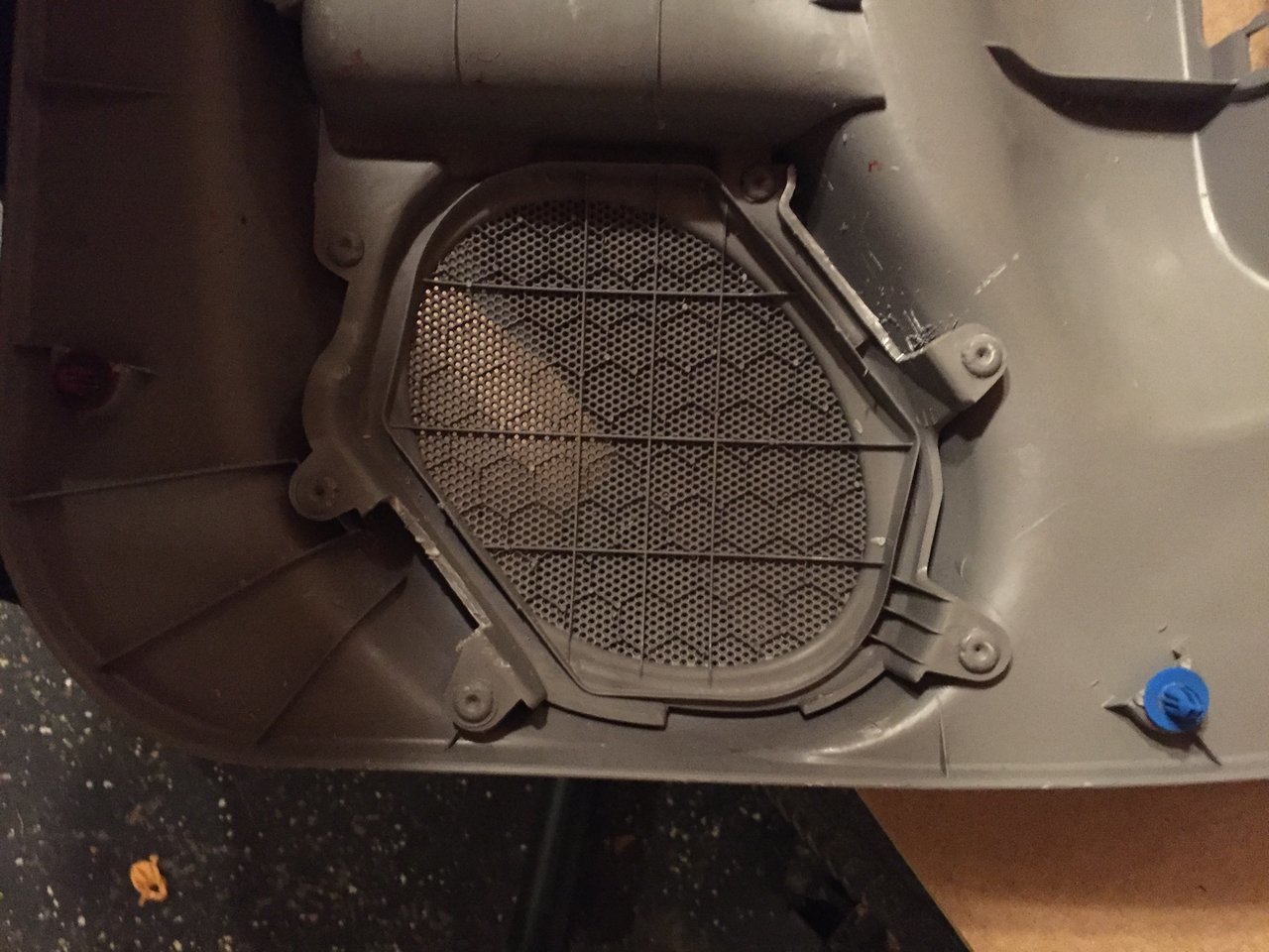

    Note
    No need to cut the metal on the door. I didn’t on the driver door a the speaker fit fine.
