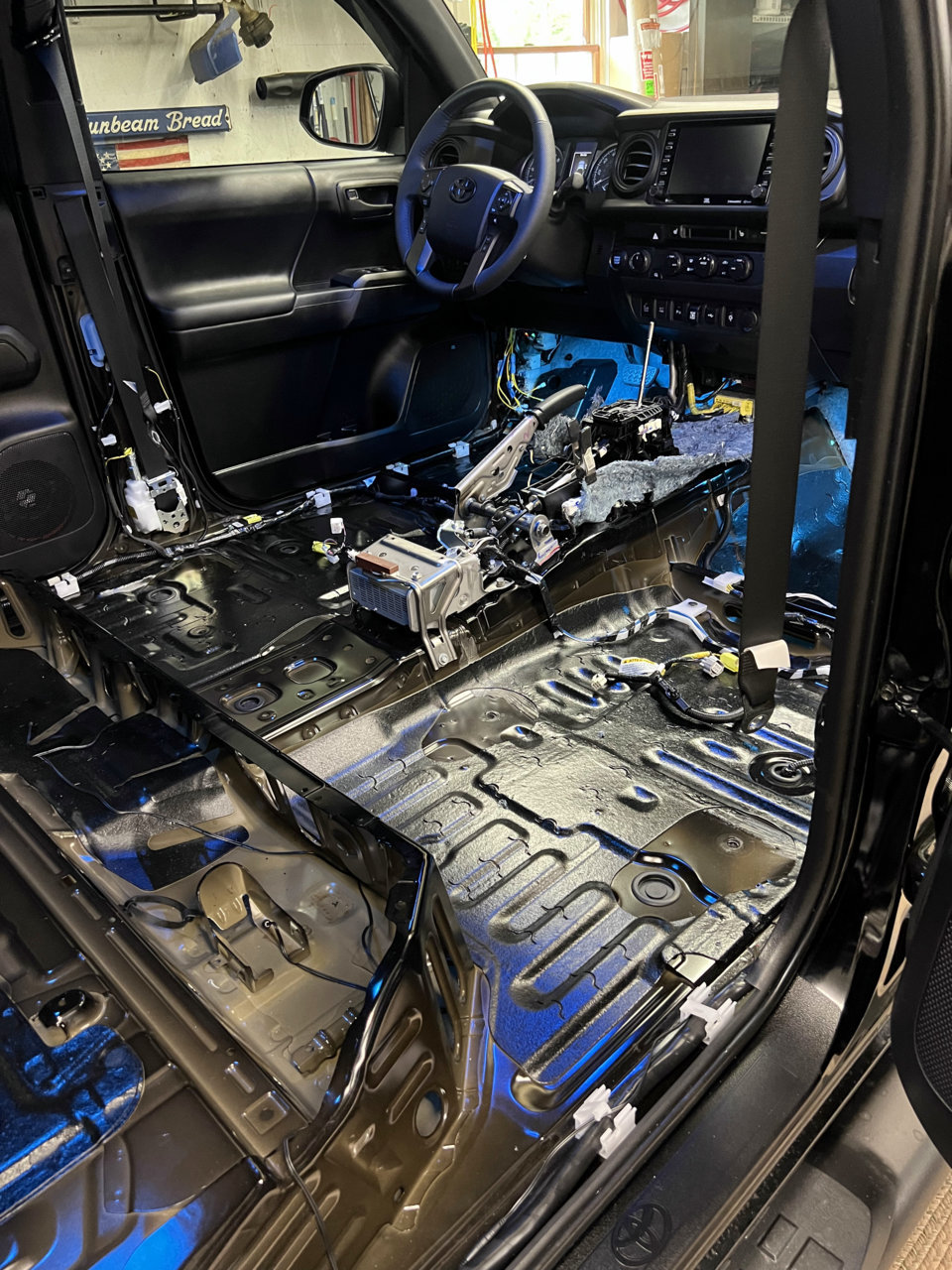

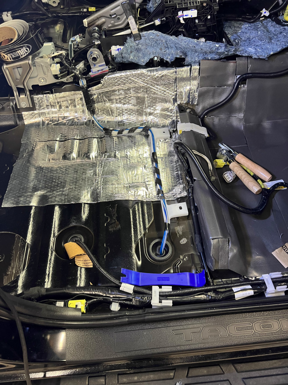

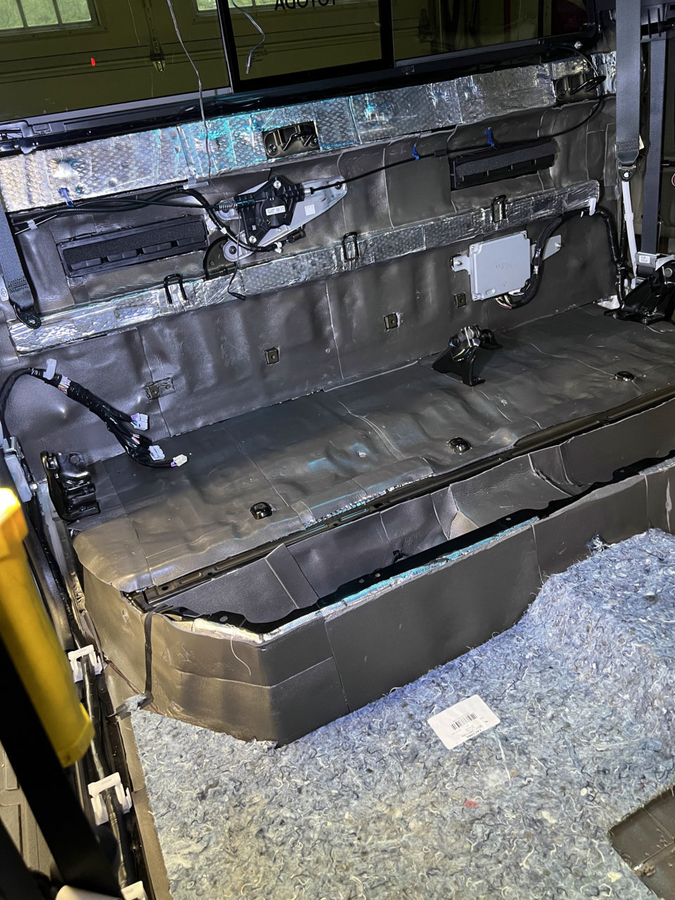

    Results: After a layer of Dynamat Xtreme and 1/2 inch Dynaliner, this thing is QUIET. Took about 12 hours over 4 days. I'm rolling on 35x12.5's and it's still much, much quieter than stock. OEM JBL's sound nice as well. Worth your time if you have a long weekend to get it done!
    It was difficult to get some of the plastics back in with the added thickness, but it worked out.
