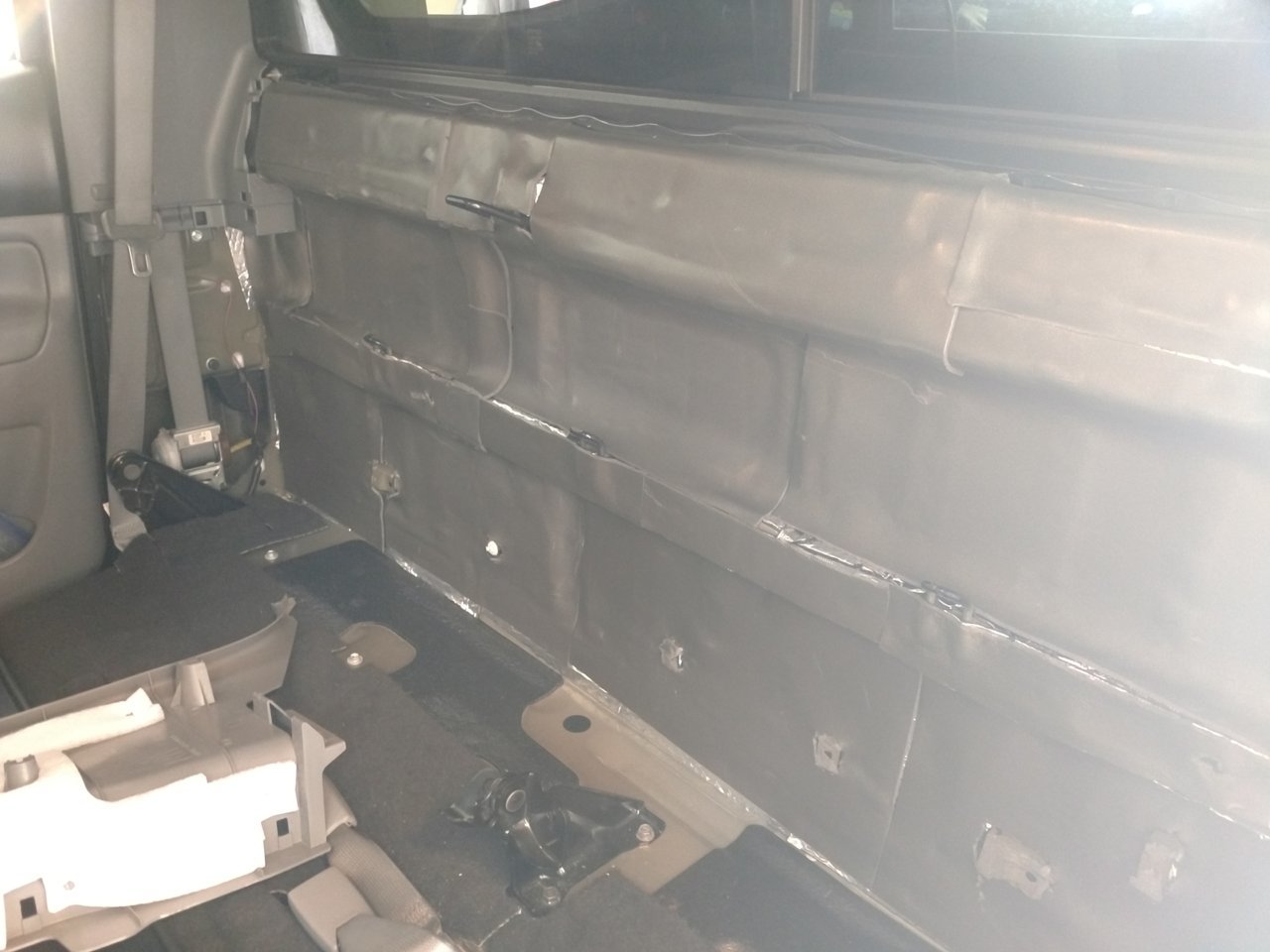

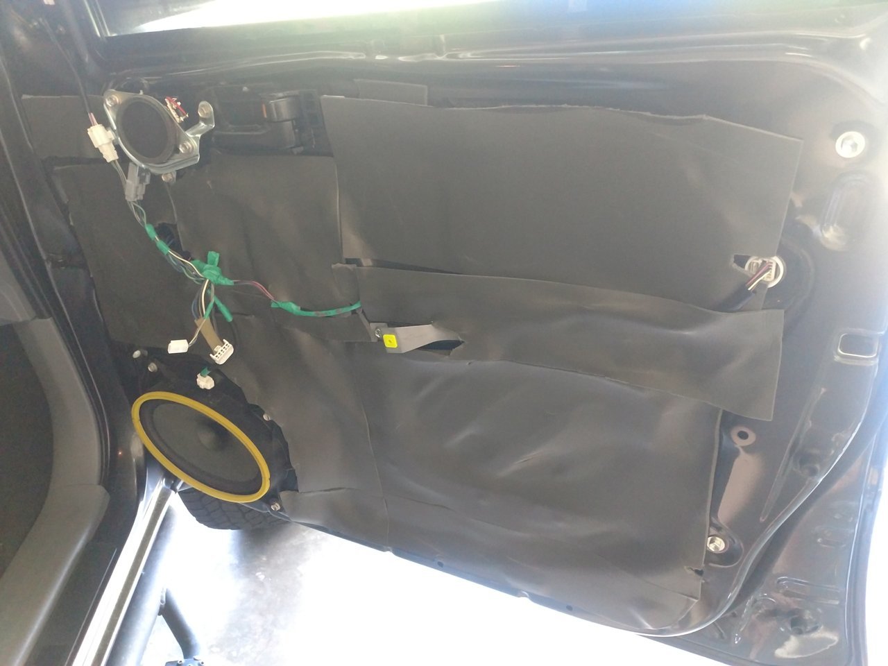

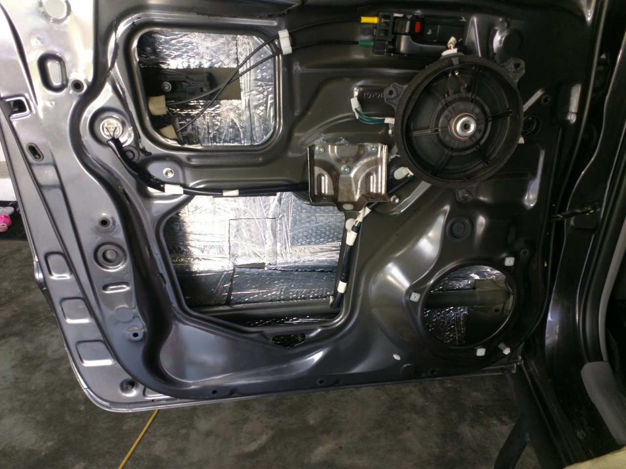

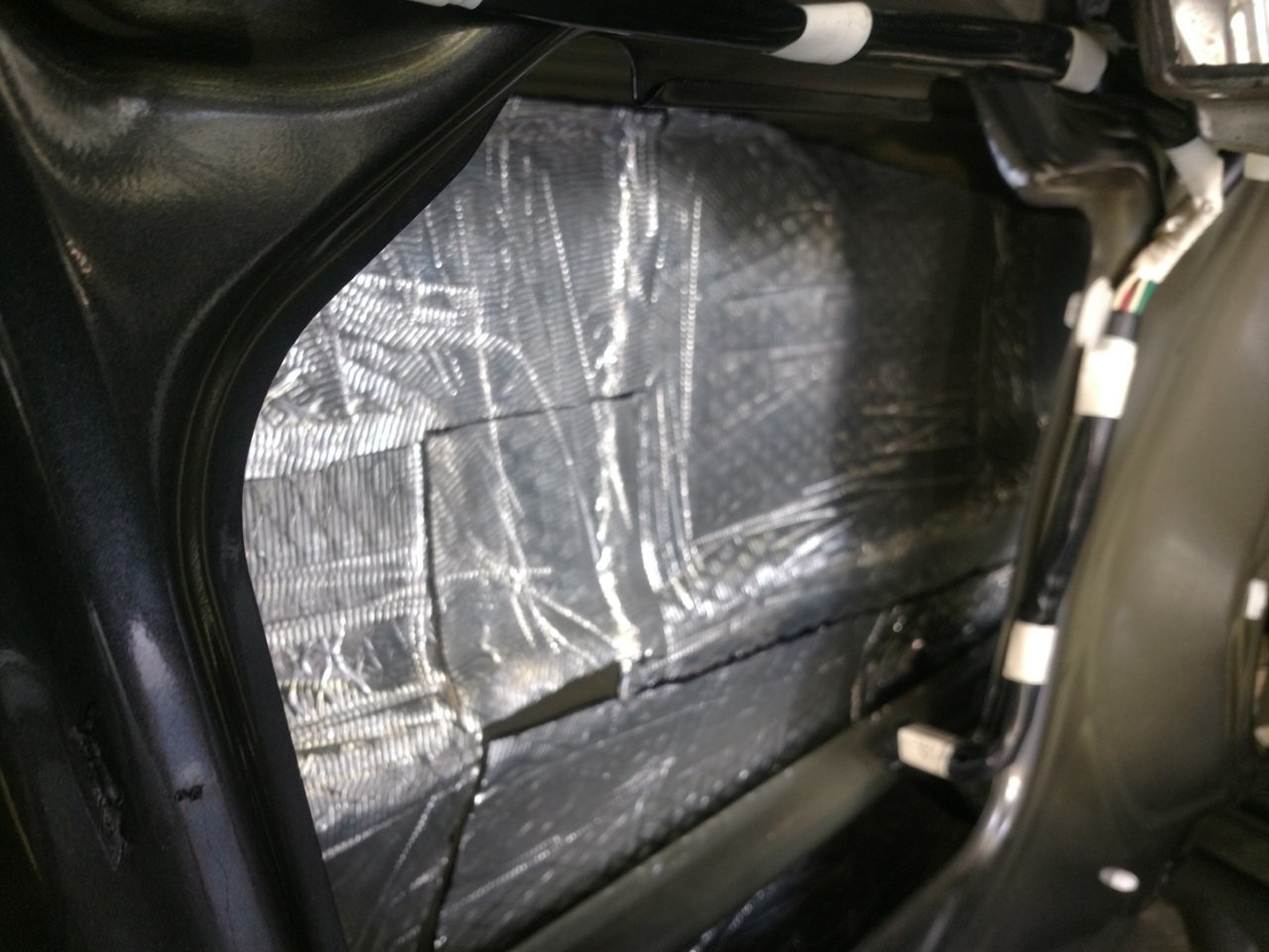

    I just finished the four doors and rear wall. I used NOICO 80mil and topped it off with 150mil red. I used 36 square feet.
    I blocked off as close to 100 percent as I could. My goal was keeping the truck cool.
    I didn't think much about the rear vent things.

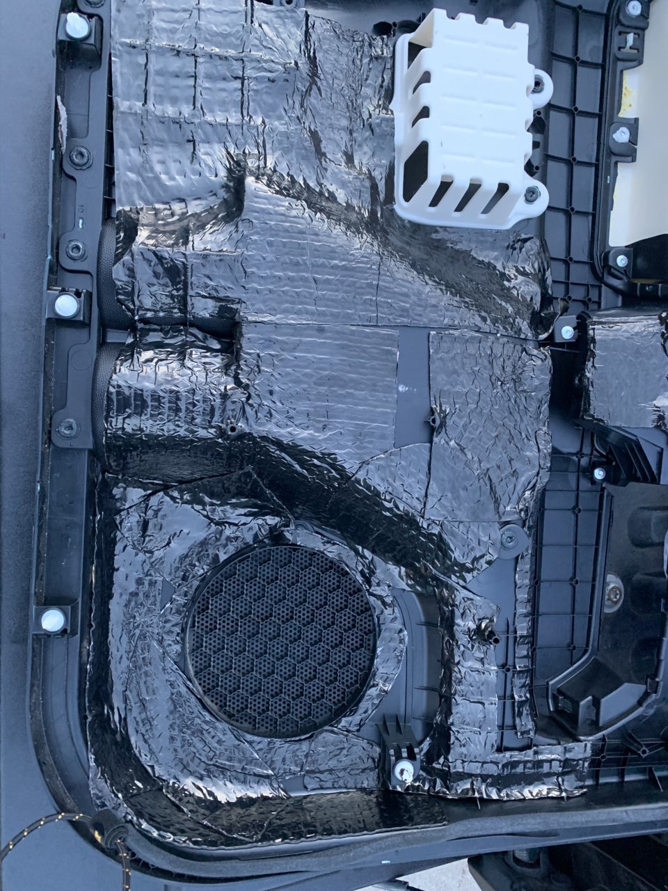

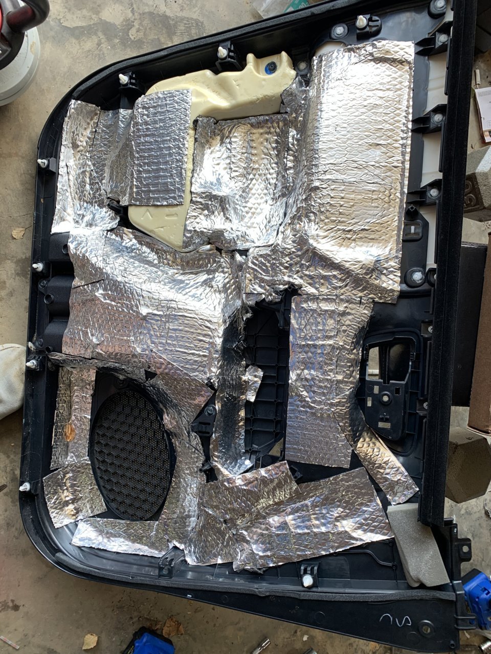

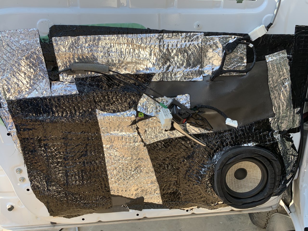

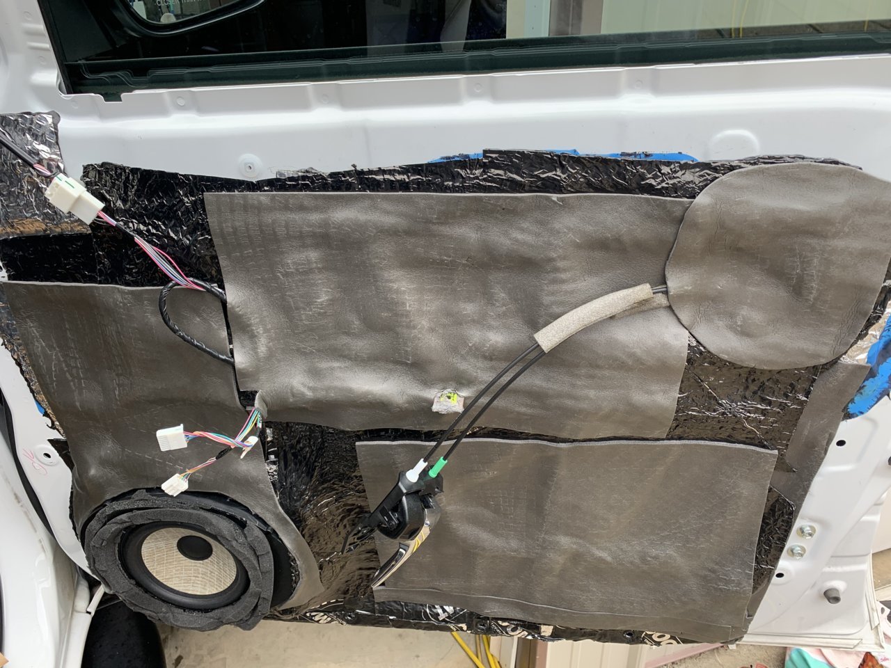

    3783287B-CB18-4D11-993C-18AF243D8253.jpg 744ED0E7-660E-4676-BEC6-AA9FE28531E7.jpg E18A2BD2-76AE-4979-950D-097AA39DBA92.jpg 1619D772-B2CF-4039-BCCF-86123FC4CE7E.jpg
    here is how I did my doors. I didn’t take any pics of floor or insides of door panels but they’re done too
