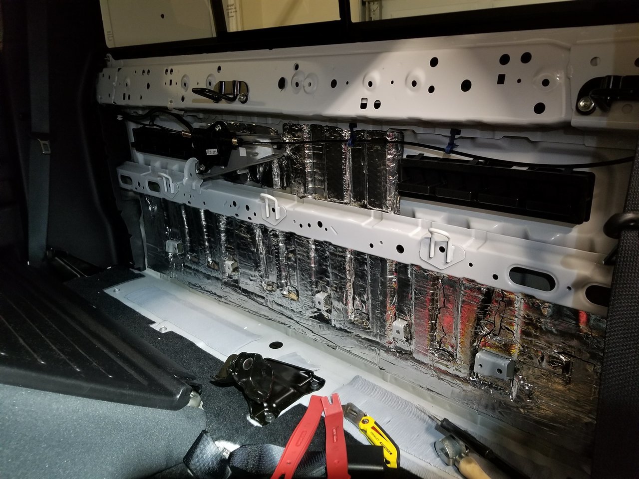

    Well I can probably win the award for worst deadening install ever :eek:
    There's a bunch of gaps where the foil split. Not sure if I need to cover those with more deadening or tape or leave it bare.
    Next step will be the 1/8" MLV/300mil foam combo. I'll use the factory carpet thing that was covering the area as a template to cut the combo. I'm assuming the combo is much better than the carpet thing so I'll probably just leave it off.

    wow, that's a seriously thin constraining layer. What brand of damper is that?

    Doesn't matter if the foil splits, the butyl underneath is what controls the dampening; for the dampening you really only need ~25 percent coverage anyway so you are more than covered. Caulk with silicone around those vents while you are at it, the vents are loosely held in there and vibrate
    So yes, "The constraining layer matters," but like I said, you only really need 25 percent coverage anyway so the tears, wherever they are, really don't matter

    The constraining layer definitely matters. But if it's thin foil it might not make that much difference anyway.

    Constrained layer damping (CLD) is recognized as an effective means for damping out the resonant vibrations
    and noise radiations of thin-walled structures [1]. The vibratory energy is dissipated due to shear strains in the viscoealstic
    layer of CLD patch. When the base structure vibrates in bending, the stiff constraining layer will force
    the viscoelastic materials (VEMs) to deform in shear due to the differences between the displacements of the base
    structure and the constraining layer, resulting in conversion of structural vibration energy into heat. The CLD treatments
    provide considerably more damping effect than the unconstrained ones in spite of adding extra weight of the
    constraining layer
    Source: Topology Optimization of Passive Constrained Layer Damping with Partial Coverage on Plate

    Are those two actuators for the rear window? I'm curious if unbolting them and putting material behind them would interfere, but I guess I'll decide when I get there. You might want to put some strips on the top and bottom if that cross bar. Remember it's a learning experience, have fun. You used the Noico 80 mil right?

    Yes, as low as 25% strategically-placed coverage with a good damper seems to be a good rule. If the 'constrained layer' is foil however, we probably can't call that a good damper. An effective CLD needs a semi-rigid constrained layer. Foil is not rigid enough. A stiff layer will not tear like that.

    You installed directory on top of all the wires and misc cabling? Did the panels go back on easily enough?
