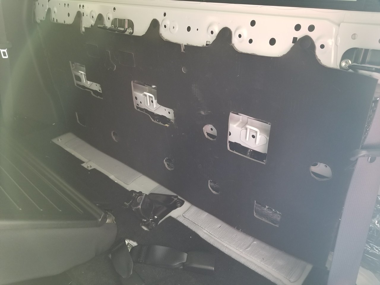

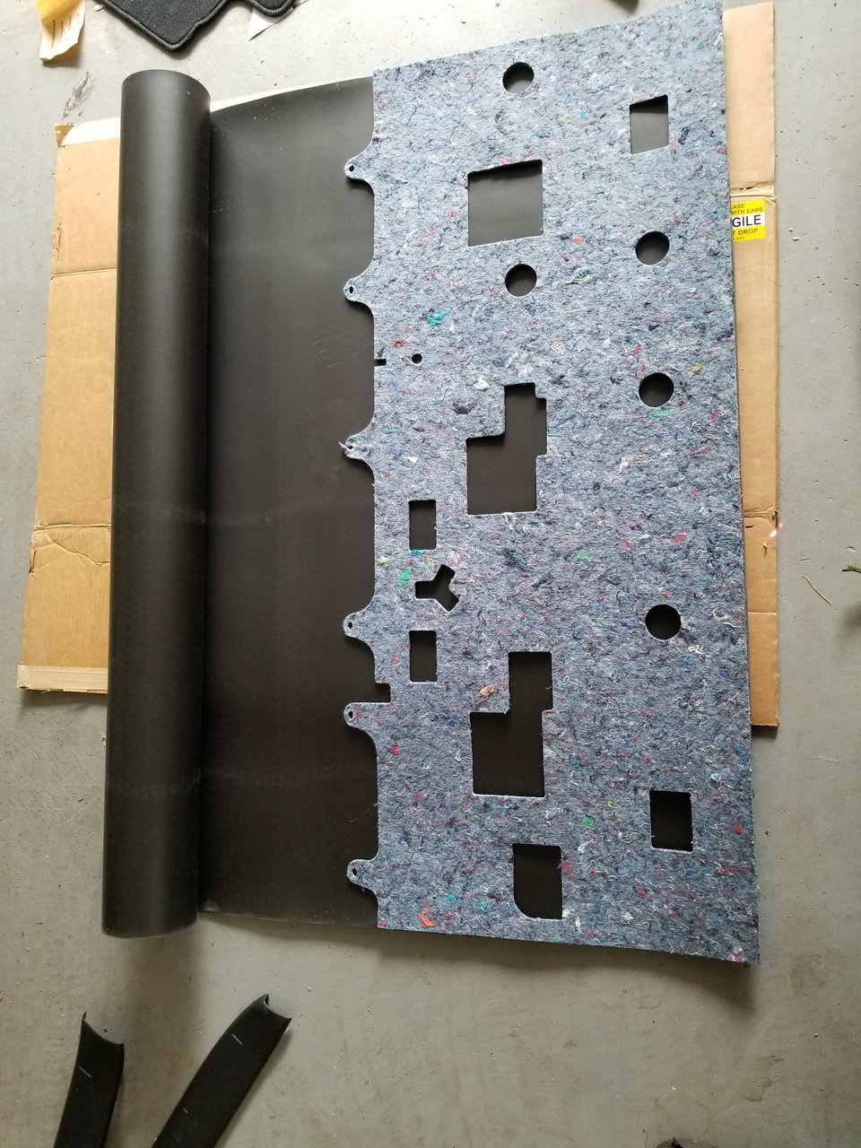

    Thanks for the responses. I won't worry about the CLD tears then. It's Noico 80mil.
    Yes, the actuator is for the rear window.
    Here's how I did the MLV and 300mil foam. I copied the stock carpet thing so the holes are way oversized which reduces some effectiveness. I'll probably patch it up at some point.
    The Noico foam is insanely sticky. It's adhered to the other side.

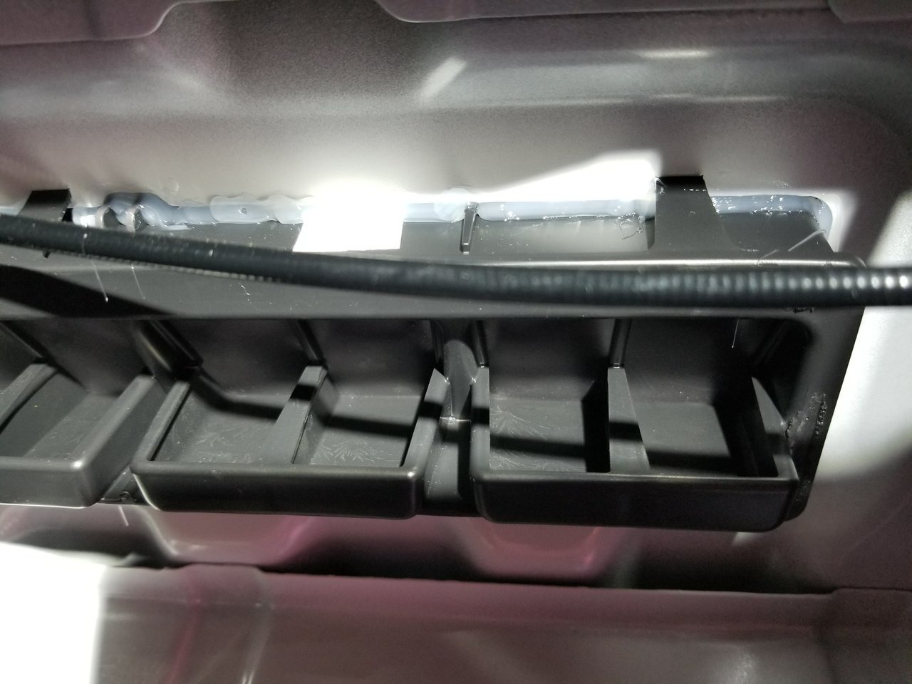

    I also caulked the vents as suggested:

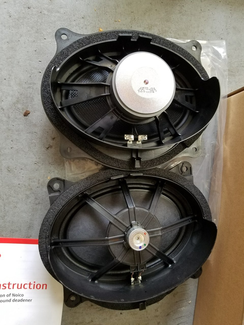

    It's amazing how small the magnets are on the stock speakers and how light they are. Here are the fronts compared to the OEM+ speakers:
