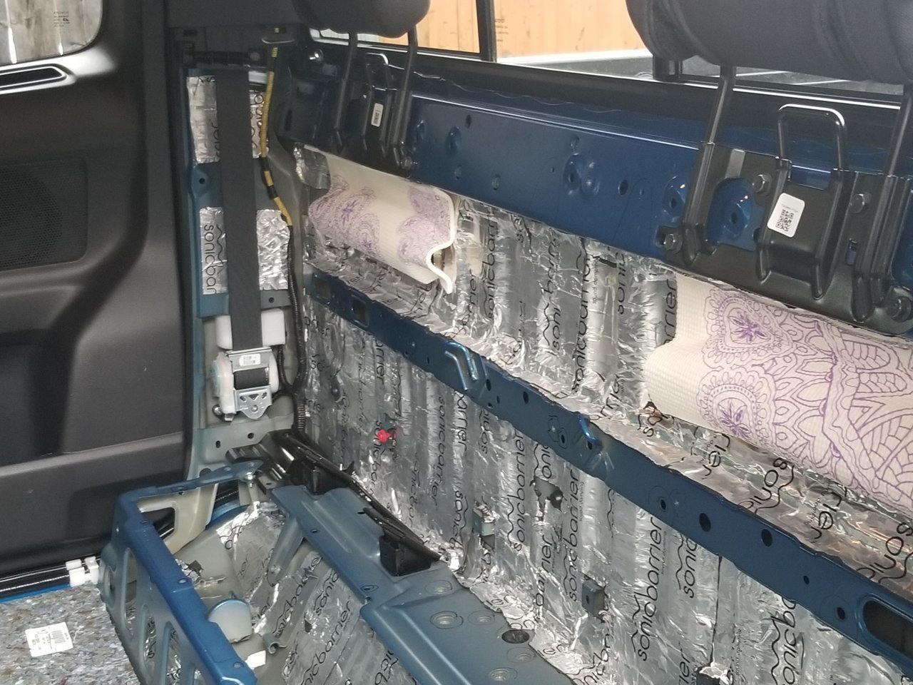

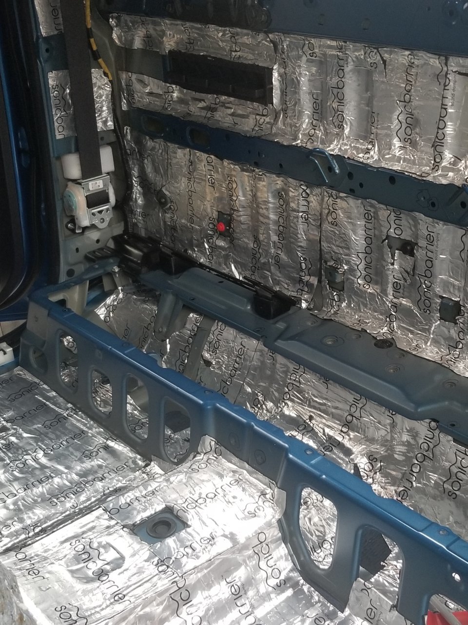

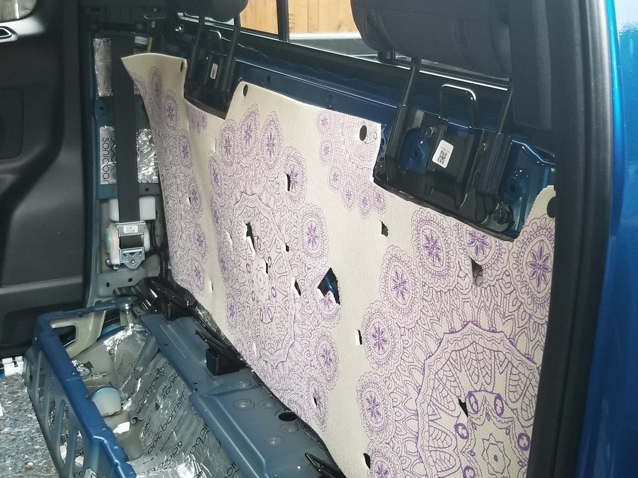

    Hey Guys,
    I used Parts Express Sonic Barrier in my taco, and Noico 80 mil in my Runner. The sonic is a little bit heavier and feels beeter, but it lacks the raised diamonds used to know if you rolled it on hard enough that are found on the Noico. Sonic wins because the 50' rolls are cheap.
    Yoga mats from 5 Below are $5.00, and work great!
    MLV went on top...and she is quiet! I bought it with Amazon prime so it shipped free. Paid less than $200 for sonic barrier, yoga mats, and MLV, all in 50' quantities. I had 25' of extra Noico from my Runner that was used. I was able to do access cab floors, walls, and doors. No mlv or yoga mats on doors, just used Sonic Barrier. The mlv would be super hard to use on the doors, so i didnt bother, and its not needed.
