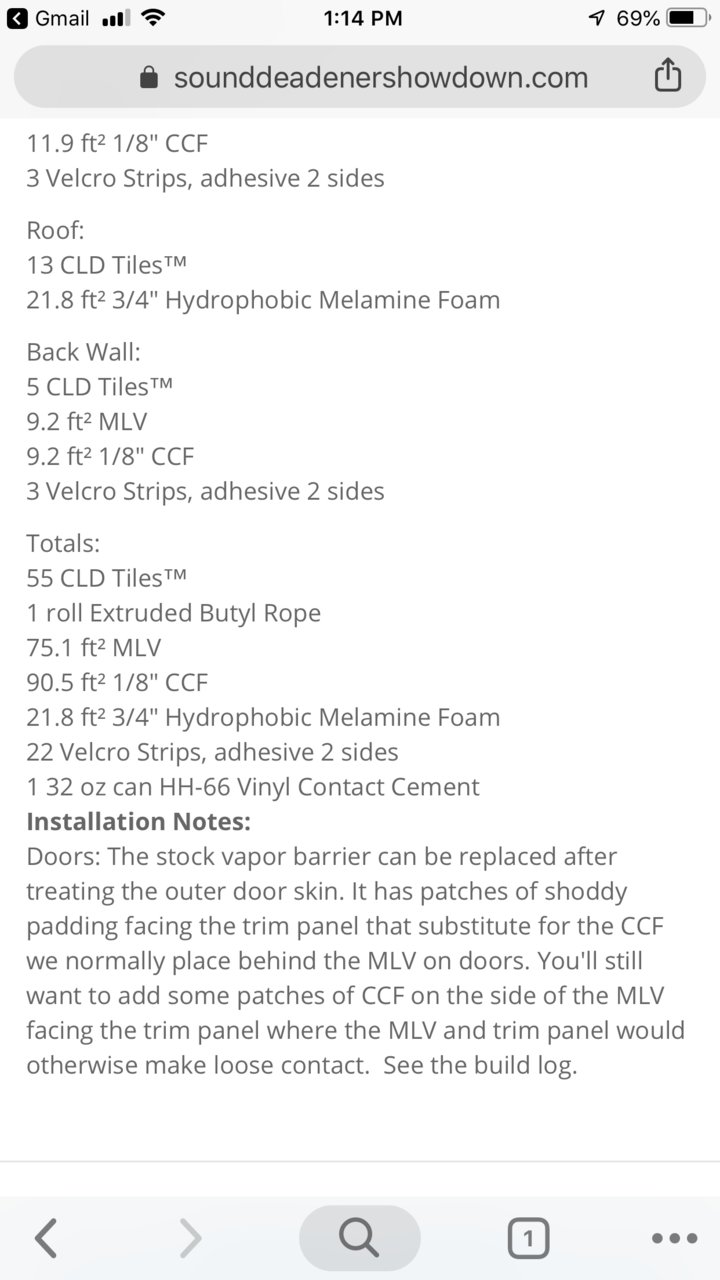

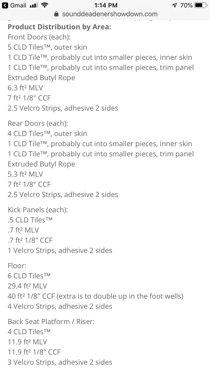

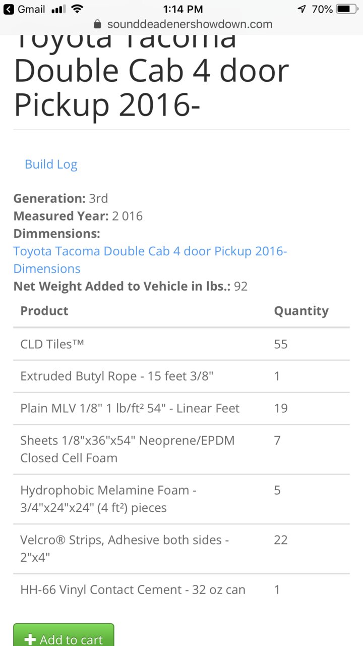

    Does anybody know how many sq/ft they used on the inside of a double cab? per door and floor/back wall?

    I'm mobile right now, but if you check out sound deadener showdown and choose the Tacoma DC package they add the approximate amount to your cart. Should be able to figure it out there.

    Yeah I looked there. Looks like he has 85.5 sq/ft of MLV... does that sound about right to you guys who have done it?
