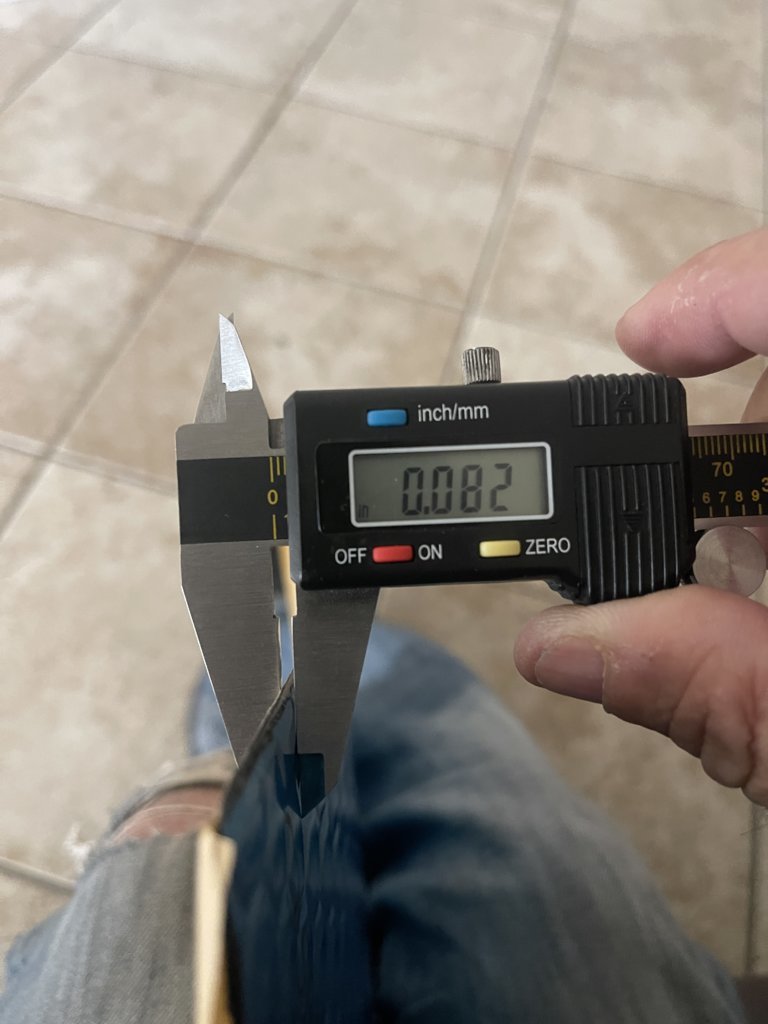

    This may be very educational / informative for you..
    Click on the tabs, resonance reduction % & cost comparison tabs...
    All the name brands listed, tested & how amp basic compares...
    https://resonixsoundsolutions.com/r...-deadening-material-independent-testing-data/
    Also a recent development in regards to the ams basics ive been recommending...
    My son has my calipers so after he gets up ill measure mine to verify 90mil...
    Pretty sure this is the owner of resonix making the video, apparently they went from 90mil to 70mil...
    https://www.youtube.com/watch?v=Dm_QM5ozByE&t=332s
  3. Dec 22, 2024 at 10:08 AM
    #23
    slater
    slater Well-Known Member
    Apr 16, 2024
    #448066
    2,799
    San Diego
    24 white Tacoma TRD Sport 2wd

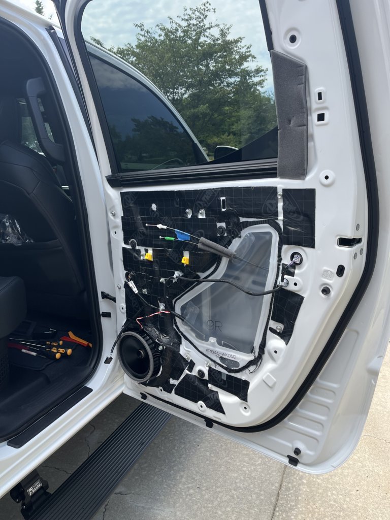

    Mine bought in April…

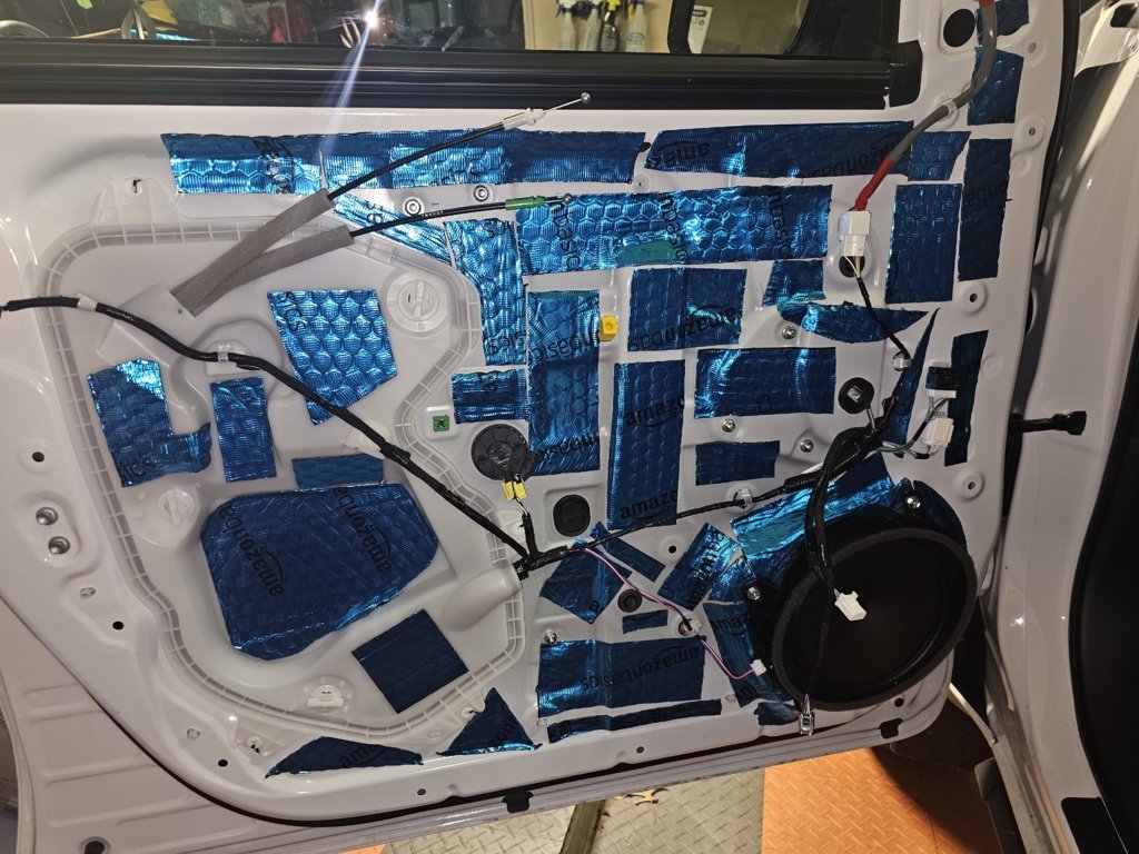

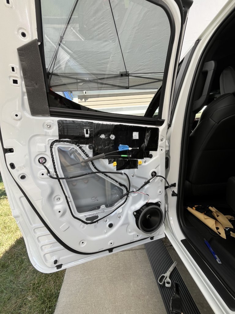

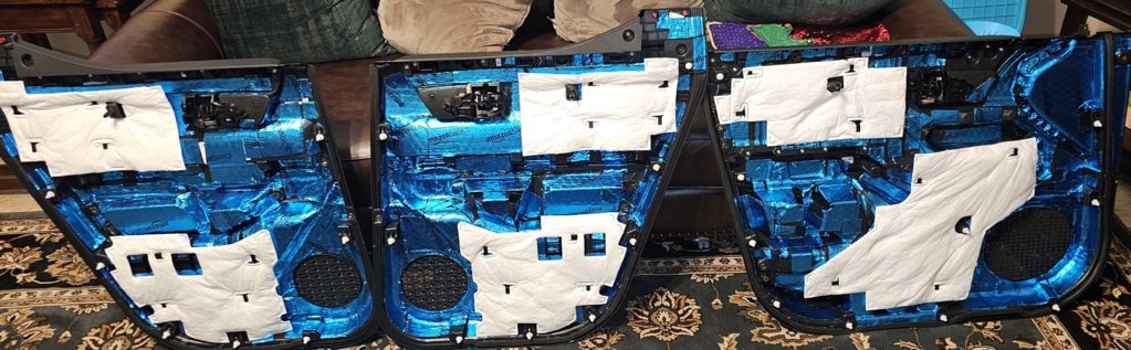

    I ended up sound deadening all 4 doors. What prompted me to do this was a slight rattle in the passenger front door when playing music. Plus I have the hybrid so I can hear everything lol. No more rattling and it’s really quiet now. I plan on upgrading the factory JBL speakers at some point. Overall it was easy and I recommend it. These are the only pics I have.

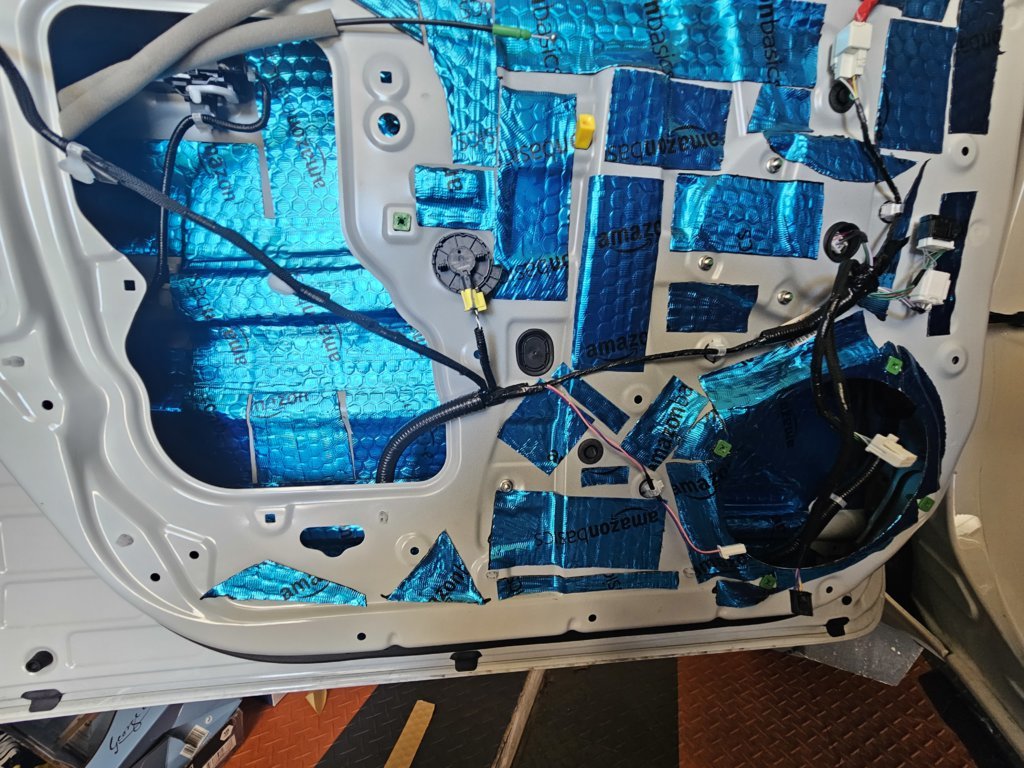

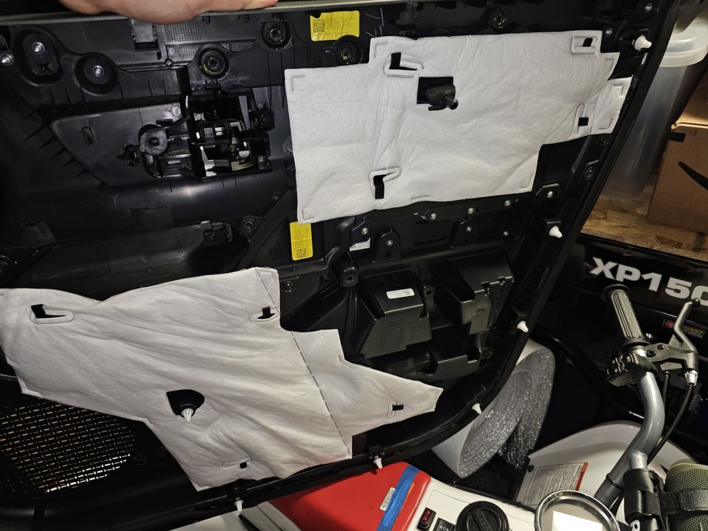

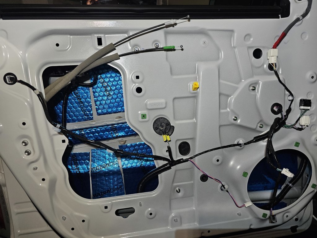

    20241227_215044.jpg 20241228_013645.jpg 20241227_233724.jpg I started doing my sound deadening on front driver door. I did the outer skin and the inner skin. However, the door panel has this white material on it. What do I so with that? Just remove it and sound deaden behind there and then reinstall it? It is getting late here. I figured I would have some opinions before I continue tomorrow. Let me know your thoughts. 1sr picyure question: Is it necessary to put sound dampening on the the cross member in the middle of the door? If yes, I can put a couple of long strips.

    Yes, as you stated, quickly remove the felt, install some matting on the larger flat areas of the panels, curved areas around the speaker grill, etc...
    Dont need to go crazy,
    Also, directly behind the speaker in your first door, there's a small square metal pad with the round metal brace wended to it, slap a piece of matting directly on the square metal pad...
    That's an important area not to miss since its directly behind the speaker...
    Use alcohol & wipe everything down before applying the matting...
    Not sure how important that is since its a new truck, but we only want to do this once....
    majority of the outer door skins you can install the matting in whole sheets, worse case scenario only cut them in half lengthwise....
    There's plenty of room to enter through the vapor barrier area & keep the sheets large...

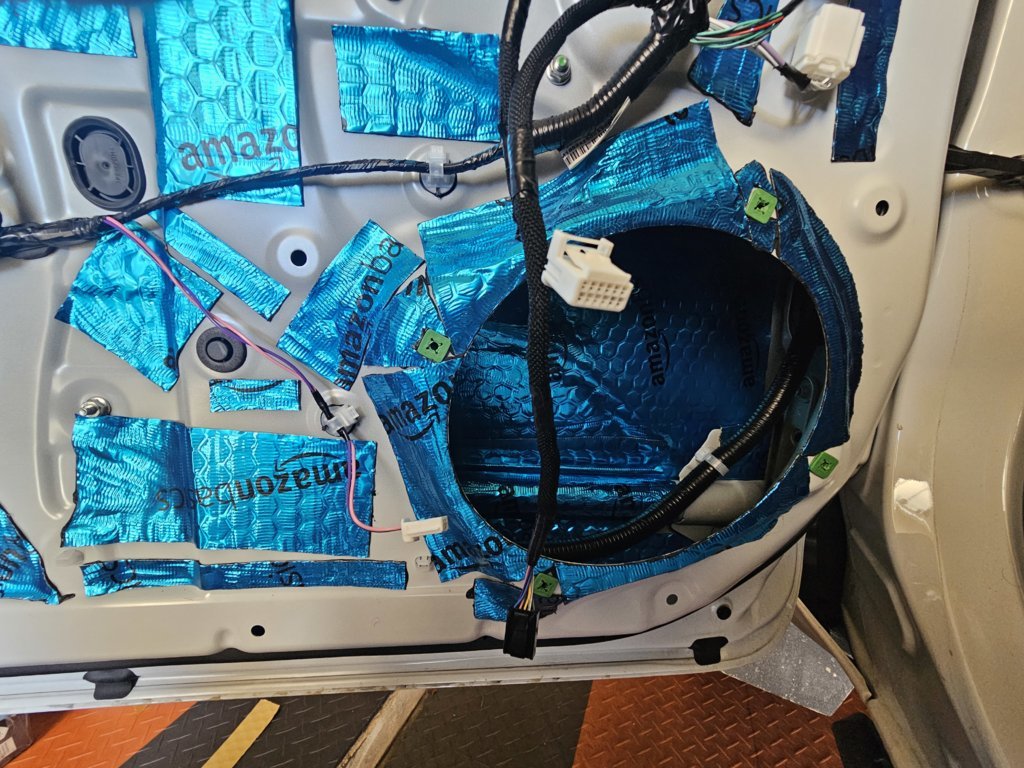

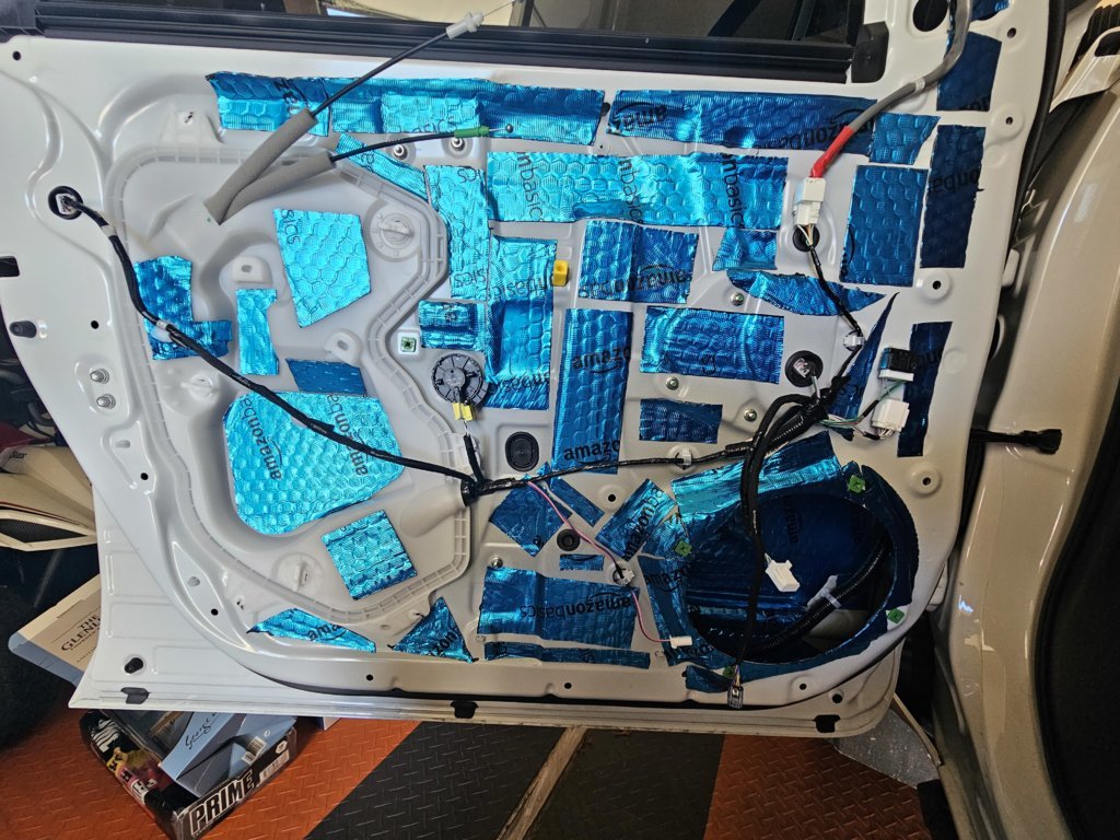

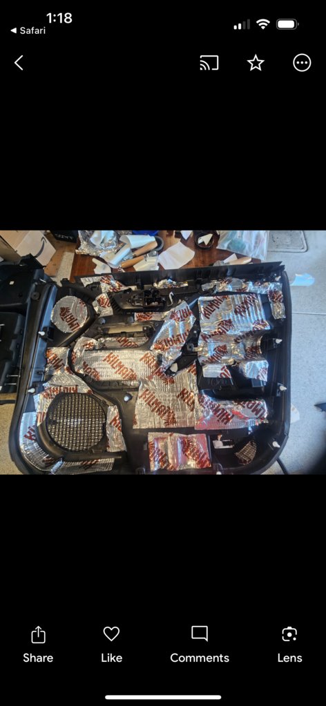

    20241228_135332.jpg 20241228_135908.jpg 20241228_135324.jpg 20241228_125209.jpg 20241228_140313.jpg
    Ok great information. Driver door done. I went thru a lot of material. It is as good as I can do. It sounds more beefy and not like a tin can when knock on it. Updated photos

    Looks like you put in the work...

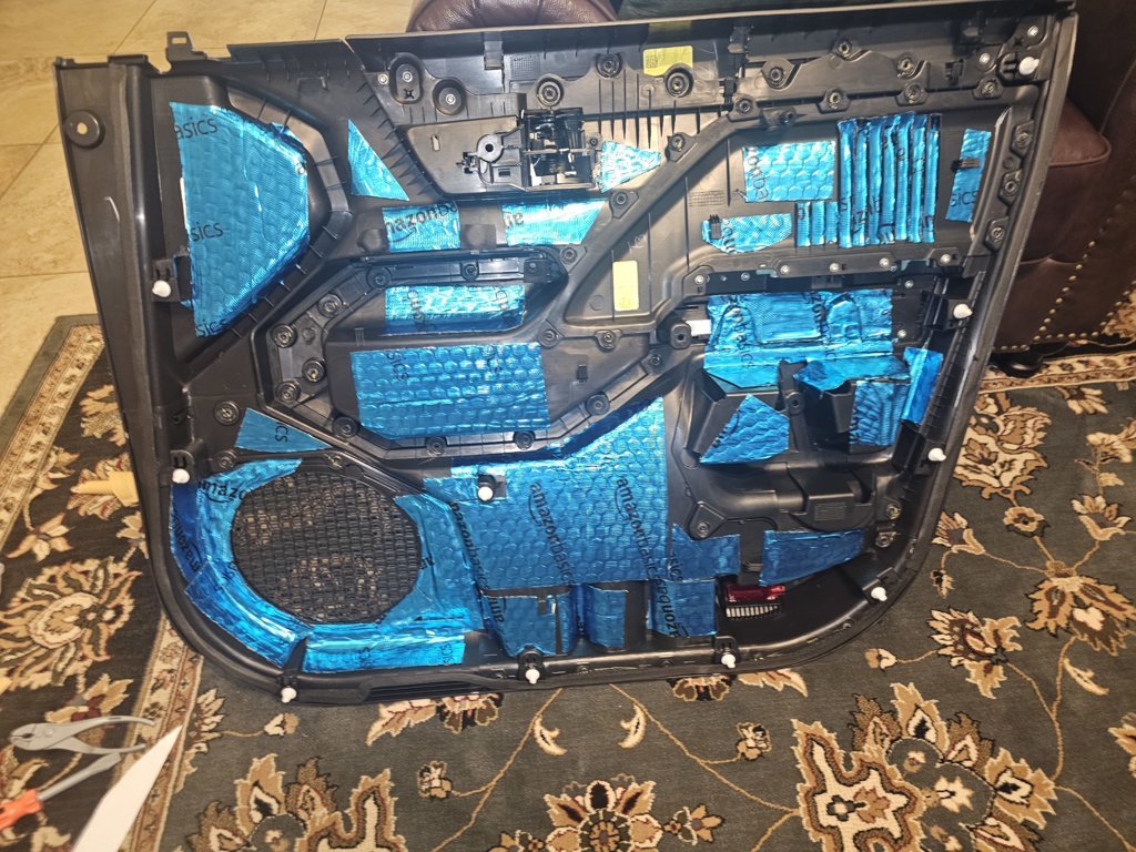

    While I wait on adapters and speakers, I have done some sound deadening on the door panels. Very time consuming so far,and I am not done but I figured if it is worth doing, then it is work doing it right.
