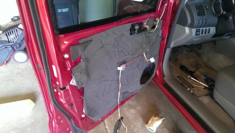

    few pics of my shitty job.
    Biscuits likes this.
