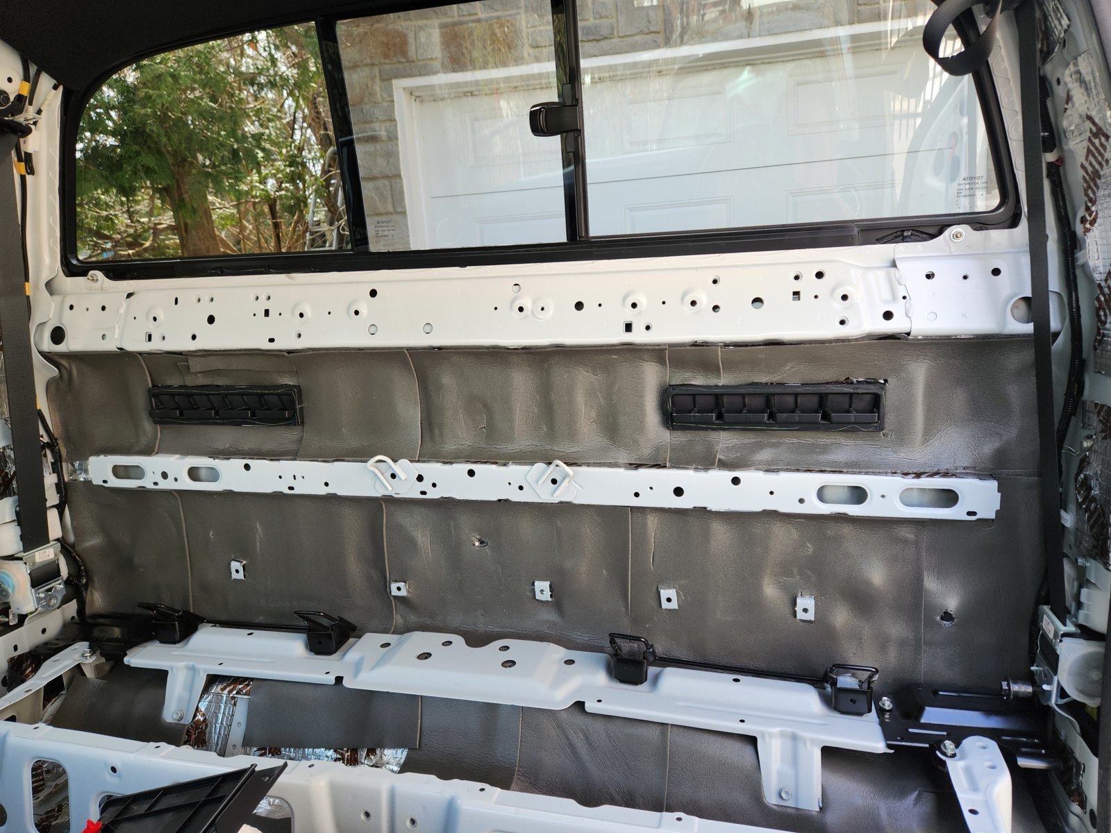

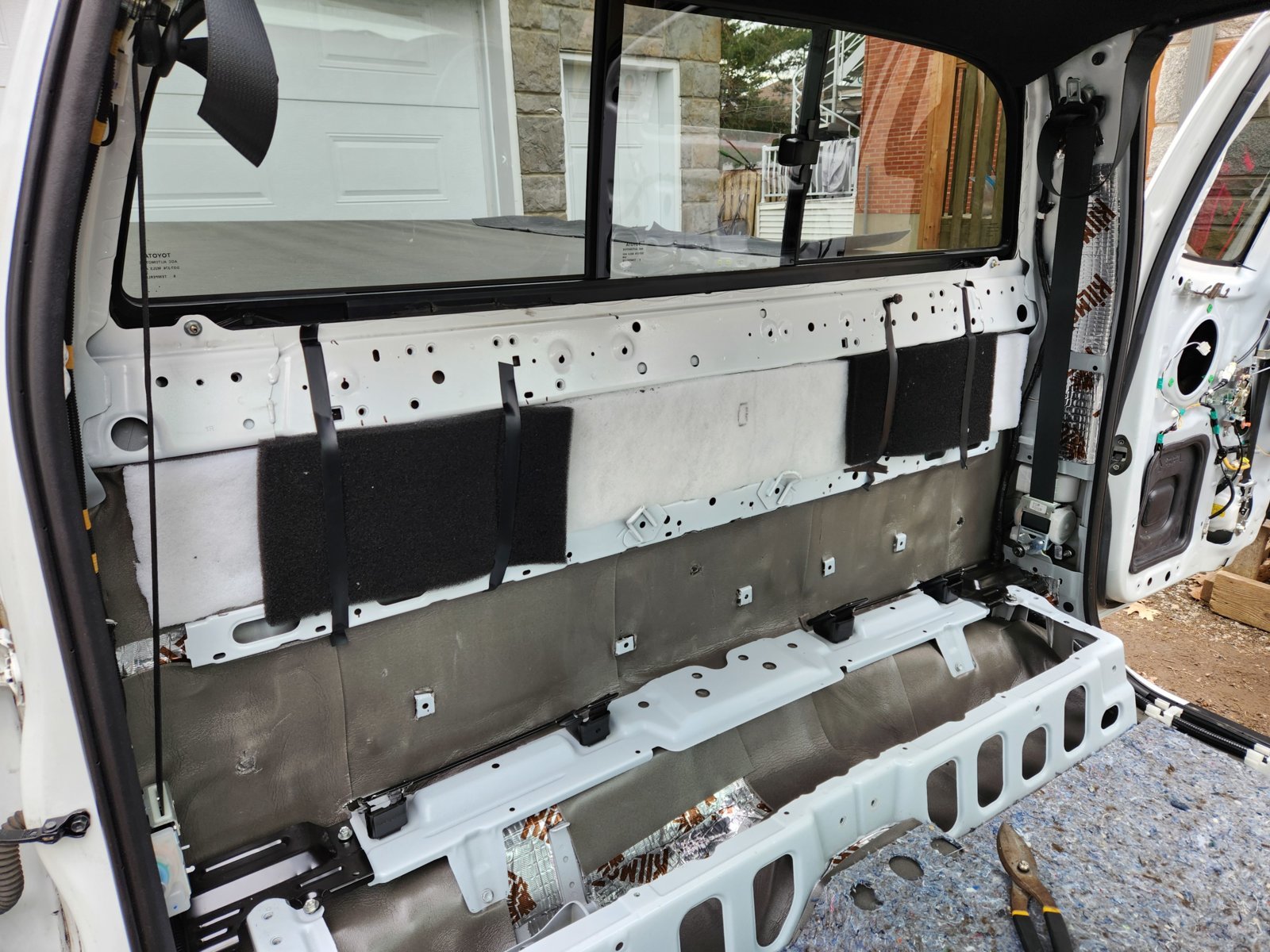

    I used killmat on the all of the truck interior, I then put a layer of closed cell foam with an adhesive on one side. The plan was for MLV all over the truck but so far I have yet to figure out what strategy I will use on the aft doors. (Access Cab)

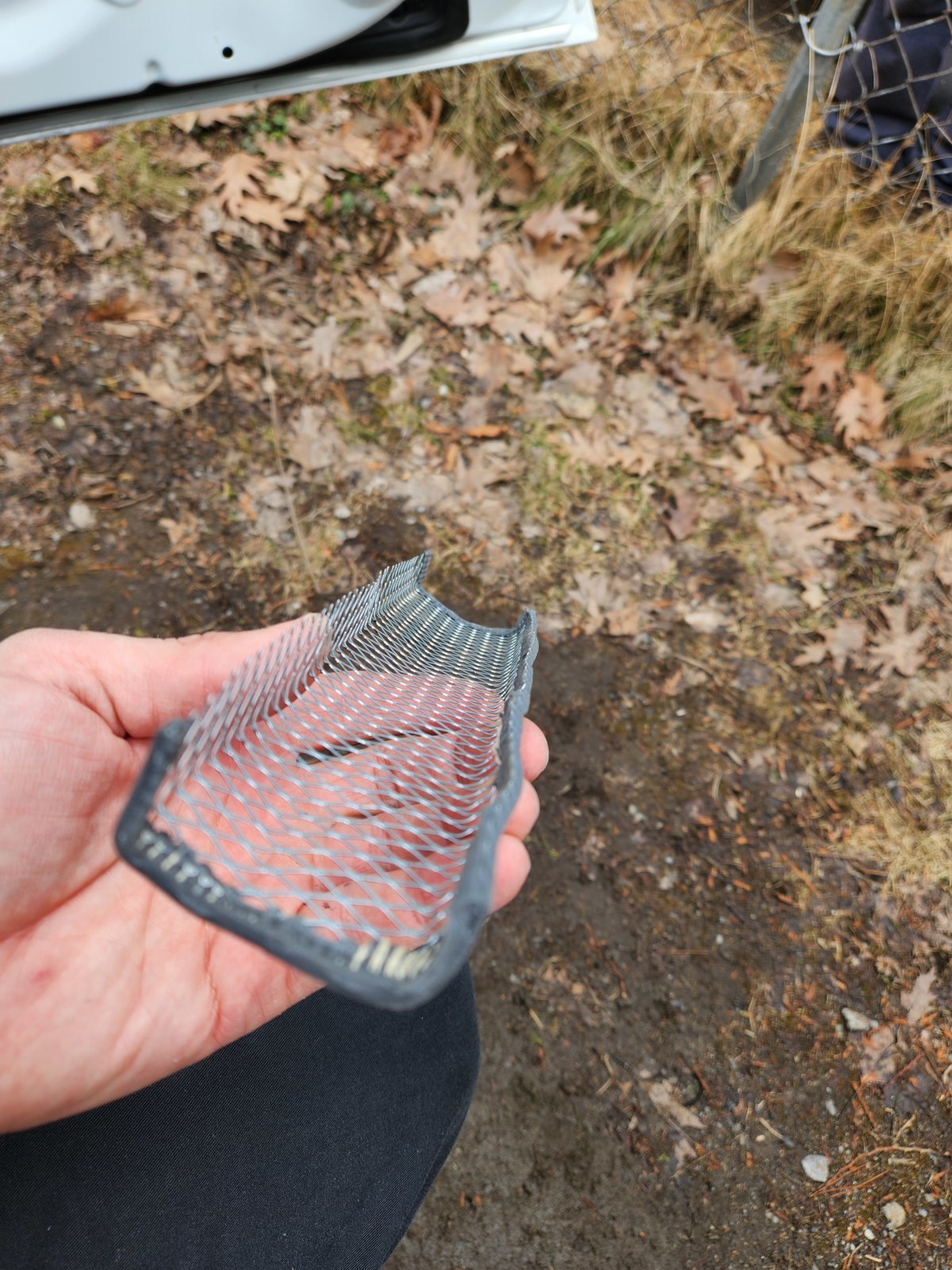

    I then constructed a guard grill for the 2 aft vents using the mesh material from an old air filter. This is to prevent any foreign object from going inside the vents and getting stuck. I then put 2 layers of air filter foam over the vents as well as in between the upper and lower channels on the aft wall. This is to dampen the sound and still allow air out. I then used 1/8 mass loaded vinyl to replicate the blanket on the aft wall. I don't have a picture of my blanket installation.
    Be aware that reassembly is long and painful when you add any thickness behind the interior panels. I originally made a MLV panel to go over the vents but I couldn't get the panels to clip in due to the added benefit thickness off the material.
    I have yet to drive the truck since I am still reassembling and doing other mods but I will comment further once done. I did take a sound reading prior to adding all the sound deadening and soundproofing material so should be able to provide a before and after reference.

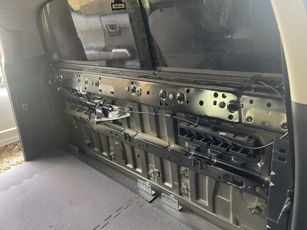

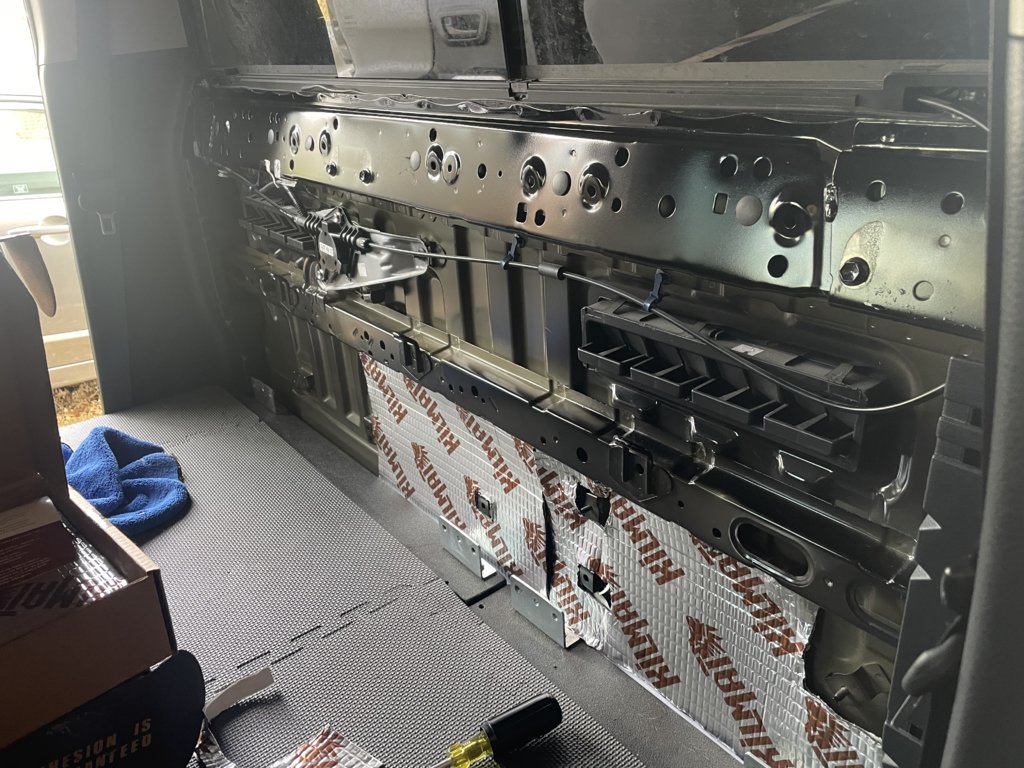

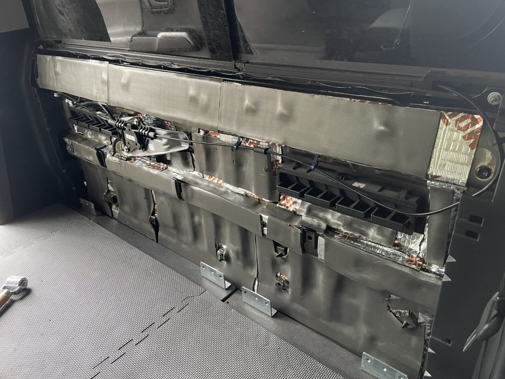

    I’m dealing with this issue now. I have a rear goose gear seat delete and today I did Kilmat and Siless foam pads on the entire rear wall:
    I ditched that carpet like flap that was held up with plastic clips. I was all excited after I re-installed the goose gear back wall, went for a drive and I swear the cab is louder than before all the sound deadening material. Anyone have any advice? Do I need to put that OEM carpet-y mat thing back on?
    It seems to me that the wind noise from the vents is far more noticeable now than it was before the sound deadening.
