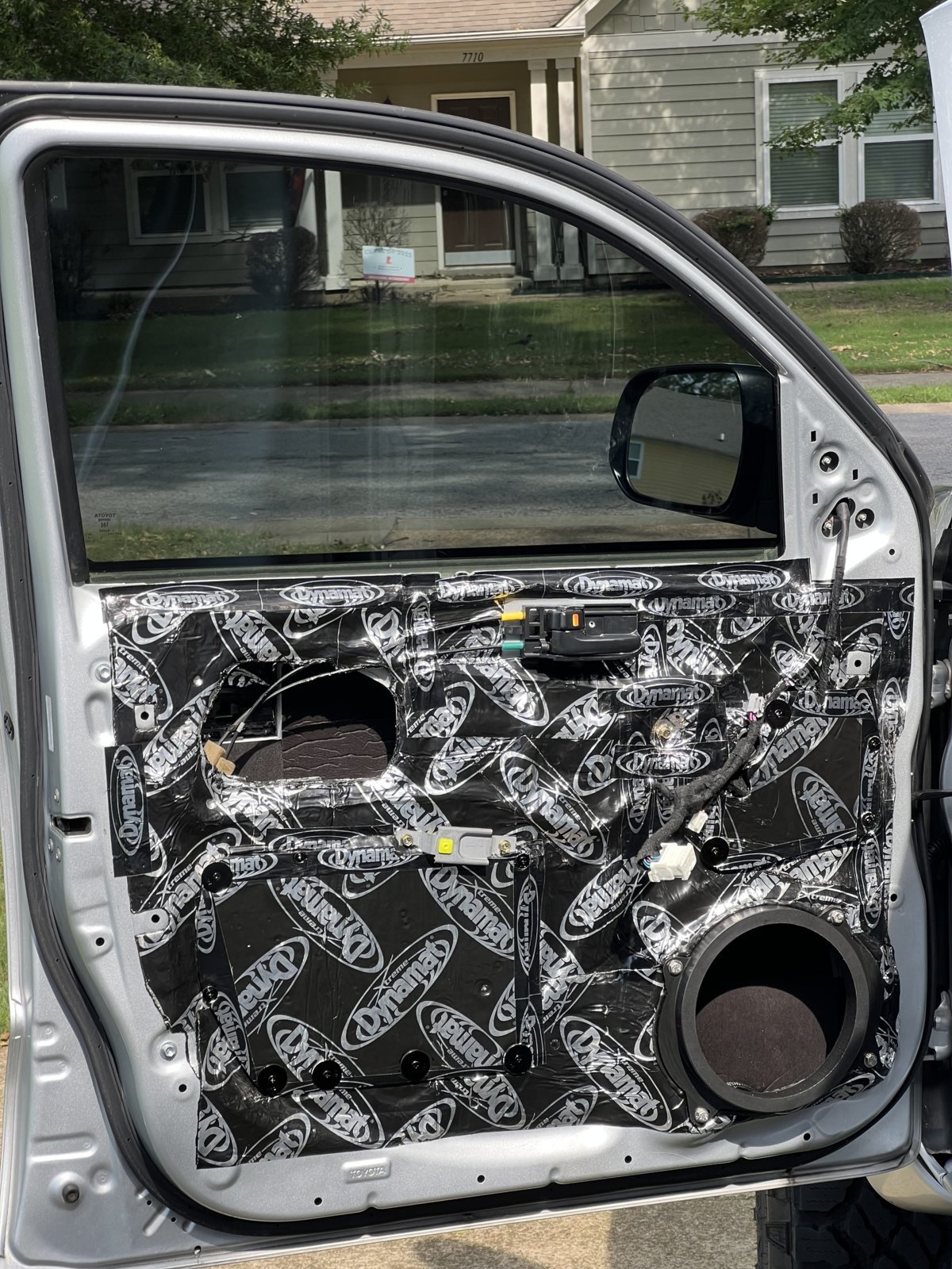

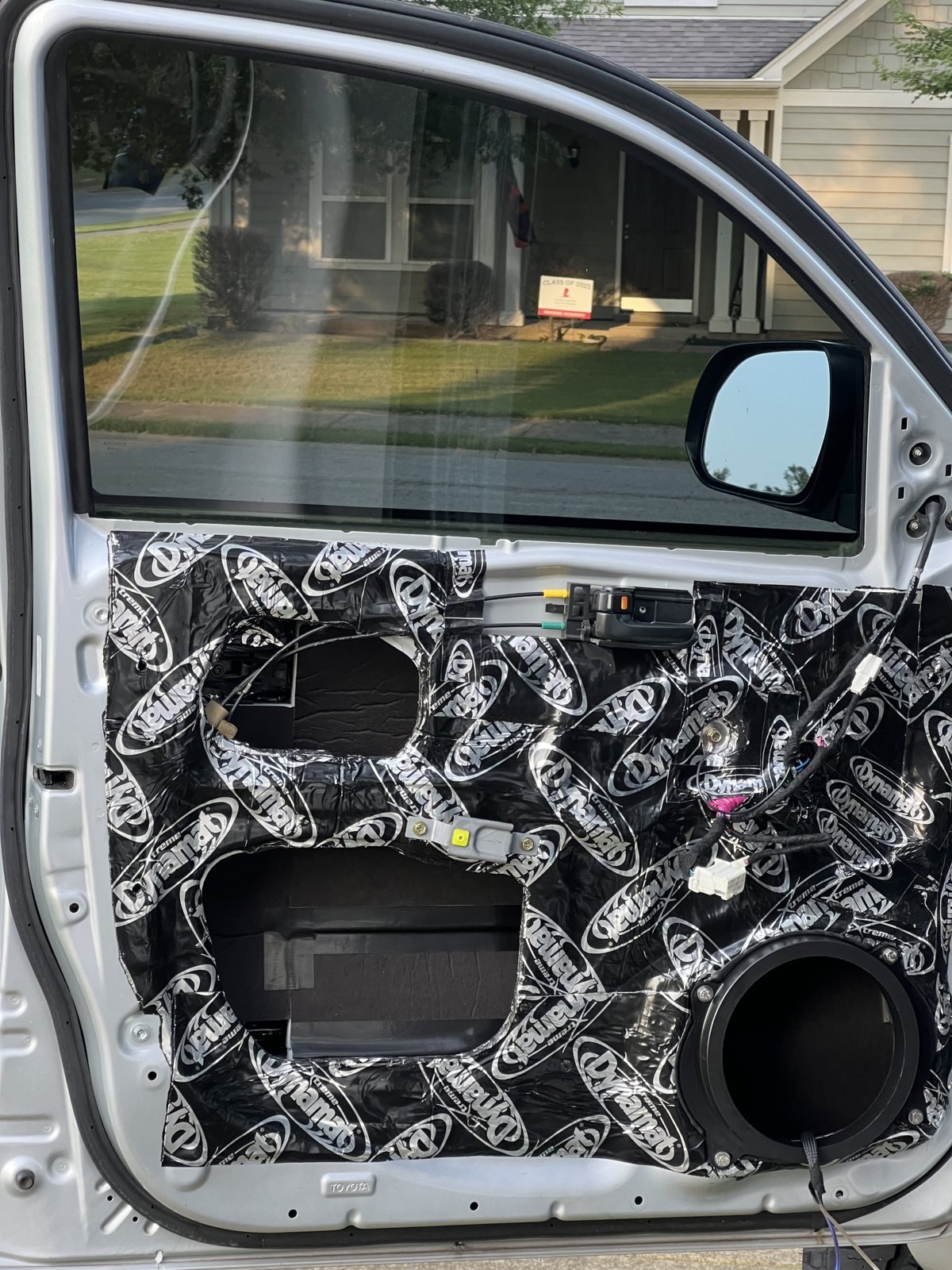

    I did second skin damplifier pro 2mm on the inside of the doors and back cab wall. That was plenty imo.

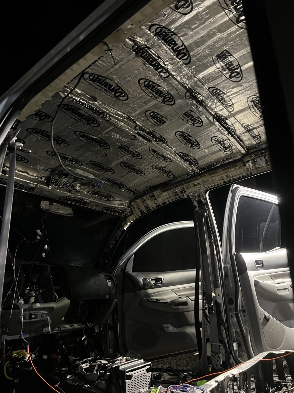

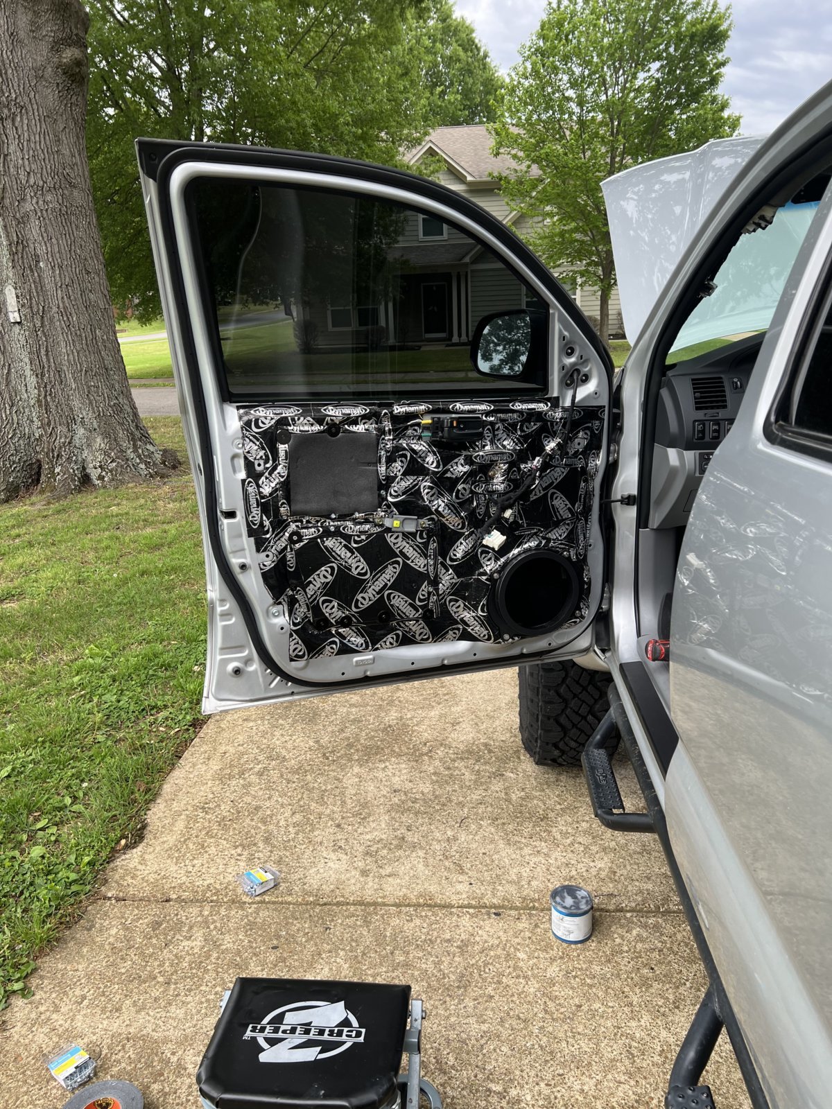

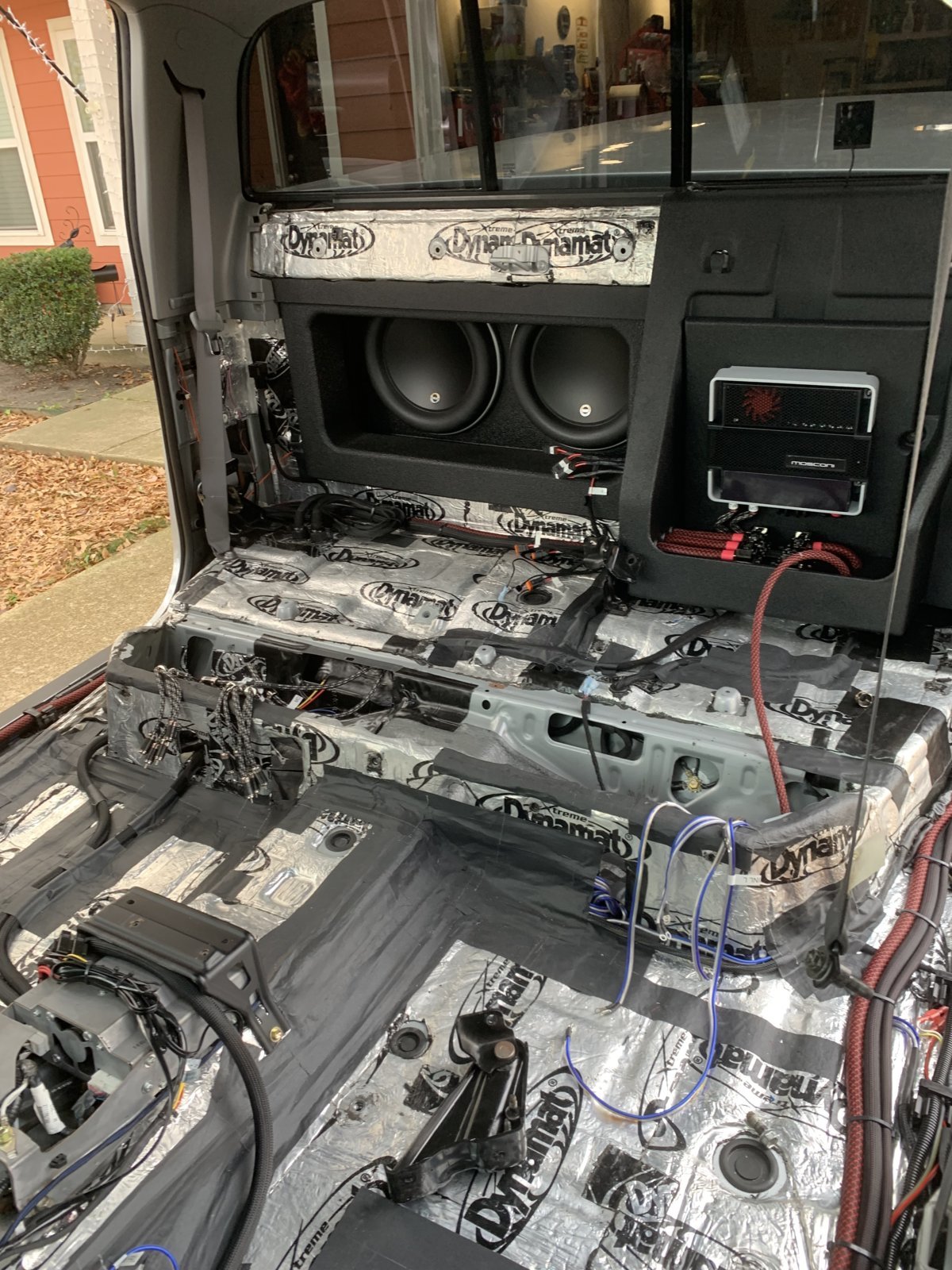

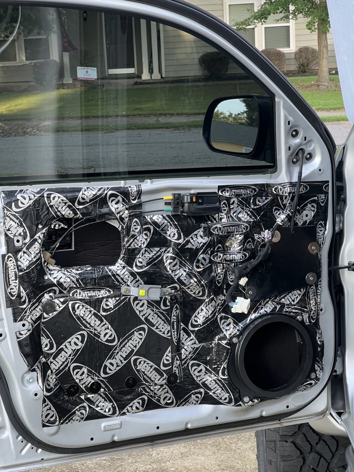

    I went with Dynamat Extreme for sound deadening and Dynaliner for thermal insulation throughout the entire interior. This was a huge project and needed to be broken up into multiple steps. You’ll definitely need to do the doors if you want the speakers in the doors to sound better, a lot of road noise come from the doors as well. I love the THUD sound when I close the door, feels like luxury.
    Jahjahsoljah and Rexfordian13 like this.

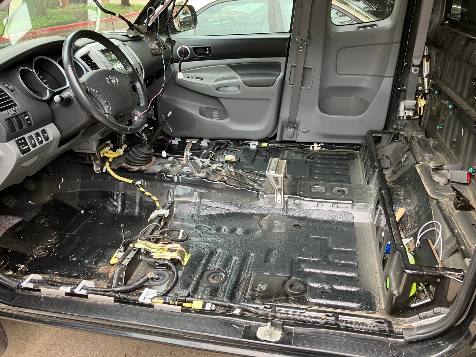

    I see there’s already some material on the floor pan from the factory. Does anyone know if the butyl rubber mats will stick to this material sufficiently?
    It kinda of seems like a pain to remove it all, and unnecessary unless it interferes with adhesion.

    The butyl mats are very sticky. They will stick on the original structure without removing the original minimal sound dampening material.

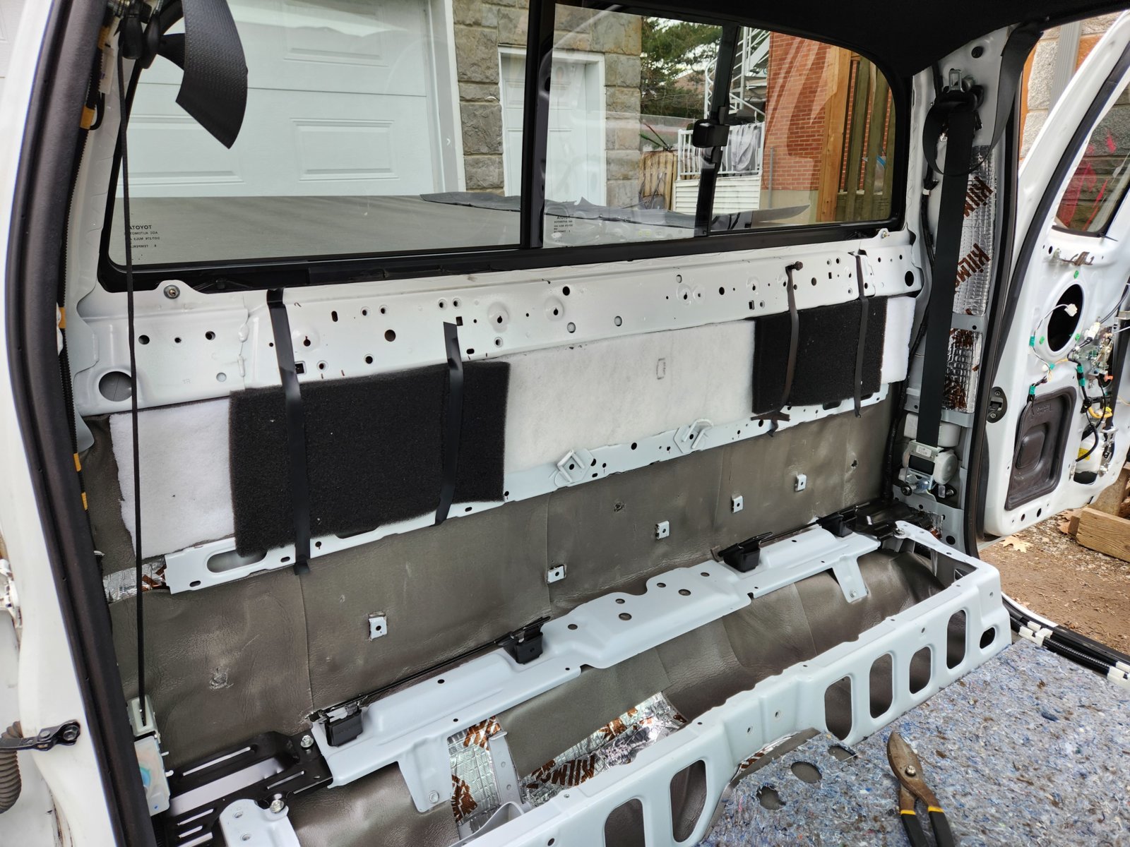

    Some areas to be careful with:

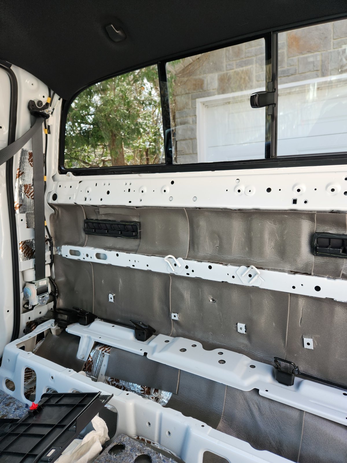

    -The aft panel has all sorts of standoffs, plastic pieces that line everything together... Try to maintain those.
    -Same for the doors.
    -The door entry plastic piece will not accomodate much extra thickness. If you add much material there it will not clip into place properly.

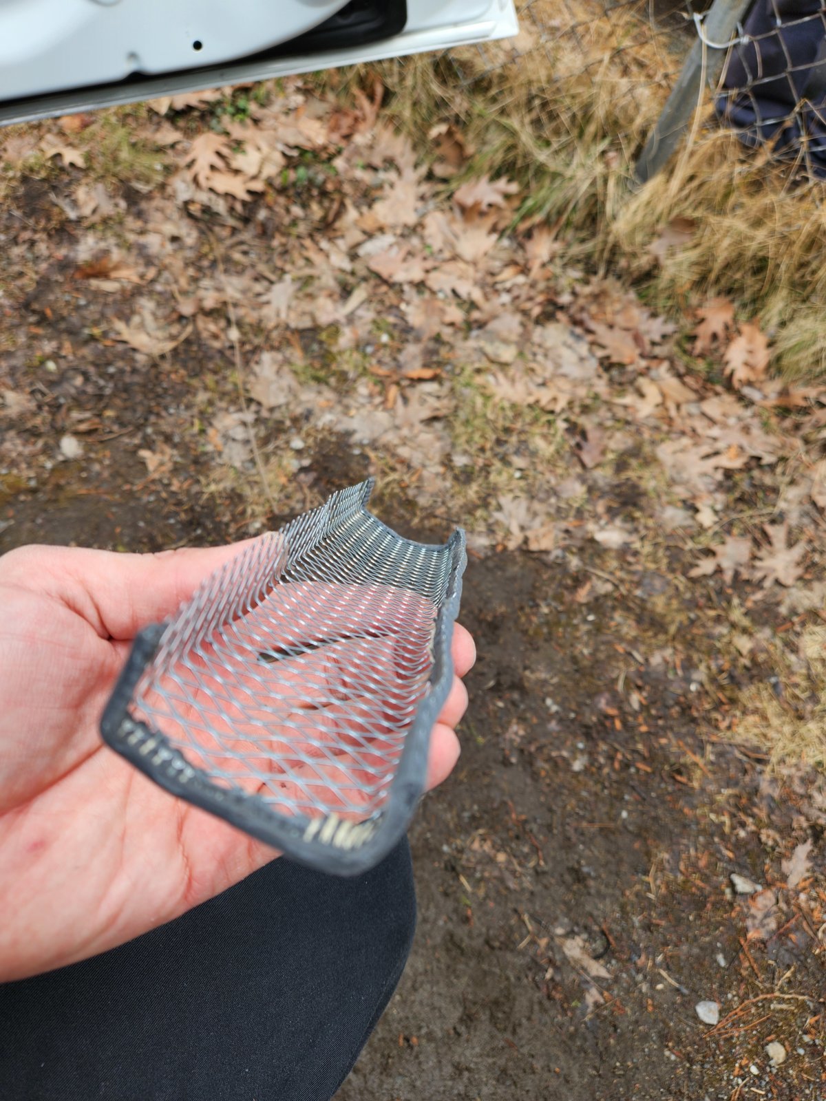

    -for the aft wall, you can get a decent sound reduction from recreating the existing sound blocking blanket that holds with snaps. Just make it out of MLW. I tried to make it somewhat bigger but had to trim most of the excesses due to panel fitment.
    -Most of the rear noise is coming from the two rear vents, you shouldn't block them but you can muffle the sound by creating an air filter over the vent inlet. After that the next step is a foam pool noodle at the lower section of the truck box to cabin frame area. It reduces road noise coming through the vents which are typically always open if you aren't recirculating air and have the cabin blower working.
    -MLV under the headliner probably isn't giving you much in terms of noise reduction... The bigger source of noise is coming from the road. Killmat and some closed cell foam will do wonders there.

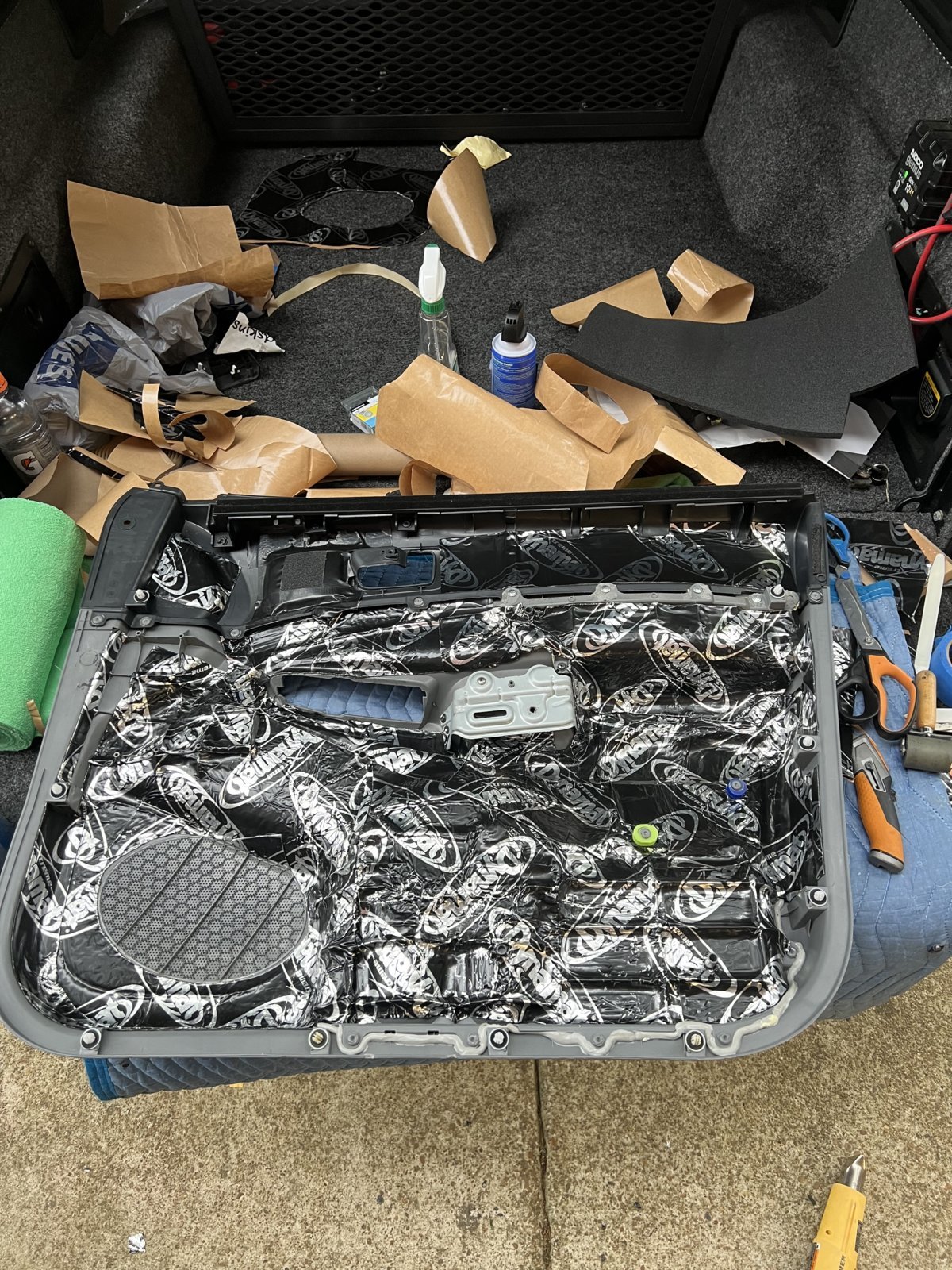

    -if you are doing MLV for the doors, make a cardboard template that you alternatively fit on the door panel and the door itself. The various standoffs (plastic pins where the door liner touches the door frame) should remain clear if you want to use the stock retaining clips. The MLV gets inserted on all the door panel standoffs and will hold in place once assembled.
    -Some brands of mass loaded vinyl can be held in place with two sided tape. Others just don't stick to anything.

    Killmat and closed cell foam,
    Some steel grills to keep the vent inlet clear.
    Some foam material to dampen the air noise.
    The OEM blanket that can be reproduced.

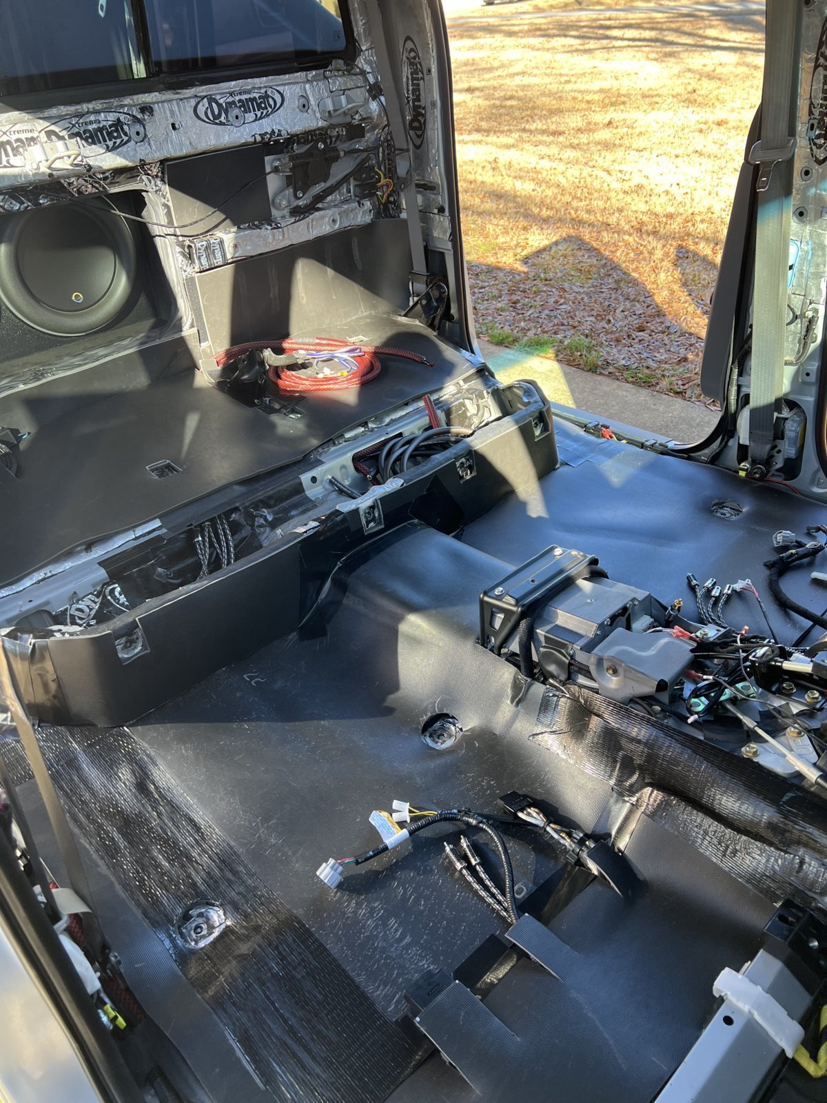

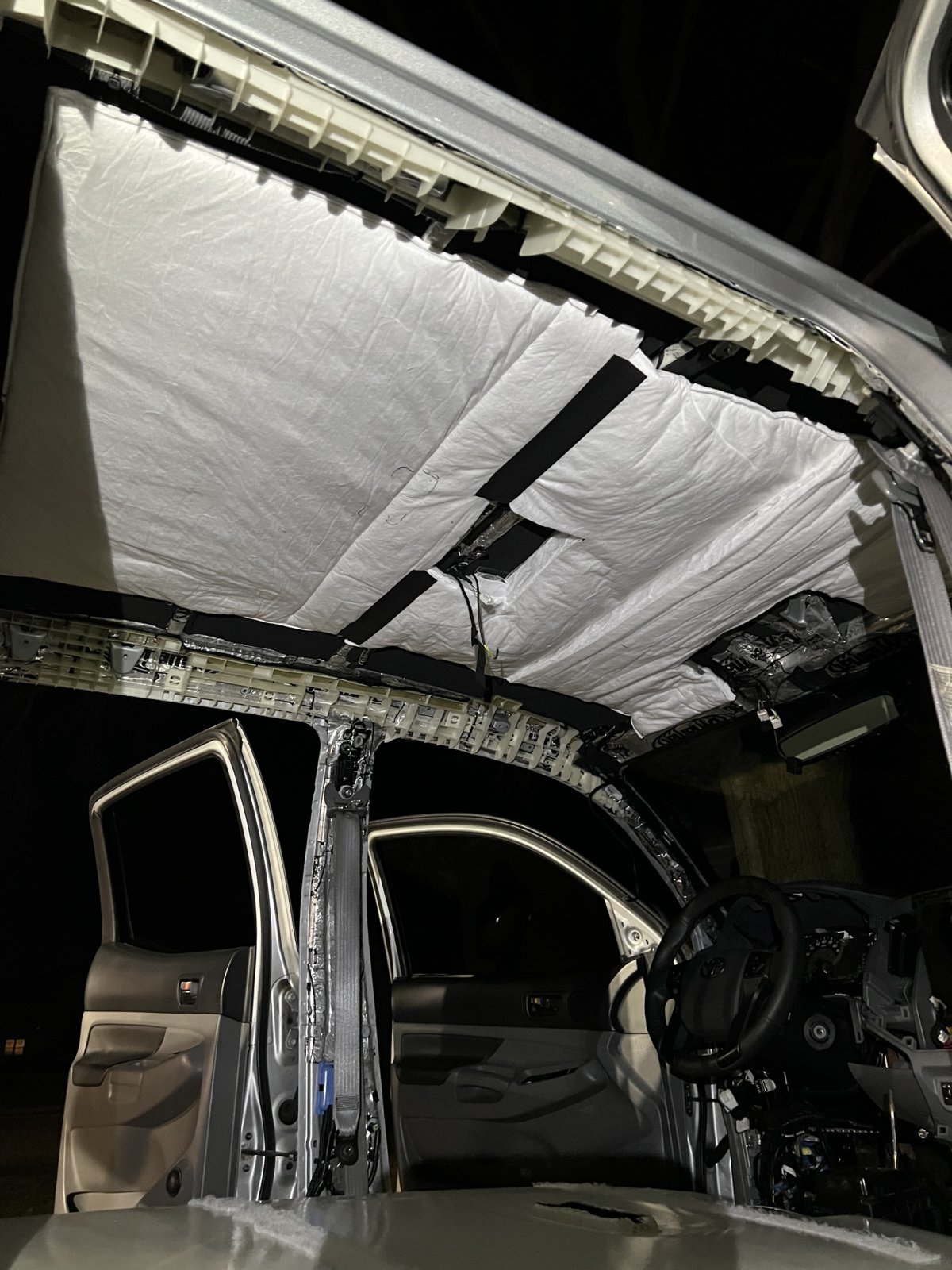

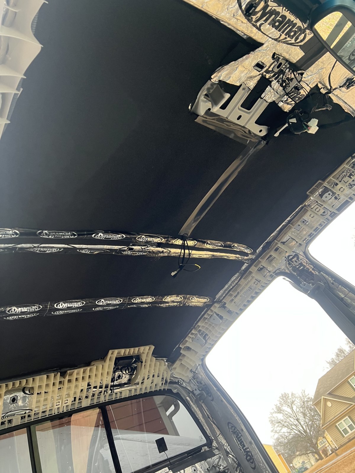

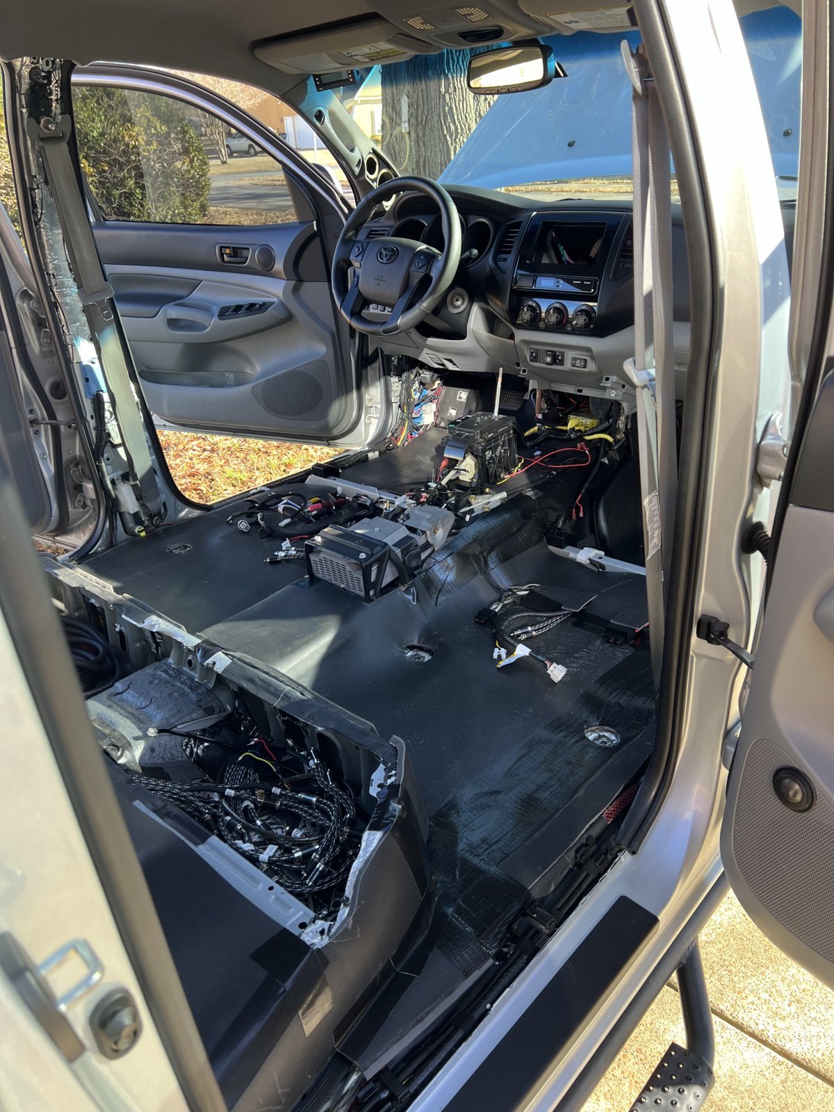

    I went ahead with doing butyl rubber and ccf on the floor, after panel, and roof. I installed a new carpet with MLV backing, and whenever I find the time, I’ll fit MLV to the aft panel. I put a piece of ccf foam over the entire aft vent, but cut ~1/8” slits in it to allow airflow, it seems to reduce a lot of noise though.
    I haven’t reinstalled the aft panel or headliner, haven’t added MLV to the aft panel, and haven’t even touched the doors yet, but my truck is substantially quieter than it was before. I’m very satisfied so far.

    I came to a similar conclusion. I am planning on doing the doors (inside, outside, and door panel) as well as in the dash areas that I can access. I may do the floors and headliner, but I'm not sure. This will be my first attempt, so I don't want to bite off more than I can chew. I prefer to use an "all in one" material, so I was leaning towards something from Soundskins. My hope is that with the doors (inner and outer surfaces) and door panels, and anything I can get to for the dash will be a good upgrade.
