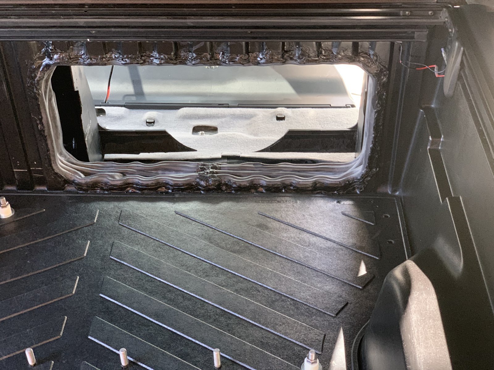

    Just requires a tiny bit of sheet metal trimming.
    :rofl::rofl::rofl::rofl::rofl::rofl::rofl::rofl:

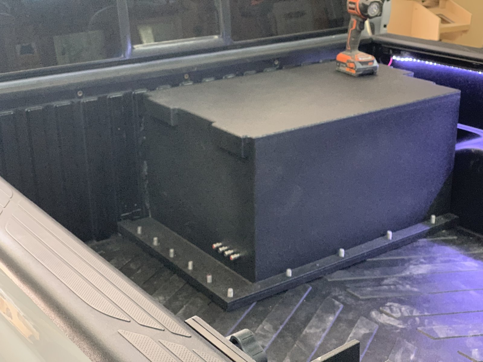

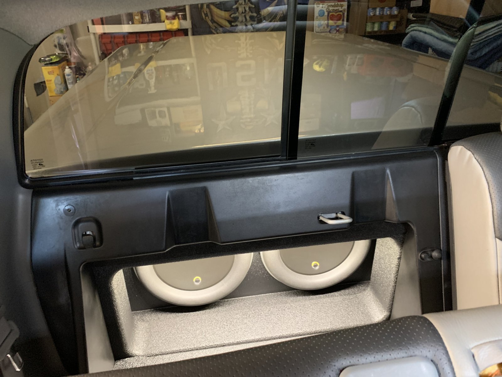

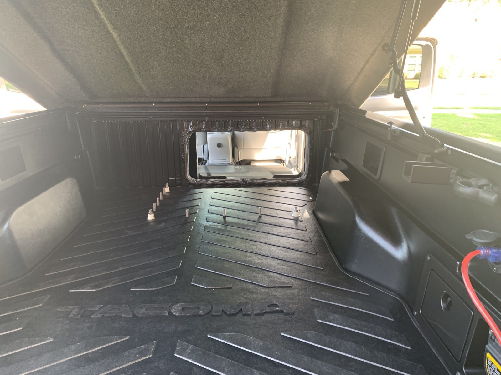

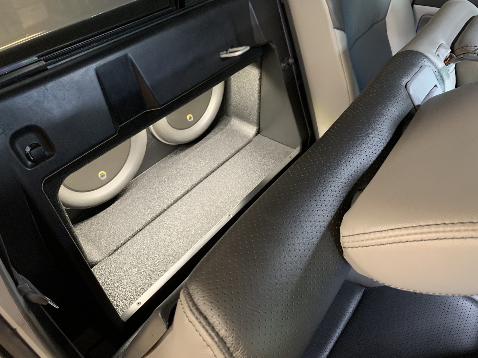

    IMG_2562.jpg IMG_2560.jpg IMG_2558.jpg IMG_2819.jpg IMG_2837.jpg IMG_2839.jpg
    Like I said to a TW member on a reply when I first posted this on the forum(not the first one to do this); it’s like a successful marriage or 28 years of Military Activity duty, it’s NOT for everyone and once you decide to do it you are committed to it :thumbsup:
    Best decision I ever made. I have zero deficiency in the bass department.

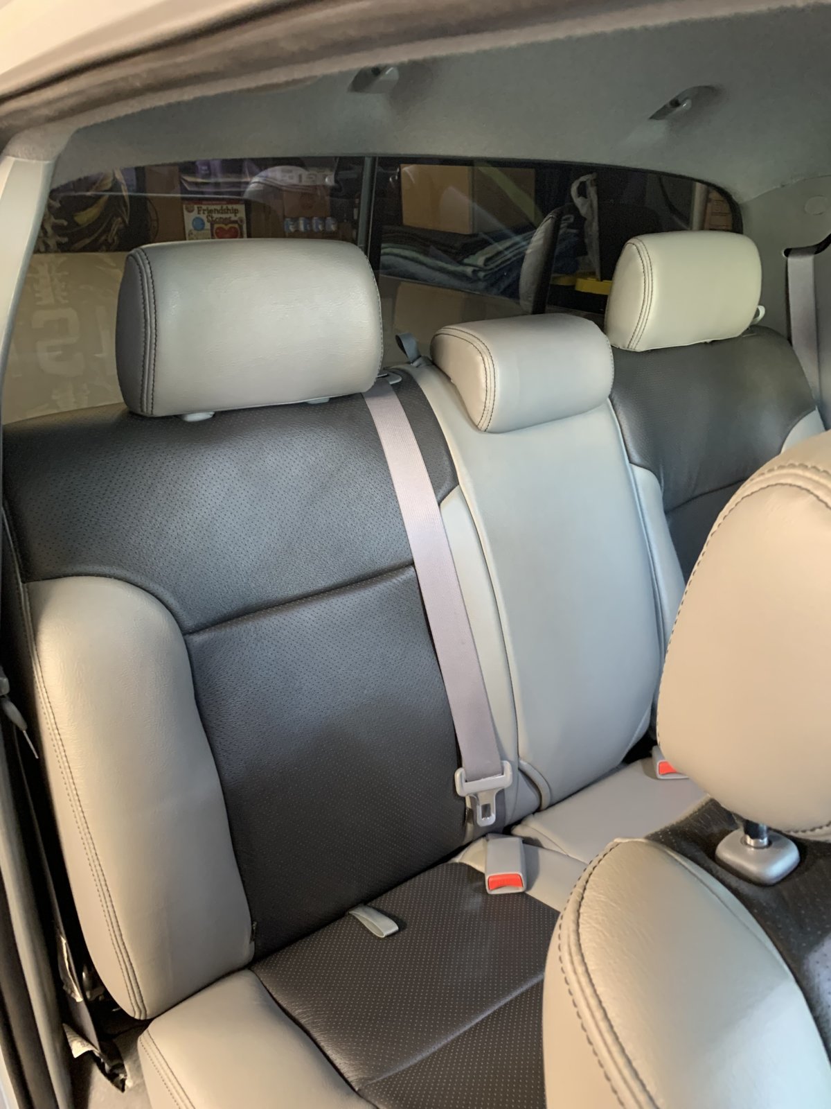

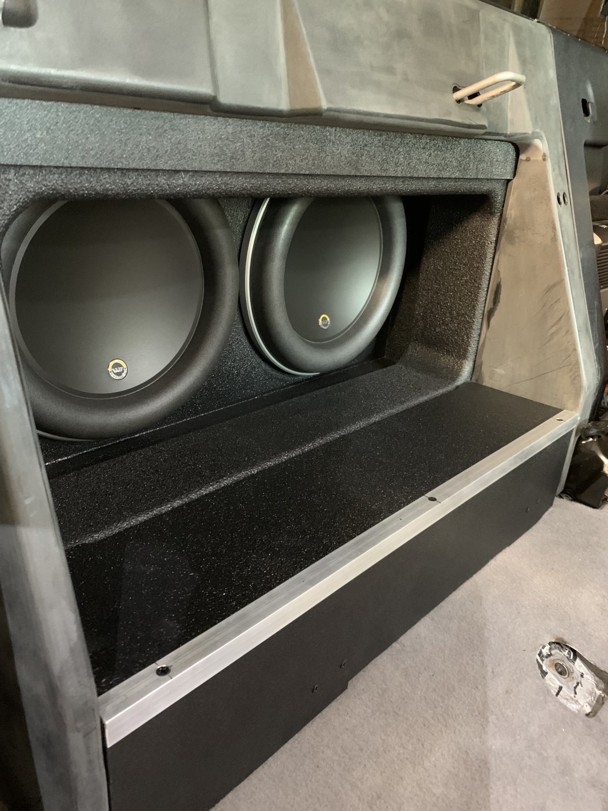

    The seats are able to stay up like if there was nothing behind them. If I don’t pull the seat forward to show you what’s hiding behind, you would never know:thumbsup:
    And yes, the bass reproduction in my Taco right now, is fantastic! Clean and with authority. Best bass reproduction I ever had in any system I owned in any of my prior vehicles.
    I have Focal Utopia 8WM on each front door. Audiomobile EVO2408 in sealed box in the front passenger foot well, and (2)12W7s in a built to spec braced sealed 13 ply Baltic Birch box.
    I’m not a bass head, my build is not for SPL or SQL, it’s really meant for SQ. But if you want to have fun with the system, it gets low with authority.
    And for some of the replies on this thread, that argue, that after a certain point of CLD, MLV, etc, you get a diminished return on your investment, all I can say is the cab on the Taco with Goodyear Dura Tracs is as quiet as a high end luxury vehicle and have zero resonance or rattling issues with the system at full tilt.
