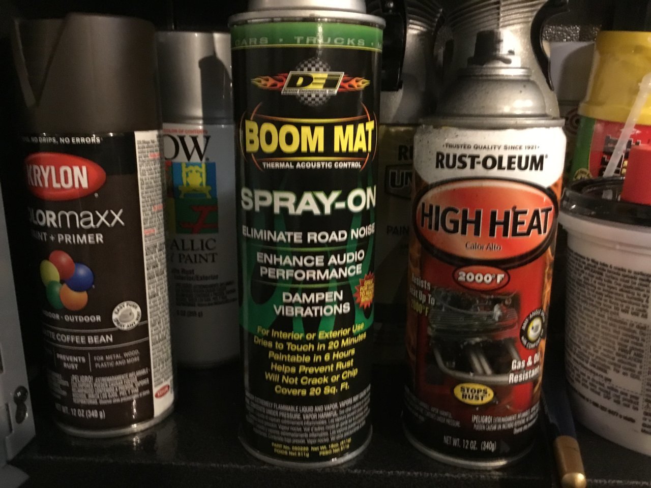

    What do you think undercoating is? It does more than just try to help stop rust. Anytime you add weight to an object, you change the materials resonance frequency. This is how most “sound deadening” products for the automotive industry work. You could also use spray on bedliner as well.

    i hear its not as effective as the butyl sheets. but thats all hear. i've never used it personally.

    There are many many out there, these are just the ones I know of. Most of them a ceramic spheres in them to control heat also. I used acoust-x on the roof of my truck, Im planning to do more this summer. Spray on does a better job than mats do as it can flow into cracks, but its also way more labor to do it. You have to strip out everything, then tape and cover everything else, then spray it, let it dry, spray another coat, let it dry, then you can start putting it back together after 24 hours or so.
    https://lizardskin.com/
    https://www.secondskinaudio.com/sound-deadening/spectrum-liquid
    https://www.designengineering.com/boom-mat-spray-on/
    https://www.heatshieldproducts.com/sound-insulation-coating-db-skin
    https://www.acrytech.com/product/acoust-x-sound-damping-coating-5-gallons/
