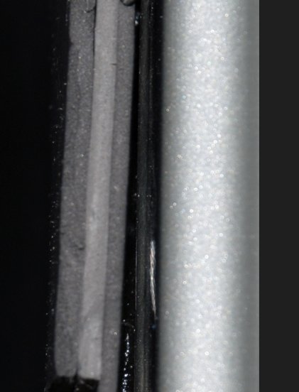

    Not sure of the square footage, but as far as the stages...
    from the outside
    damper
    decoupler
    barrier layer
    decoupler
    (shown in reverse order below)
    works well for me.
    Maybe break out a tape and estimate 25% on the high side. Good dampers don't require full coverage but barrier layers do.
