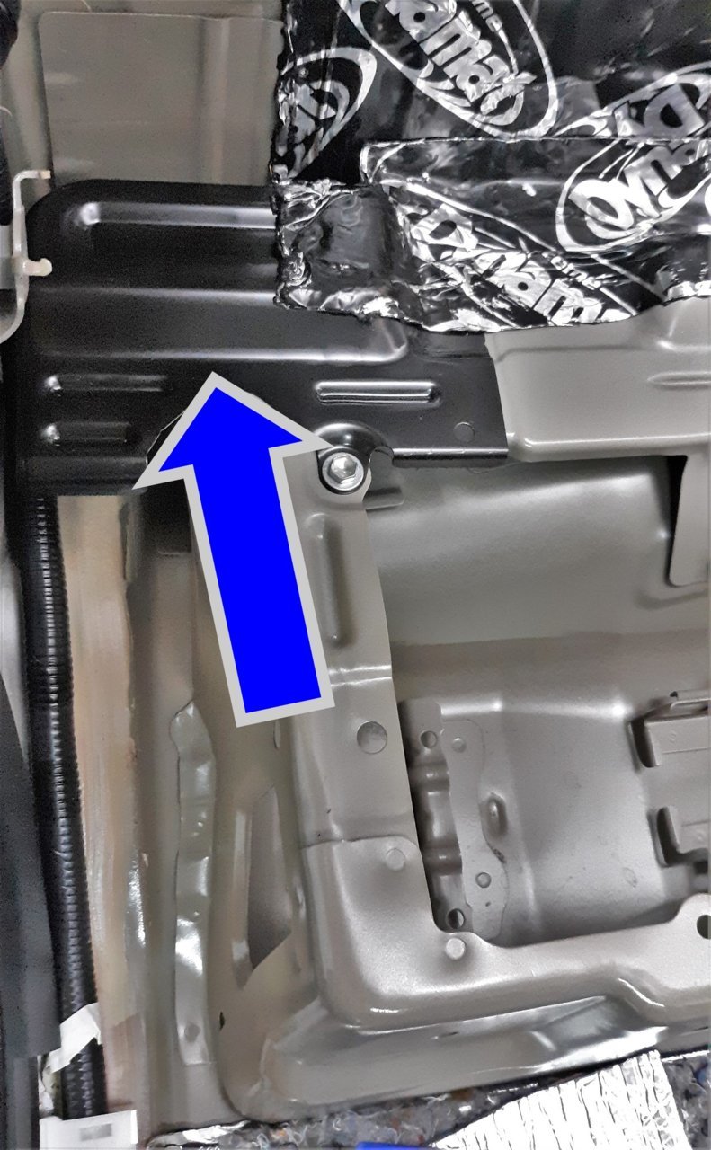

    Quick question:
    Do these black bolted-on extension plates in the back of my access cab perform any important function? I have deleted the back juumpseats, so I have my doubts. I'd just as soon yank them out while the cab is all gutted.
    Please advise!

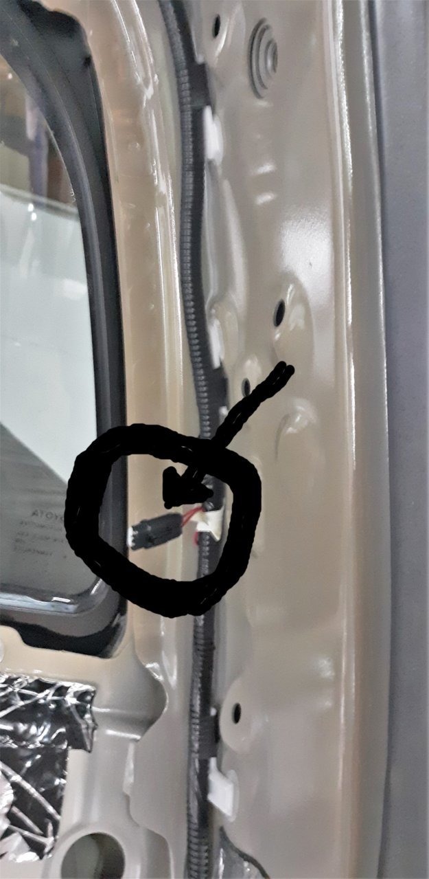

    When I pulled off the C pillar covers in back on the driver's side I found this exposed female plug just hanging there behind it. I am guessing it goes to some feature that my trim level did not have ( or the PO did not opt for) and is not a concern ??
