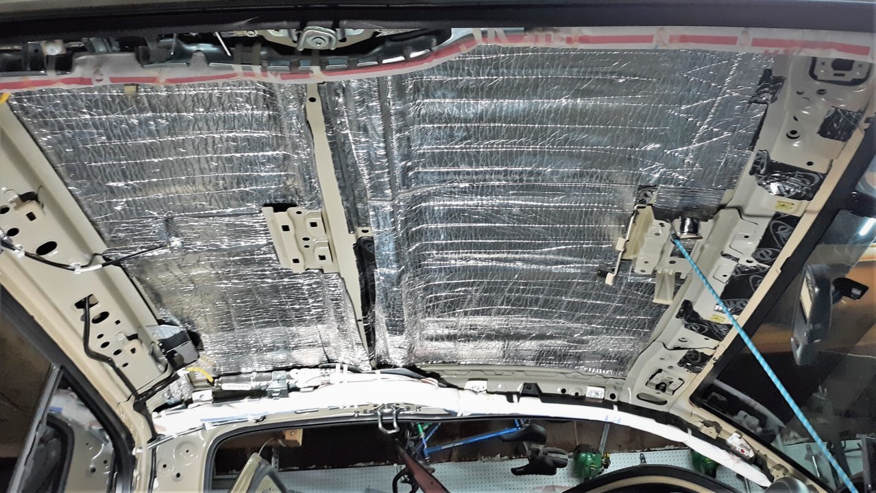

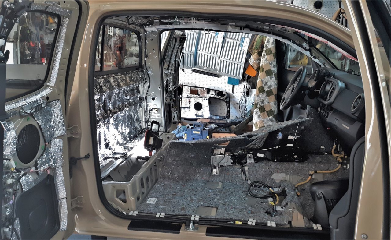

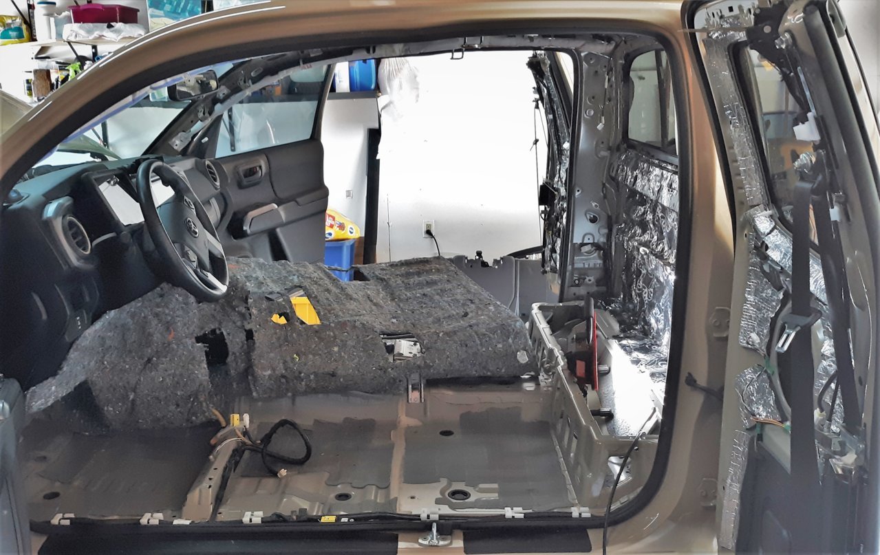

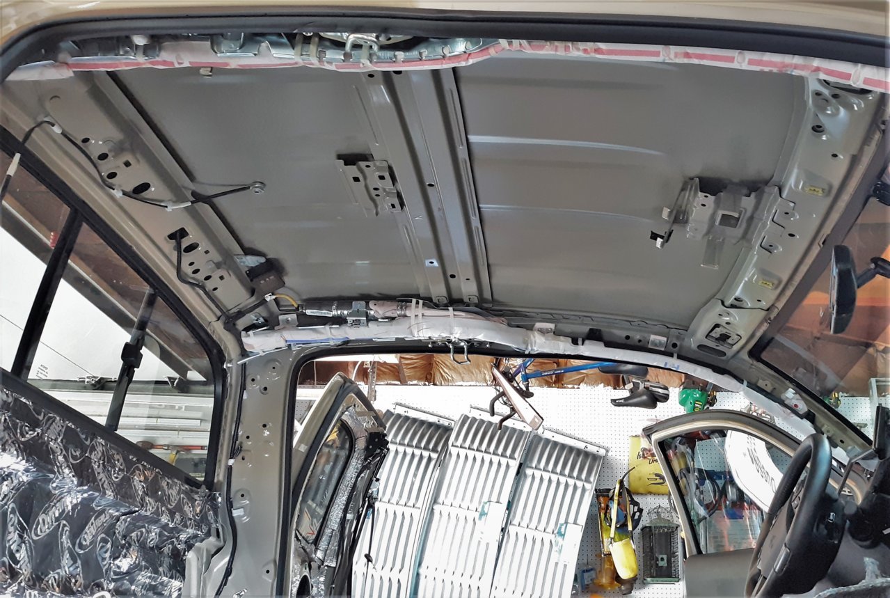

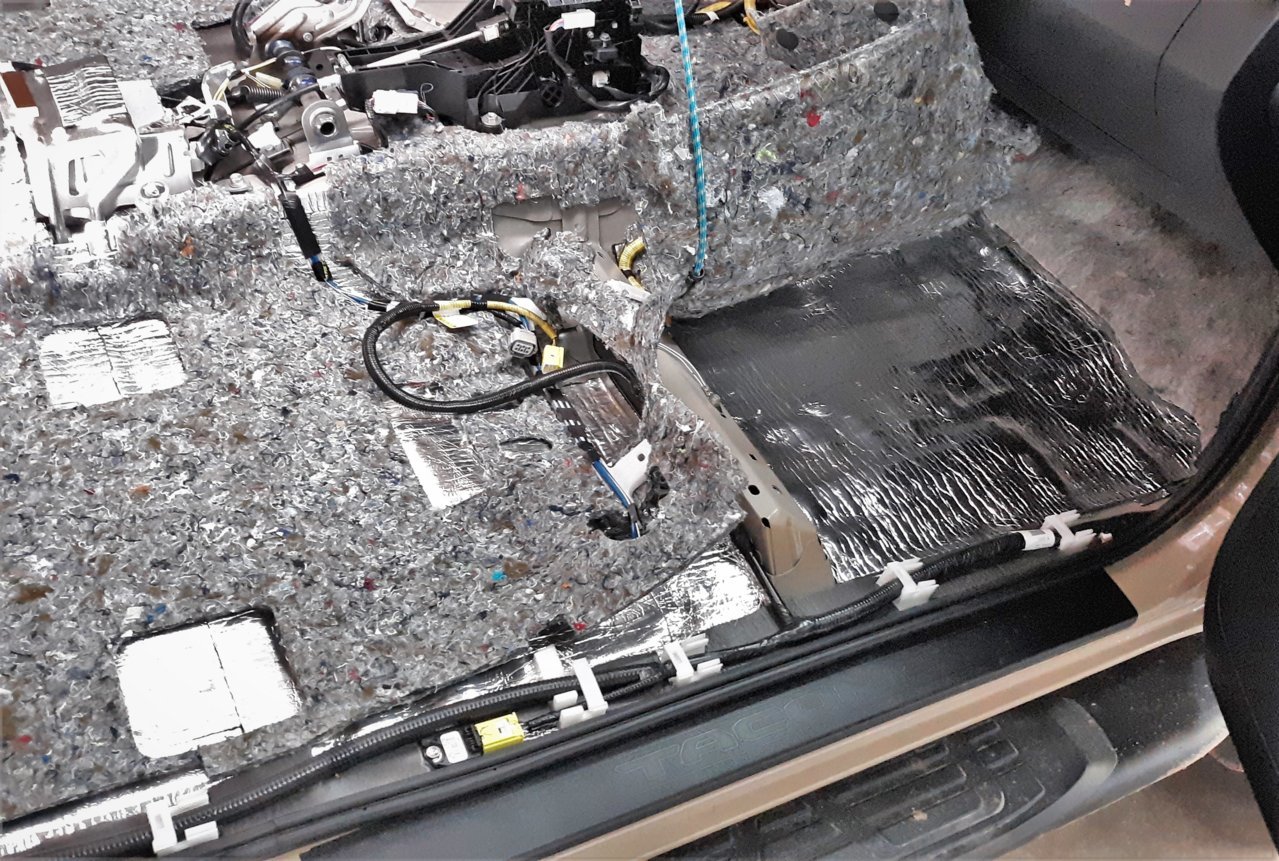

    So the truck is back together. Man, it was a colossal PITA, but the results are certainly worth the hassle. The level of quiet is pretty amazing compared to stock. If I had it to do over again I would not have used quite as thick of material in the floorboard; that was a major BITCH to reassemble - and some of the floor-to-door transition pieces simply will not fit correctly with that much bulk under the stock carpeting. I had to trim the outer edges of the OEM floor padding in order to get the carpet to sit low enough to at least get a partial fitment for the floor transition pieces to snap in. I considered drilling a few more holes and then gluing in a 2 or 3 of those push-lock snaps (like the door panels use) in order to achieve a more robust engagement of the trim strips, but didn't want any more holes in the floor that would invite rust later on.
    Some pics of the procedure...

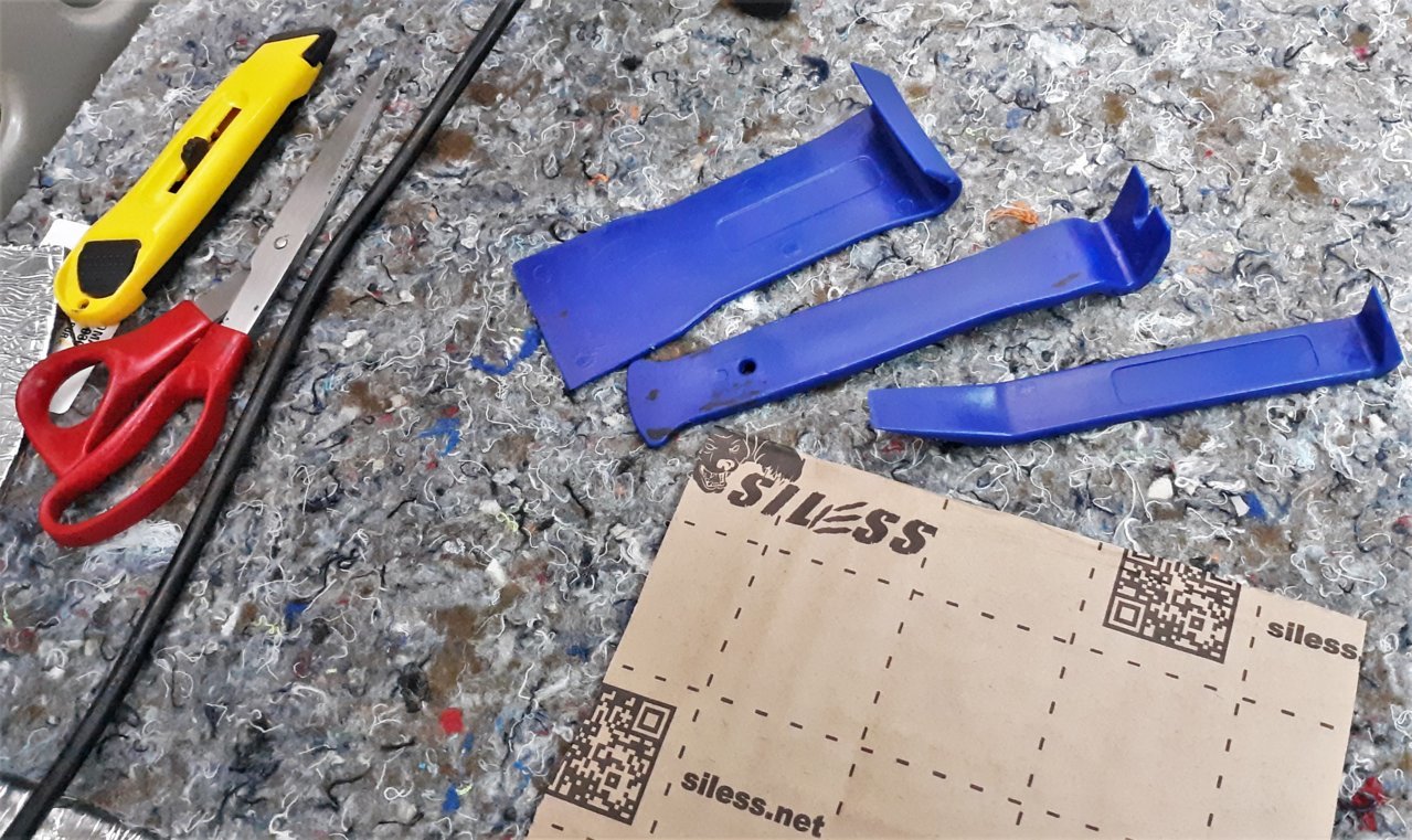

    These are the tools I used to press the initial butyl layer into place. Worked far better than the roller. The top wider tool for larger sections, the middle one mostly because the bottom was smooth and wide with no sharp edges; perfect for pressing material into cracks ans under sections. The littlest tool for smaller, hard to reach areas.
    And I used the pool noodle trick suggested by Scottyskywalker. Only diff there was that I pressed the noodle up higher in the middle, to hopefully promote better drainage and prevent any water from accumulating and possibly causing rust around it later on. But yes, it DOES make a difference on the amount of tire/road noise sneaking in through those equalization air vents in the back wall of the cab.

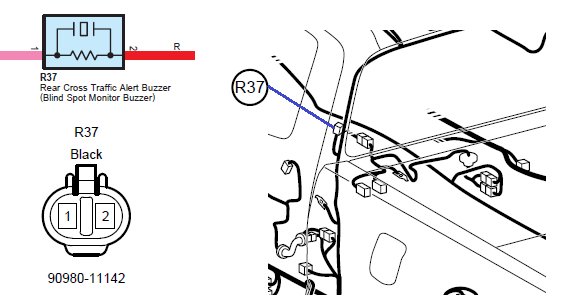

    A difference I see between the Access cab and the Double cab is the location of those rear wall air vents. In the pictures of this thread I do not see any for the Double cab. Where are they?

    X2, that is where my annunciator is.

    Thanks for the info. Mine wasn't equipped w/blind spot sensors. Must be a case of the same wiring harness for all models; some just don't use every hook up.
