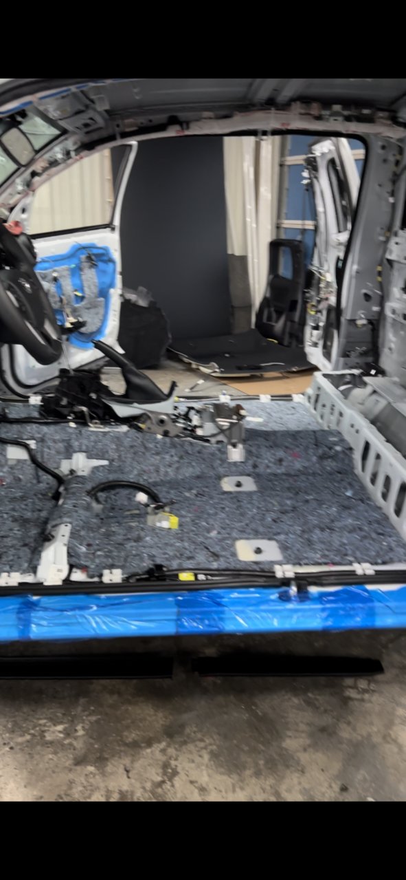

    DEA2E77E-3C92-4232-A634-61C5961CFB78.jpg Mine took 72sf.

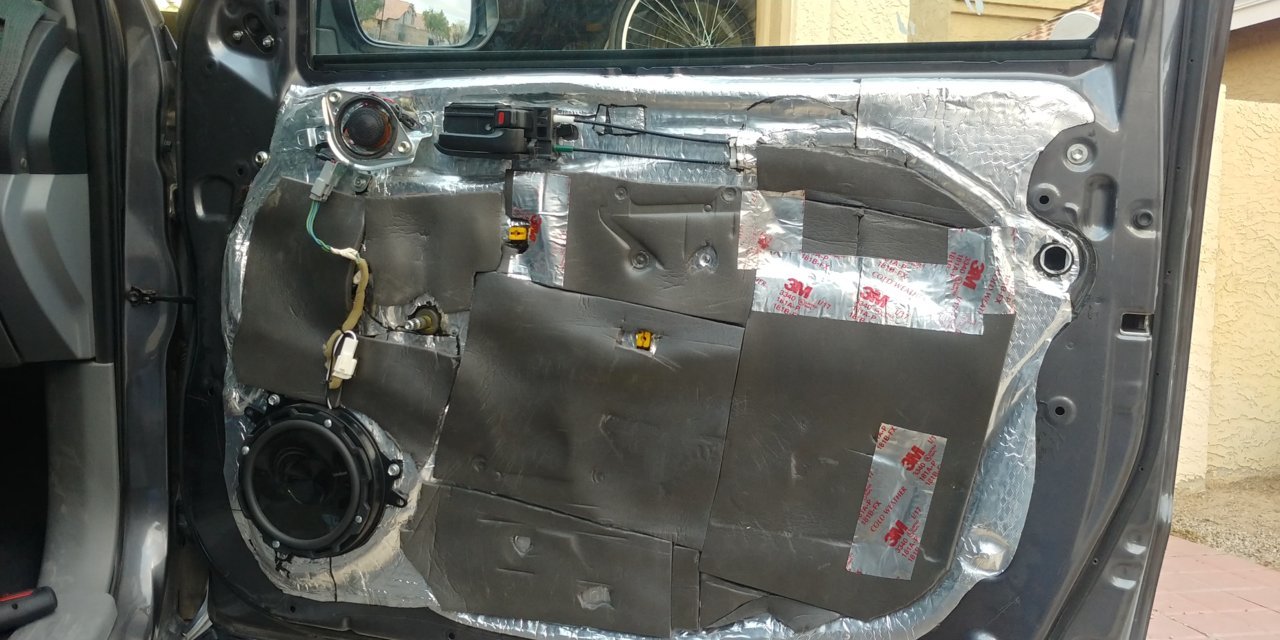

    I agree with a lot of the others. The doors made the biggest difference for me. Just a heads up, the 3m tape is when I had to replace my window.

    So for the doors you guys just slapped it on the outside? I would have thought it would go in the outer door skin/inside the door.

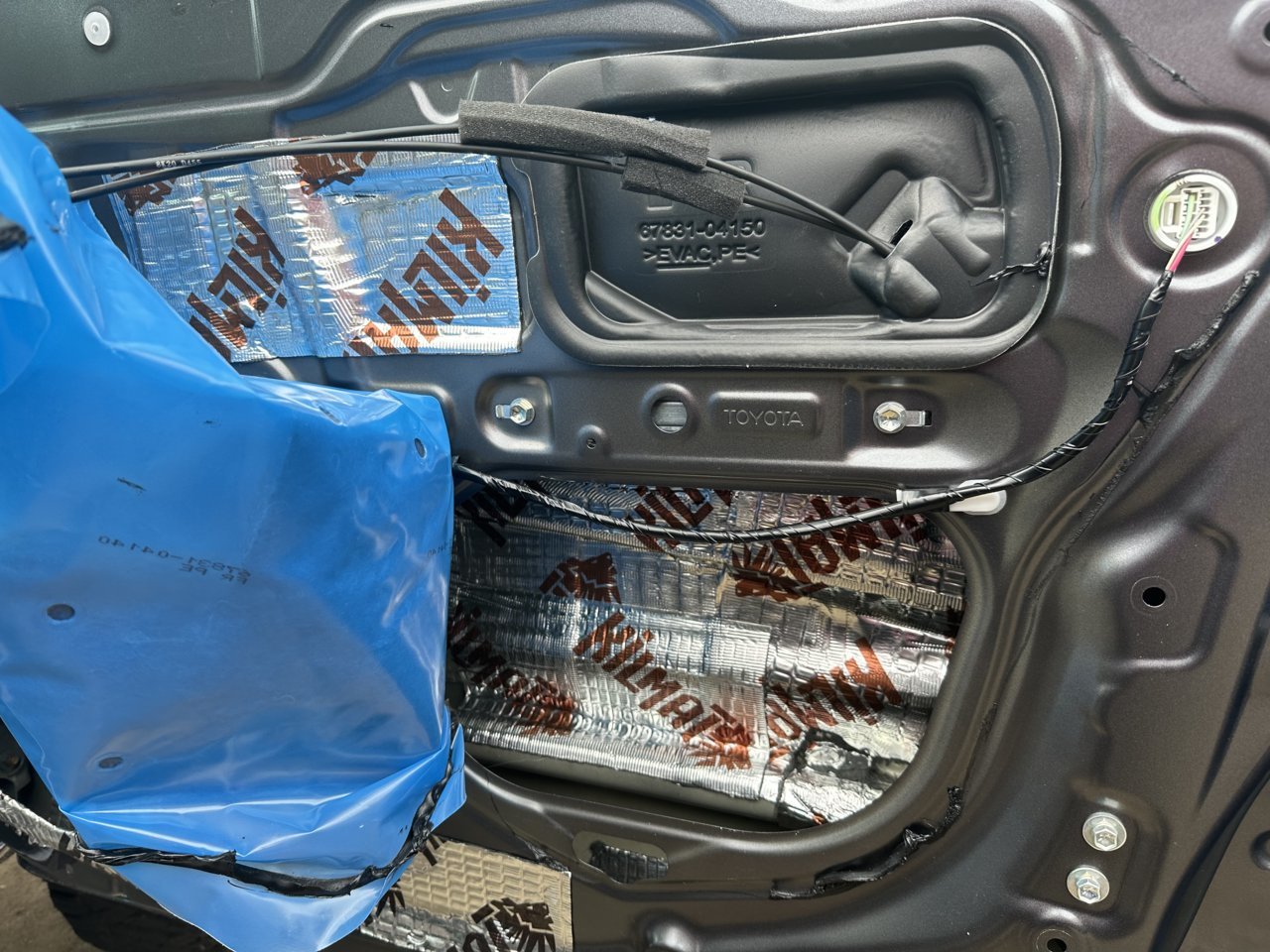

    I did both the outside skin and some on the inside of my doors

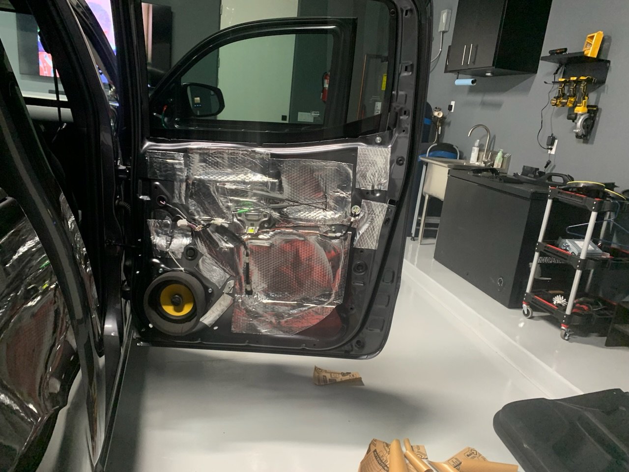

    I did butyl on the skin with a square of foam behind the speaker, then a layer of butyl on the frame. Think I may have put a layer of foam on the back side of the door panels as well.
