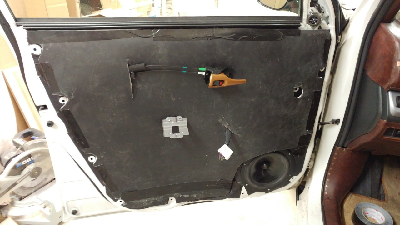

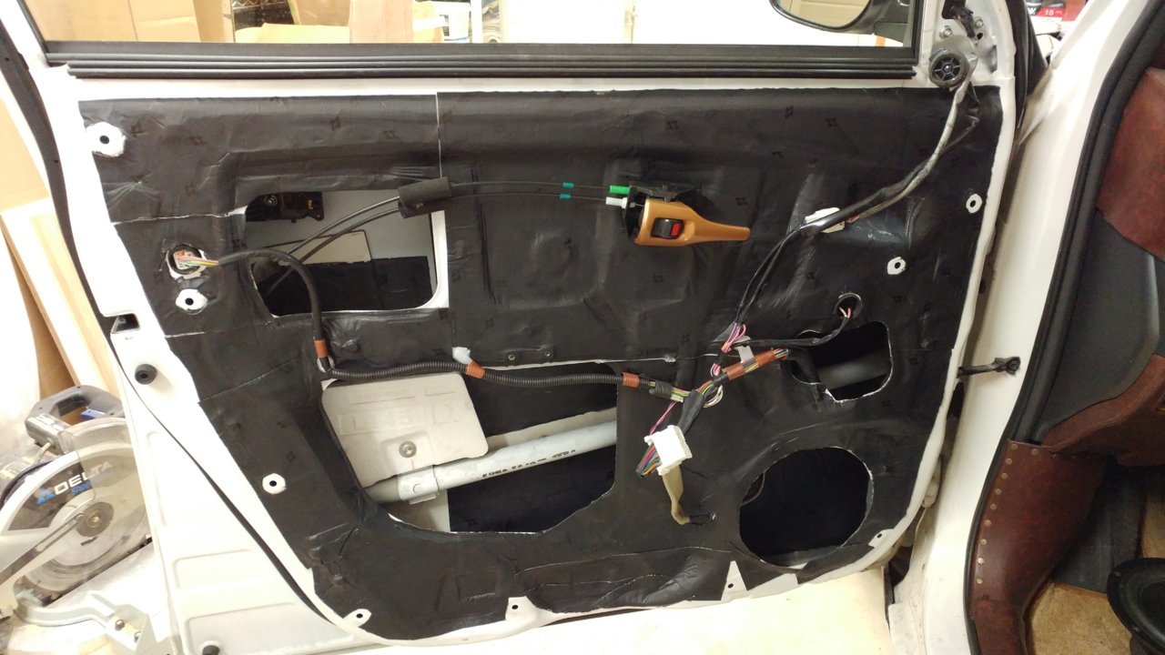

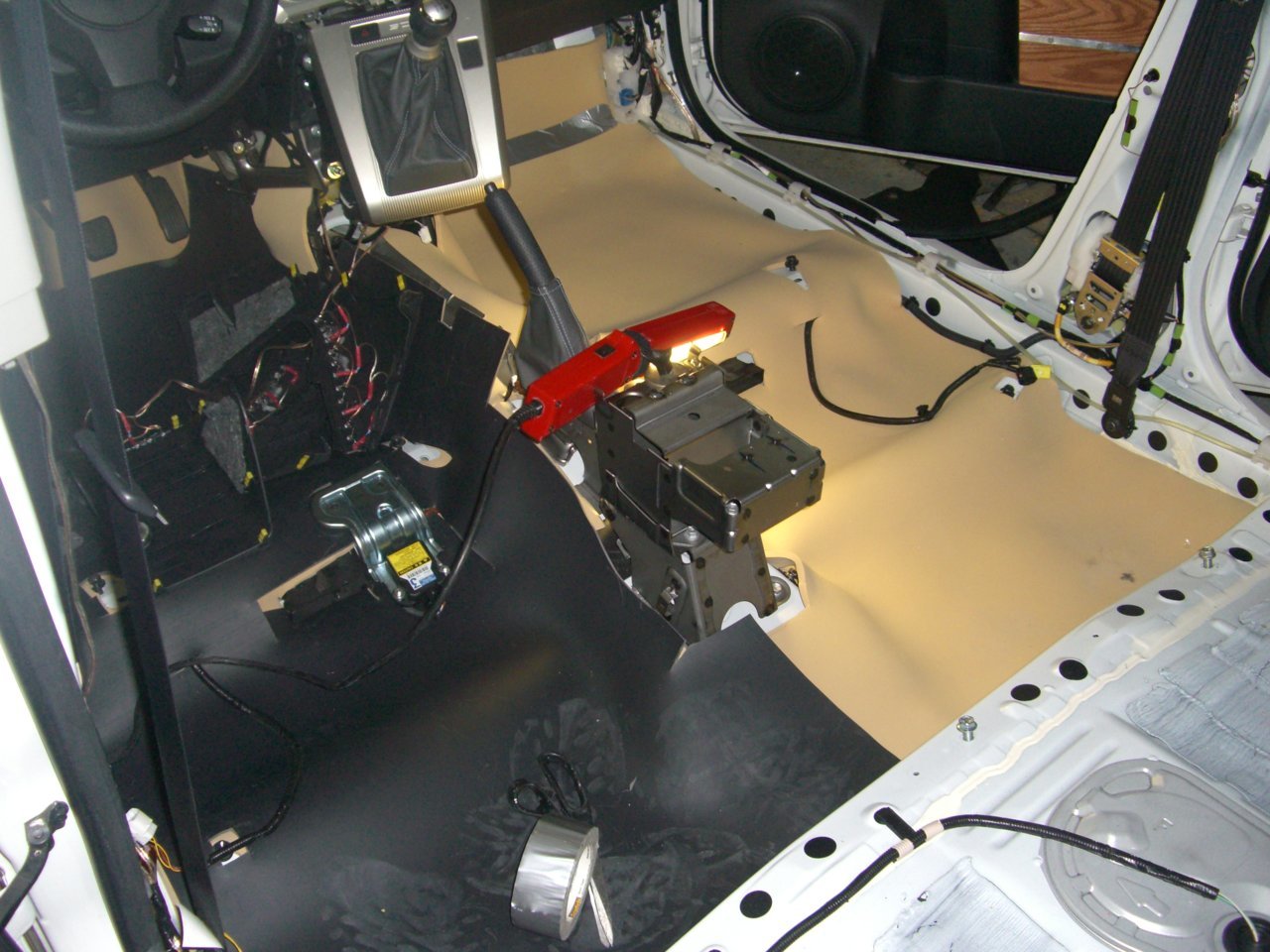

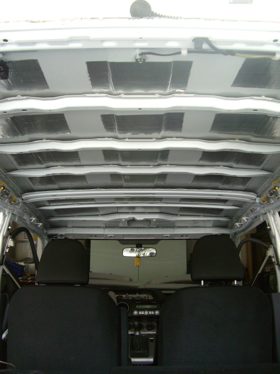

    A combination of closed cell foam with a layer of mass loaded vinyl over it will do more for for the floor than stick on deadener. Deadener is mainly for panel vibrations while the foam/vinyl combination is better at reducing air born noises like road and tire noise. Both should be used on the doors since the speakers are mounted in them and they let road noise in. For the roof I usually go with CLD tiles. Basically sound deadener with a 10-15 mil thick aluminum backer to add a lot of mass over a small area. It takes a lot more time and money but does produce better noise reduction results.
    Not my Tacoma but here's the deadening I did in my other car.
    CLD tiles on the roof
    Closed cell foam on the passenger side with the mass loaded vinyl over it on the driver's side. Eventually covered everything.
    Sound deadening on the doors, both inner and outer skin.
    A layer of closed cell foam
    And finally a layer of mass loaded vinyl over all of it.

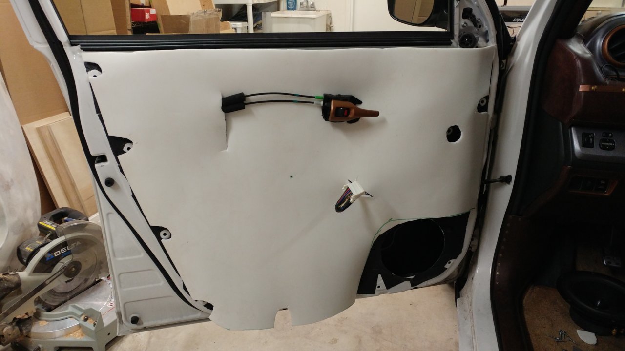

    I was also riding around with only a drivers seat for about 2 weeks
    I didnt do any testing in between sound deadening and close cell foam so i cant verify a difference there
    Does anyone have a link to good MLV for purchase?
    prior: road noise @60mph highway to work 70dB (iphone app)
    after: same highway @60mph 66-67dB (iphone app)

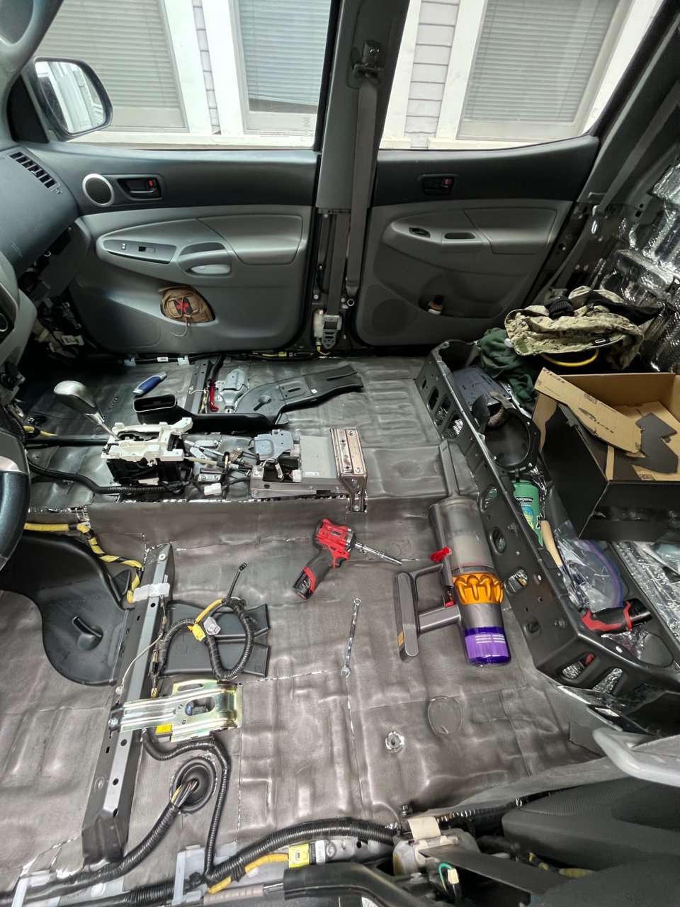

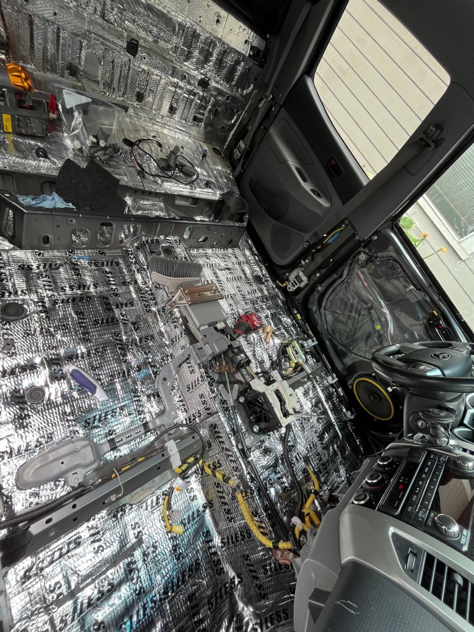

    pics for reference
