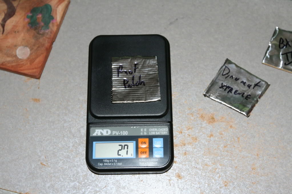

    Snagged this from a guy on my subaru forums
    [​IMG]This image has been resized. Click this bar to view the full image. The original image is sized 1023x682 and is 160KB.IMG_4699_5c1c1f5cf09ff2ff89c13a44c6b736e26b16c3b3.jpg

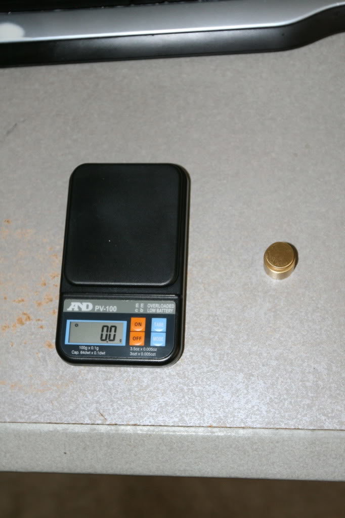

    The scale, freshly zero'd
    [​IMG]This image has been resized. Click this bar to view the full image. The original image is sized 682x1023 and is 91KB.IMG_4700_28325c8f37143ec2905d4135726fb5548e4f2099.jpg

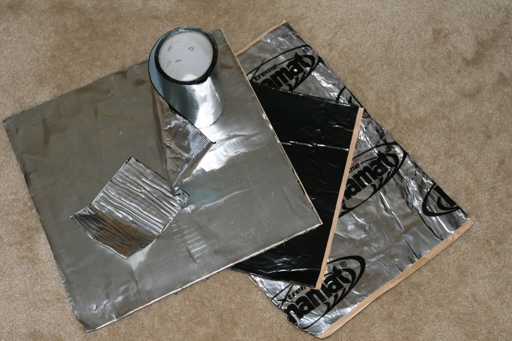

    The pieces
    [​IMG]This image has been resized. Click this bar to view the full image. The original image is sized 1023x682 and is 126KB.IMG_4701_cb557be117f9a3cb5277fe584a07e61df691a308.jpg

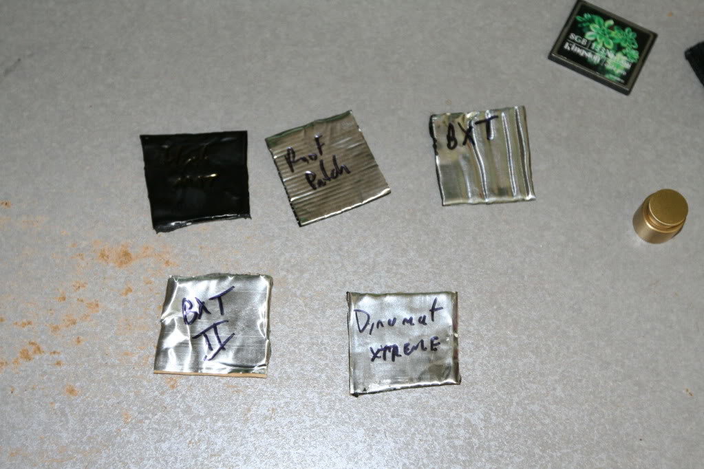

    May not be pretty, but I laid them on top each other and trimmed till they were all the same.

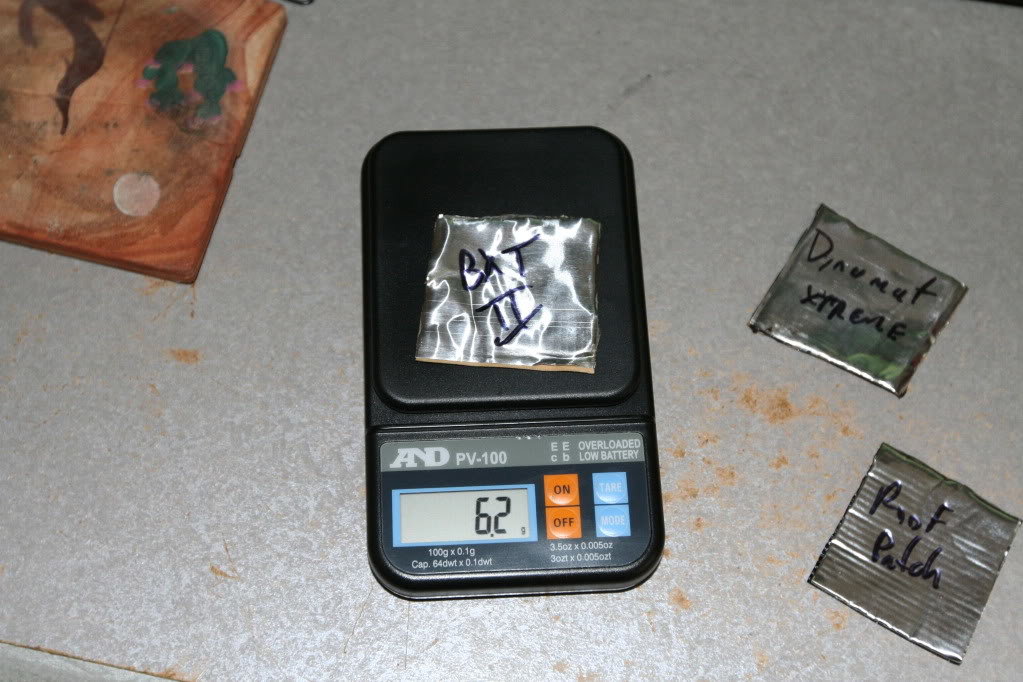

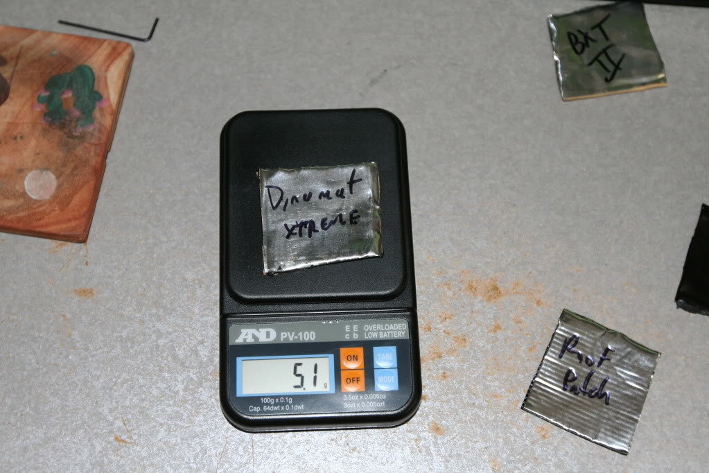

    Pics or it didnt happen.
    [​IMG]This image has been resized. Click this bar to view the full image. The original image is sized 1023x682 and is 122KB.IMG_4706_341c3f9f449e8c178ae28708a5c8e4d9eef54fae.jpg
    [​IMG]This image has been resized. Click this bar to view the full image. The original image is sized 1023x682 and is 135KB.IMG_4705_fc1e2e6e9f92703899a32e8f2443956271cd9096.jpg
    [​IMG]This image has been resized. Click this bar to view the full image. The original image is sized 1023x682 and is 130KB.IMG_4704_fae977edb3583c6581ffb9970ace98297ec2d3f6.jpg
    [​IMG]This image has been resized. Click this bar to view the full image. The original image is sized 1023x682 and is 132KB.IMG_4703_acef4d8e1d6f92418a26181d0dbe60cf8549f3e4.jpg
    [​IMG]This image has been resized. Click this bar to view the full image. The original image is sized 1023x682 and is 120KB.IMG_4702_9a52e6b0f99ea031293f3f81092baa32466d31e4.jpg
    The black stuff is the hushmat.

    Ok, I'll play. Let's do this one at a time so I don't confuse anyone.
    You are right about DynAmat. Very marked up product. This is why I recommend Don at SoundDeadenerShowDown and Second Skin Audio. Their stuff is more reasonable in terms of price. All three brands are good stuff though. I've used both Don's stuff and the Second Skin products and I'll continue to use Don's because I prefer it. If you need me to explain why I certainly can.
    As for the difference between Peel and Seal and REAL deadener it's quite different. Peel and seal is intended to seal things and fix small gaps in a roof. It's an asphalt based compound that melts a little in the heat. This helps it "fill in the cracks" sort of speak. True deadener is a Butyl Rubber based compound that has MUCH higher thermal properties and doesn't really release an odor. As far as I understand it, asphalt has little to no visceoelastic properties and does a poor job at turning the vibration into heat. (remember, you can't destroy energy, that's a law, you just transform it)
    Low thermal limits. If it's placed horizontally like on the floor you'll likely be ok. (Chances are your floor needs no deadening anyway. If you understand the concept you know why). However, in a vertical setting like in a door the compound reaches a temperature where it sleuths off or starts to run. I've seen it come off before and it's quite the mess. Temperatures in your door can get extremely high.
    Not only that, but the Peel and Seal stuff has a low mass/sq in ratio meaning you'll have to do more layers to equal the good stuff. And I know what you're thinking, "Steven, if it's cheap enough that I could do multiple layers isn't that the same thing?". Well yes and no. You would CERTAINLY have to do multiple layers to equal the dampening properties of a well designed, thicker deadener. But now you've created two more problems.
    The first problem is that now you have multiple points of failure. Meaning, you have deadener stuck to deadener stuck to deadener...etc. Not only that, but you have the original layer (one interfacing with the door metal) holding many times it's own weight with the addition of the other layers. But you also have to think about what your time is worth. Have you guys been inside the doors for very long? It's tight, cramped, and full of sharp edges. Doing multiple layers in that type of an environment is frustrating to put it nicely. It's not easy on the fingers either. Ever tried using a roller on a surface that's not flat or inside a door? It doesn't work. :p
