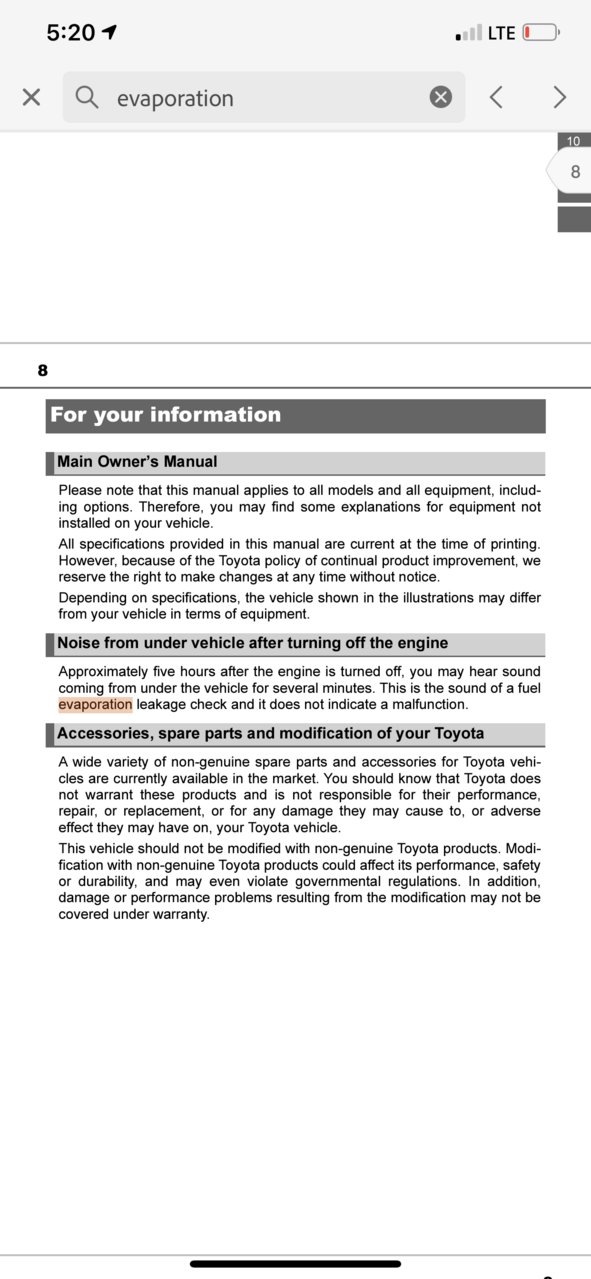

    Nevermind I found it. To the guy saying read the manual, go away if you can’t be helpful. I can understand if someone was asking what type oil the engine needed or what a certain dash light meant but this one is quite confusing unless you already knew what it was. People like you make me wish there was a way to auto post to your topics ‘read the manual’ every time.
    By the way, evaporation was the key word that helped me find it. Emissions search nor fuel pump didn’t help which is what I thought it was.
