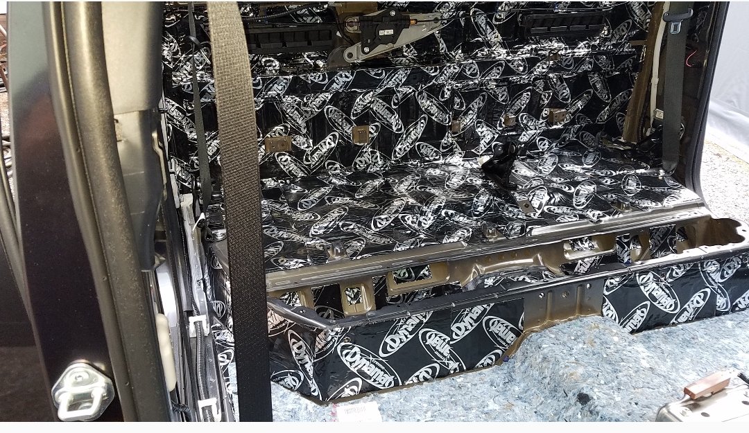

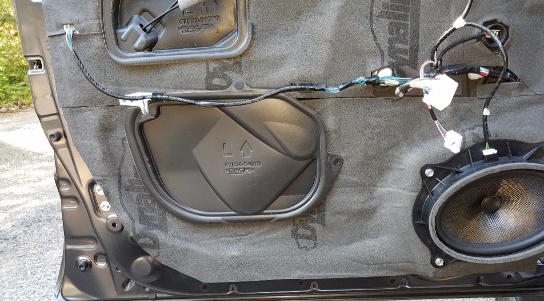

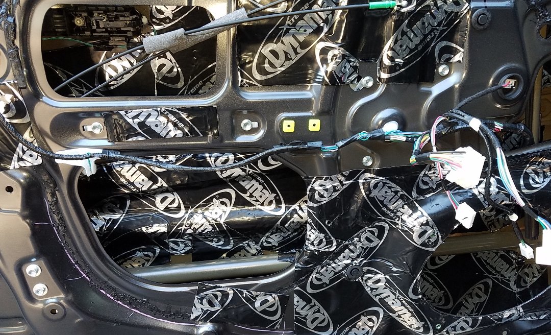

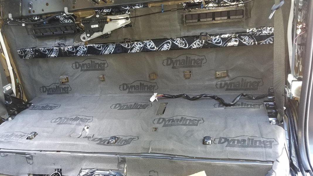

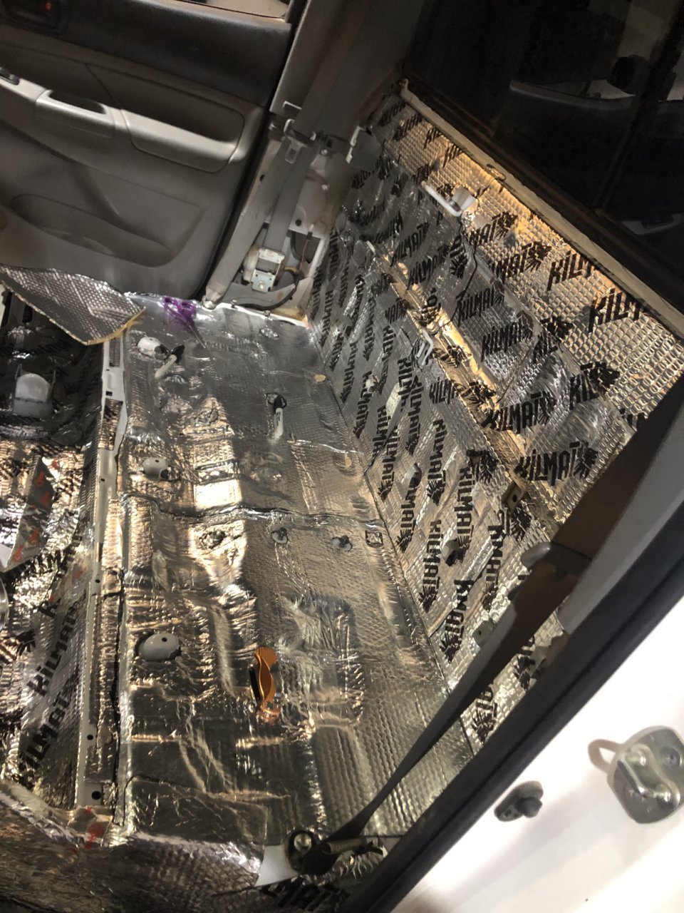

    I'm sure you can do as recommended which is 40-50% coverage for dynamat or Noico. I did 90-95%. Especially if you consecrate on the doors and back wall which will give you the most noise reduction with good coverage.
    20190725_180414.jpg 20190725_180355.jpg 20190725_180438.jpg 20190725_180503.jpg

    I finally have the backseat back in and I have to admit that it is noticeably quieter now. Not sure if it was just 1 of the 3 layers or all put together but something helped LOL. Doors closing sound solid like everyone talks about. I did have to trim the MLV out form under the rear plastic bins bc they would not bolt back in place with the 3 layers I had underneath them. Still working on the front kick panel areas so that I can get the door sills popped back into place but for the most part I am done. Also swapped to the Kicker speakers and they do sound better than stock but most anything would compared to stock.

    Nice job! Very thorough.
    Question? With your 90-95% coverage, how many rolls of the 32" x 54" dynaliner did you use?
    Also, in your last photo, you've covered that back wall cross member; do you think leaving it uncovered would make a big difference? I left mine bare metal, but now I'm questioning whether I should have covered it as well.
    I have a doublecab, and am looking at adding the dynaliner over the kilmat that I'm also presently installing.

    I think I used 3 of the dynaliner and didn't add it under the carpet where there was already oem padding. It would get too bulky to attach some of the trim. I did add it to the roof tho.
    Leaving the back brace will not make any noticeable difference Imo.

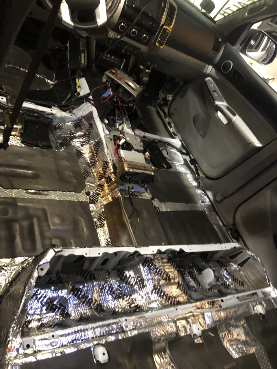

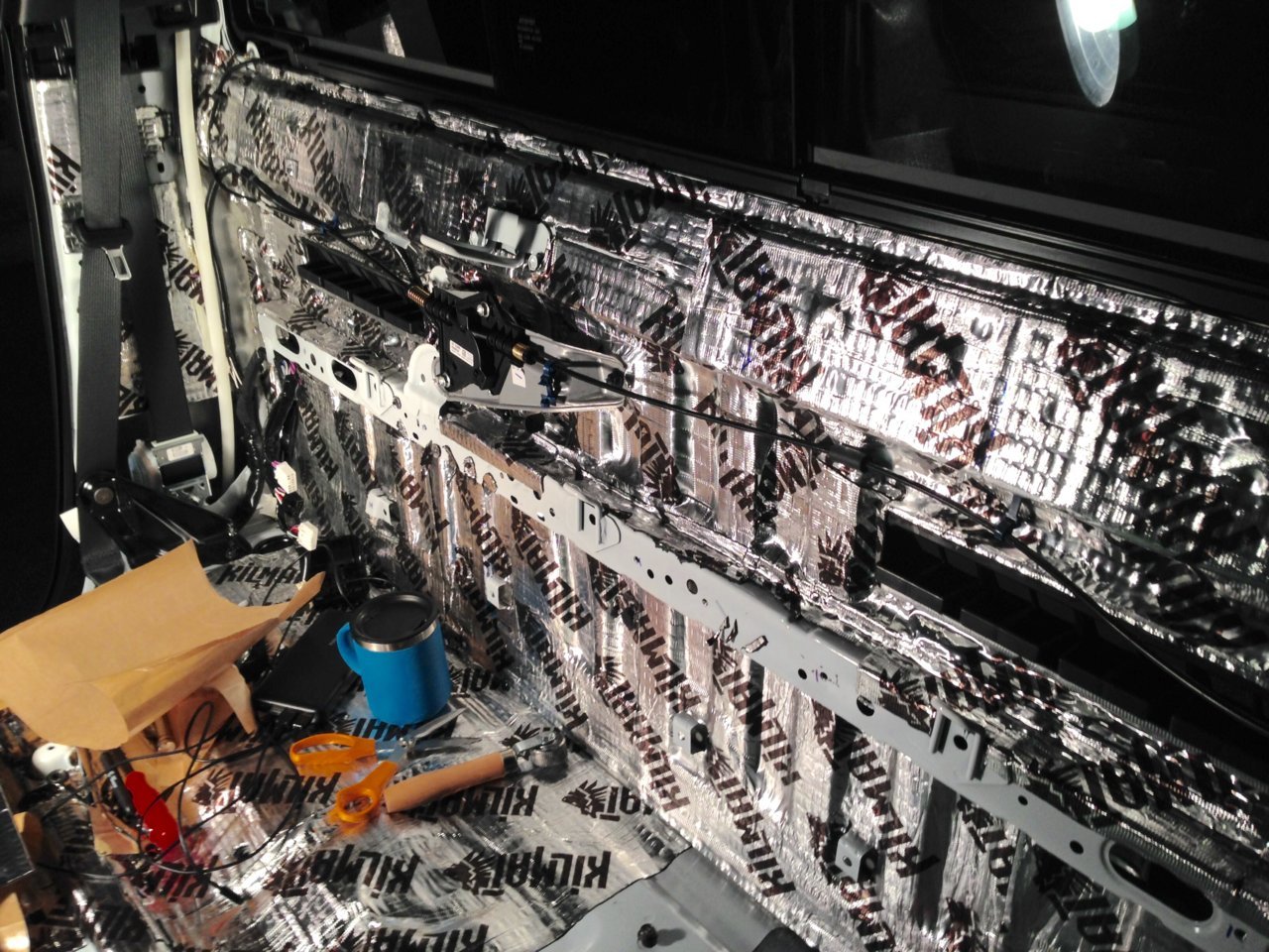

    I did this before installing my rubber flooring. did the kilmat with the noico foam on top. works great.

    Wow. That looks like a professional job!
    I should have taken out the front seats when I started doing mine; I think it may have gone faster.

    Not a very good photo, but here's mine.

    That area and the doors make the biggest difference imo. Looks good.
