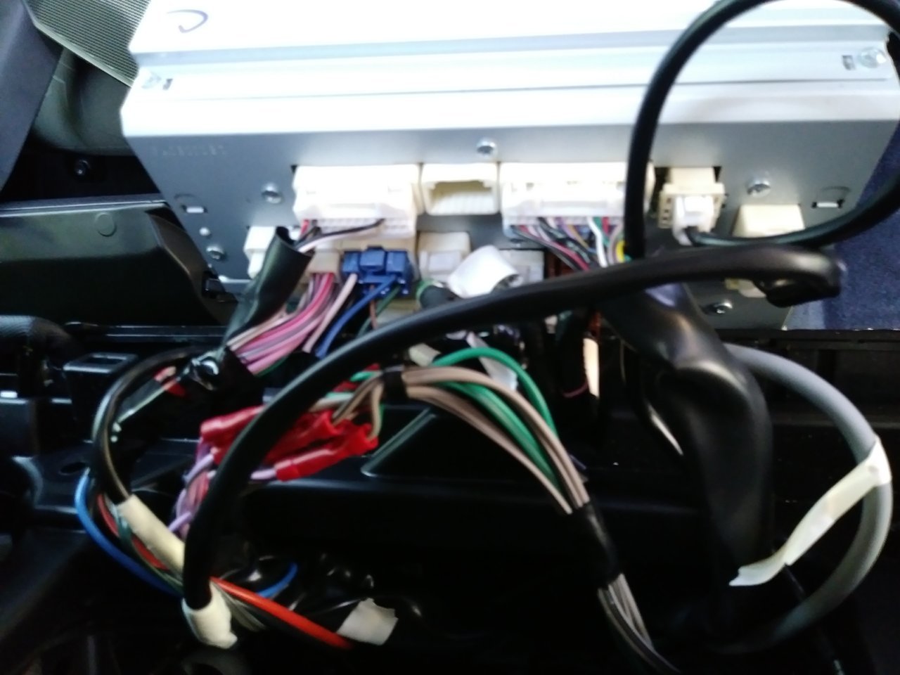

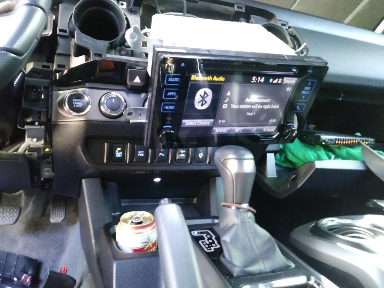

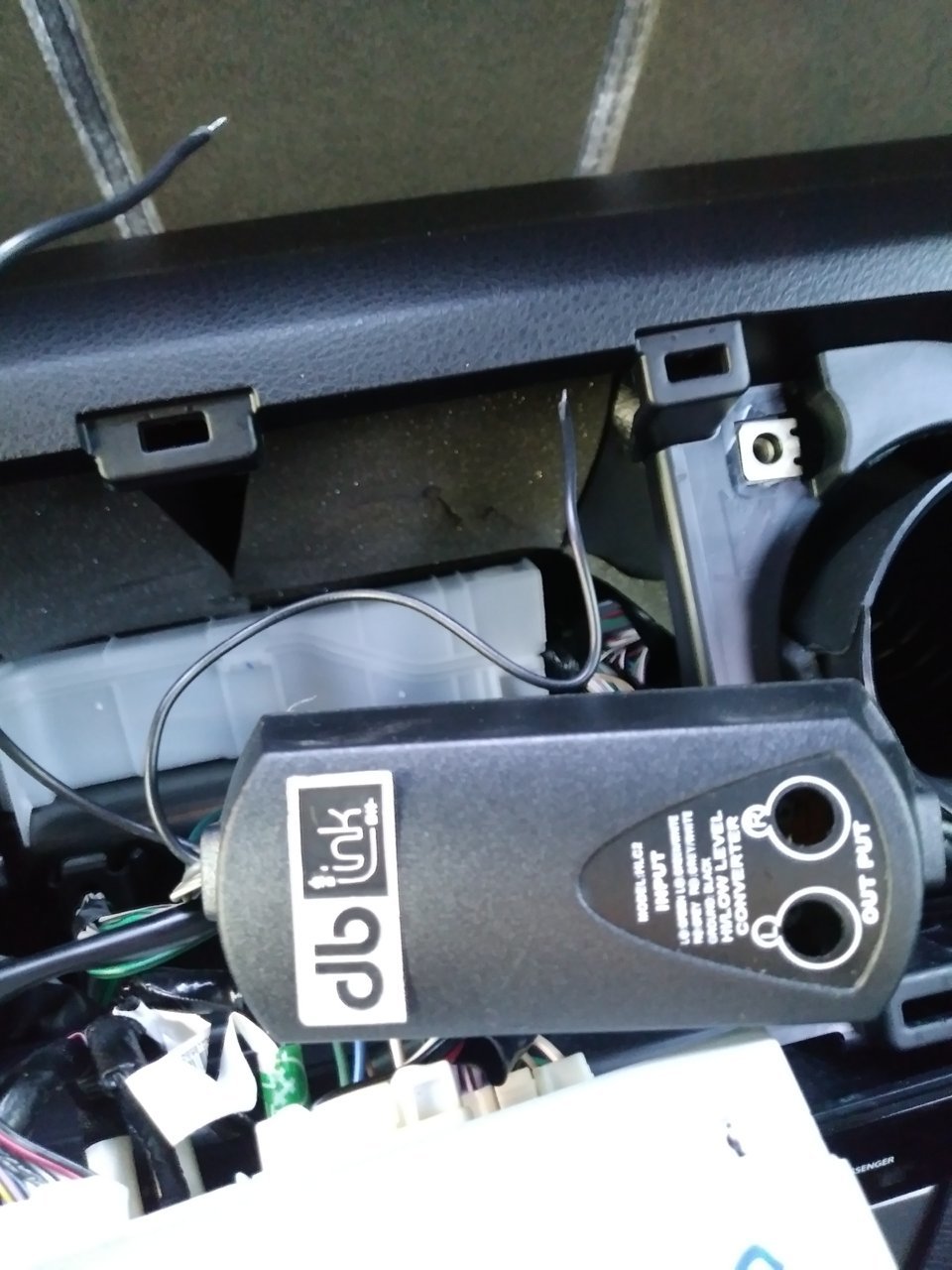

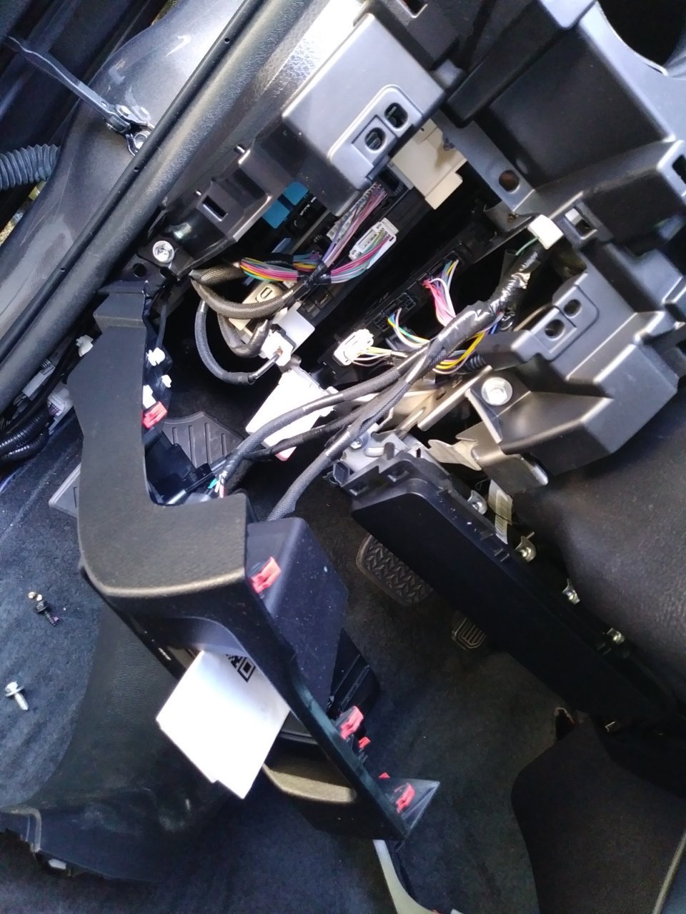

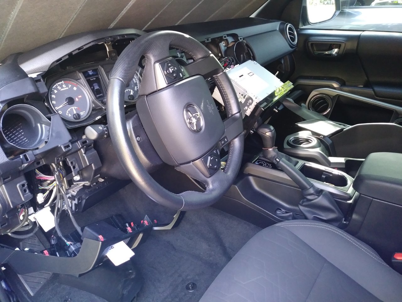

    Here's some pics of what I did after work today. Removed most of the dash, and the Head Unit, and discovered this odd contraption, possibly the infamous Line Out Converter, with 2 exposed wires. (see last pic) Capped those and can't replicate the issue. I may have solved it...
