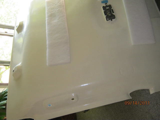

    Not enough
    What thickness Foam for the Roof? I got my liner off and looks like they have some type of crappy white foam 1/2-3/4" thick. Could I got with 1/2" foam in roof?
    Thanks

    I don't recall any foam up there....can you post a picture?

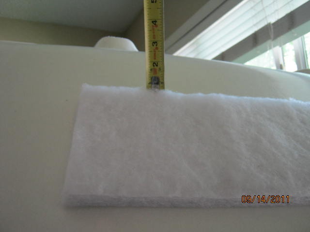

    05 Pre, DBL Cab
    Not enough
    It is like two strips across the mid and back sections. 6"x30"x1".
    Pic attached.
    thanks

    Steven
    DFW, Tx.
    09 Double Cab TRD Sport 4x4
    That's really just to prevent it from rattling on the metal up there. It's not for sound proofing but just intended to keep noise from being made due to materials impacting each other.

    Gottcha, but its 1" thick, if I removed it how thick could I go on the Foam and deadener materials?

    05 Pre, DBL Cab
    Not enough
    3/4" - 1" but like he said its just to stabilize the liner. But it looks like there is room for .5-.75" or so Foam and .125" stick on sound deadening pads.

    DFW, Tx.
    What exactly are you trying to accomplish up there?
  15. Sep 15, 2011 at 2:39 AM
    #35
    DevL
    DevL Well-Known Member
    Feb 23, 2010
    #31952
    1,913
    I did CLD and 1/8" foam on the roof. You dont need more than that. Also expect you ride to smell like solvent for about 4 months once you use HH66. My roof is totally silent.

    05 Pre, DBL Cab
    Not enough
    I am wanting low noise and better acoustics for the sound system.
    I just thought if there was already room for 1" factory stuff and looks like plenty of room for at least .5" of sound deadening stuff to up there then why not?
    I see your 1/8" and CDL was good for you. If it was tight fit then defiantly need to use that, but if there was plenty of room..........why not go thicker?

    mattg43 Well-Known Member
    Feb 22, 2011
    #51640
    844
    Texas
    08 Prerunner SR5 DC
    SwingCase, driver side. PVC Bike rack. Aftermarket stereo.
    Its not needed. The purpose of CLD is not to block noise, it is to kill vibrations. 1/4 coverage (note that is one quarter, not 1/4 of an inch) is all that is really needed. More may give you slight improvements, but on the roof the point of diminishing returns comes VERY VERY quickly.
    The only time you have a lot of noise up there is rain, and the CLD will take care of that.
    The CCF is there to prevent rattles and give a good fit. No more, no less.
    the roof already has some ridges that help stiffen it, and there is no active vibration source for the roof (speakers playing, constant thumping up there) so "overkill" is truly a waste of time, money, and materials.

    #18467
    5,926
    Steven
    DFW, Tx.
    ^Is right...which is why I asked what you were wanting to accomplish. The roof doesn't make any noise on it's own. Rain or extreme bass frequencies will cause it to make noise. I added deadener to mine to kill potential resonance and the foam to keep rattles down.
    Use each product (MLV, deadener, foam) for it's intended purpose. Using foam for noise blocking is like using a potato for a TV remote.
