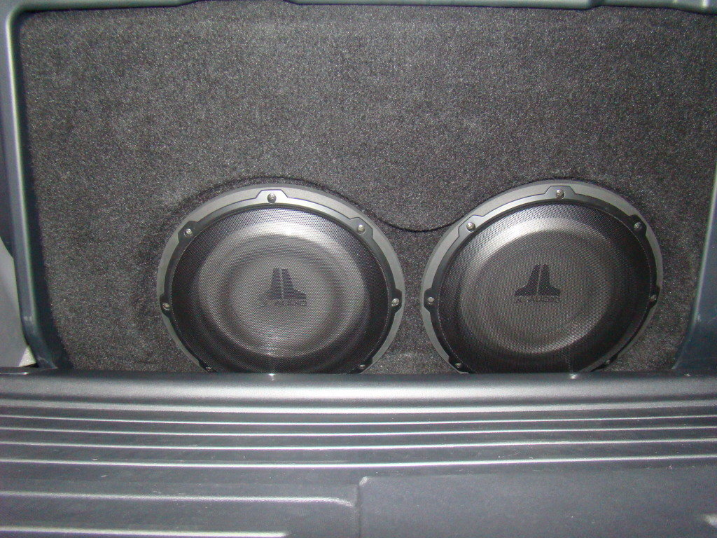

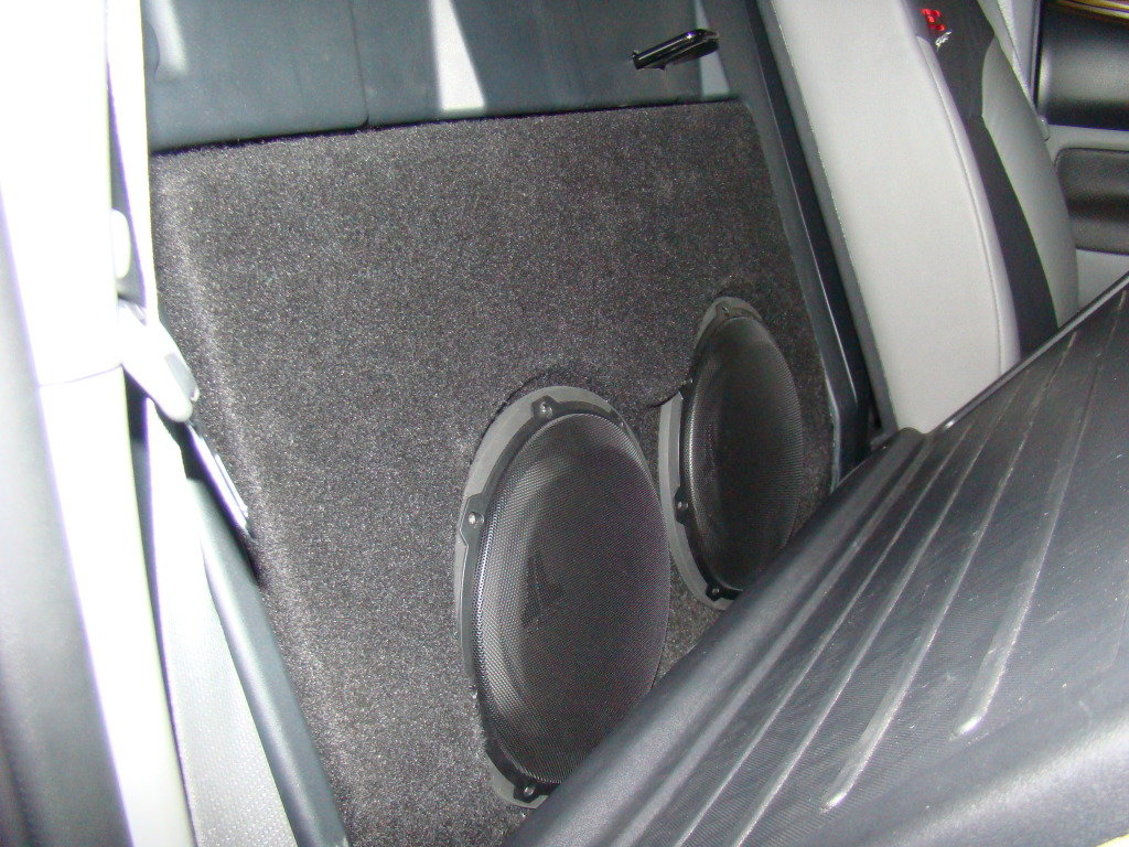

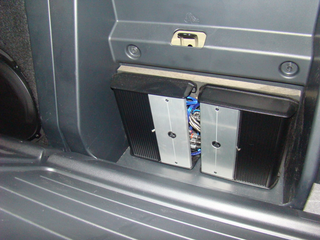

    I did much research before i decided on JL audios sub box setup specifically for 2nd gen tacomas, including JL amps.
    Removal of the rear seats plastic panels helped as well.
    It rocks.

    I have a JL box with 2 10"s like the one a few posts up. I also replaced all the speakers, have an alpine power pack for the speakers and an alpine amp running the subs. I kept the factory HU because I wanted to keep that factory look. Couldn't be happier.
