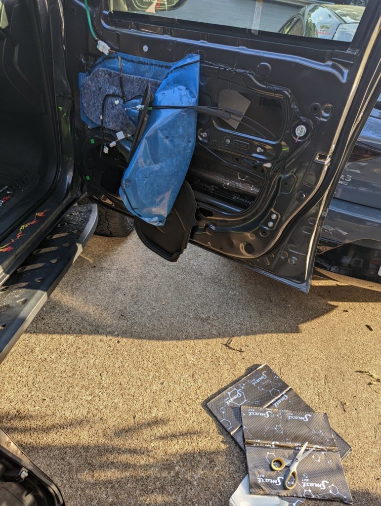

    The butyl mat + foam top layer is pretty generic and can be found in most tutorials. Basically the butyl goes on the outer door skin plus a few small squares on the inner door skin (directly underneath the stock vapor barrier plastic):
    The closed cell foam gets jammed between the vapor barrier and the door card (the plastic interior panel).

    +1 for ResoNix. Not only do they make great products, but their support (and educational content) is top-shelf. Their prices stung a bit, but I figured if I'm going through the significant effort of application, might as well use top-shelf product. I lined doors (shell / trim panel) + rear wall with butyl, then used their fiber mats on rear shelves + door trims. The fiber mats were really the secret sauce for noise reduction in my application.
    It was a lot of frustrating work, but I'm very pleased with the results. Much less road noise + tire hum, but more importantly for me my stereo sounds absolutely incredible.
