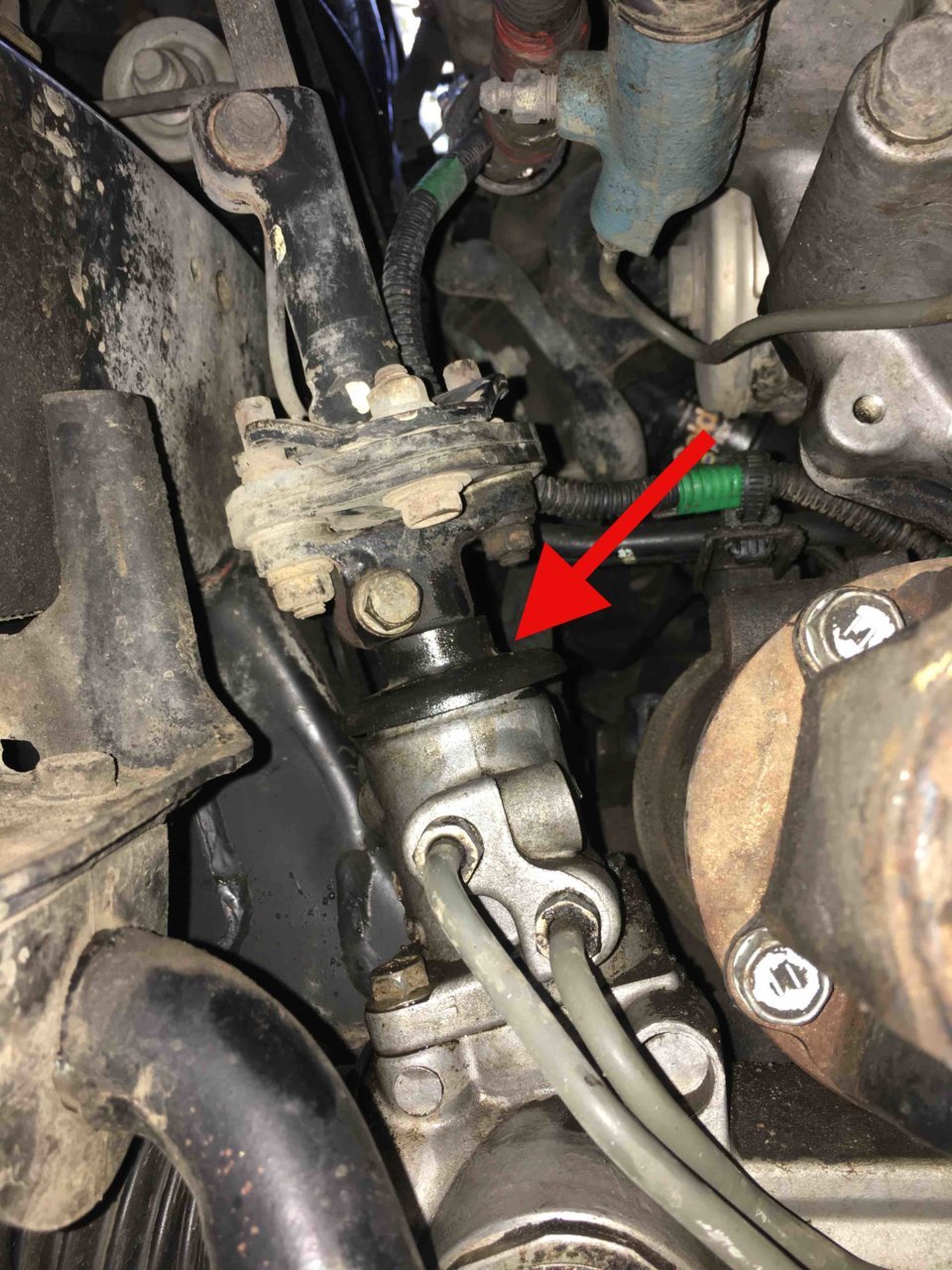

    Today I notice a leak of transmission fluid under my truck. Poking around, the source *appears* to be coming from this gasket-thingy in the image.
    Can this be the case? If so, what is this called and how does one replace it? Thank you!

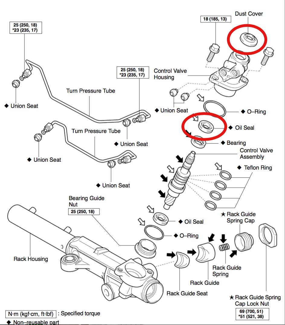

    Fantastic! Thank you. This one may be a bit beyond my skill set / tool set, but that is the information I needed.
