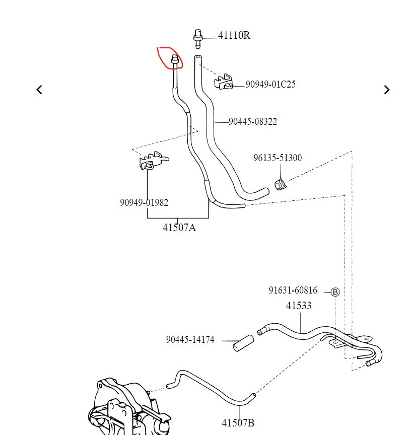

    Anyone know where to get discontinued parts? Need part number 41507-35060. Parts department at dealer says it's discontinued.

    My quick search says that is the front diff vacuum tube? The one that runs from one of the vacuum solenoids on the driver side fender and down to the ADD actuator on the front diff?
    If so I'd consider experimenting with some rubber fuel line (can buy from any local parts store). Just run the fuel line in place of that vacuum line and use hose clamps on both ends of it. That line isn't dealing with very strong vacuum, so I'd think standard rubber fuel line should do. Then just zip tie it to the frame and or steering rack so it ain't flopping all over the place on you

    Thank you. My hose is actually in great shape. What I need is the bleeder valve on top of the hose. According to my local parts dealer you can’t buy the bleeder by itself you need the whole part

    This came up recently if I recall correctly. Why not buy the breather and just grab a small length of larger diameter hose and use a worm clamp (if the breather does not fit)? Fit the larger OD hose over the existing tube and clamp it. Shove the breather into the other end and clamp it. Done.
    You're talking about the breather I circled in red, right?
    The other breather is part# 9093003136
  6. Feb 2, 2025 at 5:38 AM

    Yeah that's the one. I haven't forgot about this method. If I can manage to just grab the breather from somewhere it's just plug and play. Otherwise yeah this will be the methodology I go with.
