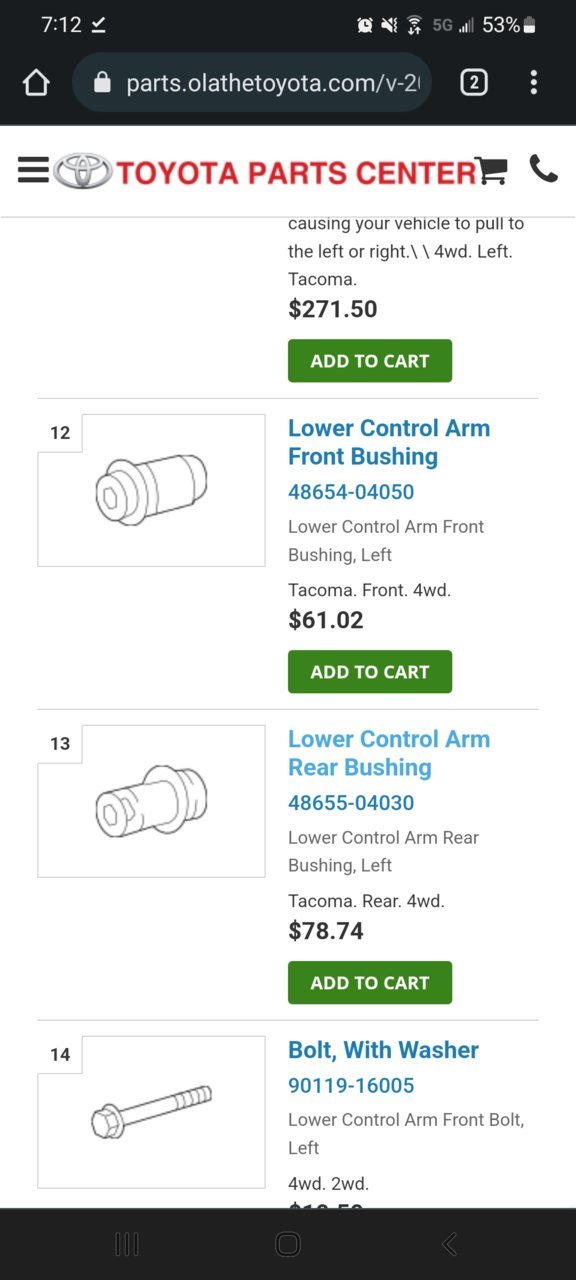

    Part 12 and 13?
    https://parts.olathetoyota.com/v-20...4-gas/front-suspension--suspension-components

    Yes, thank you. They are definitely different, as reflected by the different part numbers, which I have. A whole new lower control arm assembly with bushings and ball joints is like $475. Since the arm is not bent or rusted out, I see no reason to replace. I have my lower ball joints and bushing for the rear position already. Just trying to find the lower front. I'm just surprised that none of the other suppliers make the part. I have no issue buying OEM, just trying to save some money where it makes sense, given the mileage (246K) of the vehicle. The price in the link you have is definitely better than what the local dealership quoted me. Thanks.
