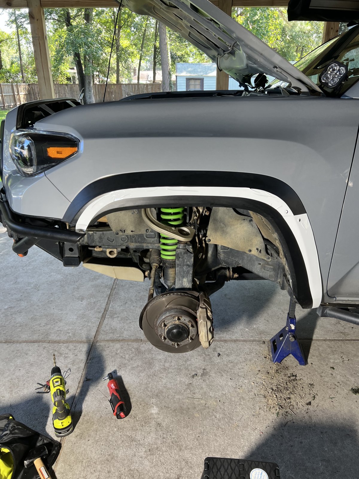

    Definitely don't need to tub the inner fenders to fit 35x10.50s. I'm running 35x12.50s and with the C4 OTF fender trim I don't rub at all on the fender. Also have a very aggressive CMC from Chad (aka Bash Fab) but will be getting a full relocation done at some point.

    How do you like the C4 kit? I considered it but I'm probably just going to try and make my own fender liners from ABS sheet, a heat gun, and a few self tapping screws.

    100% worth it in my opinion. Made it incredibly easy to make a clean cut and their aluminum liners fit perfectly.

    Their template makes it very easy. Might be able to just get the template from them if you’re wanting to make your own liners

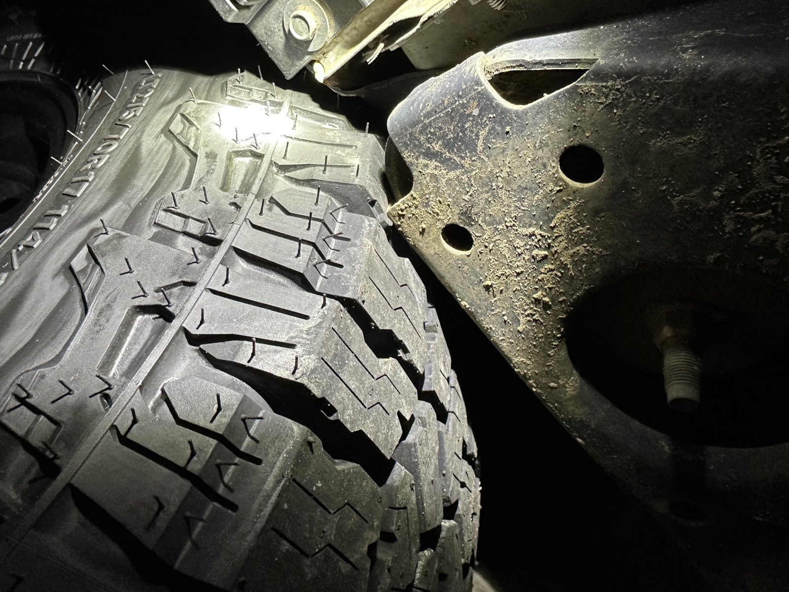

    Took trash off this eve.. and hit a small little hole… the pain that rub caused my soul. lol.

    The rub isn't hurting anything. I've had mine rubbing and cranking on everything in there to very little effect

    Thank god. I am over here thinking I’m gonna rip a knob off the AT4W day two of owning them.
