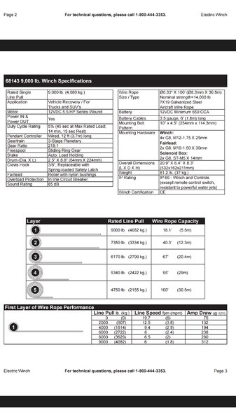

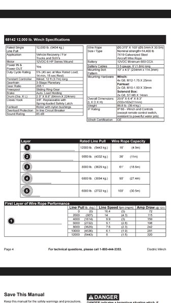

    More winch, more better. Lookup how much weight capacity that winch has per wrap of cable/cord, it drops pretty good per wrap. You dont get full 9klbs all the time.

    Here are the numbers
    9000#
    12000#

    The 12k is 100$ more and a lot more winch. Your less likely to wear it out if you go bigger.
    Also the wireless remote is only 40$ on sale
