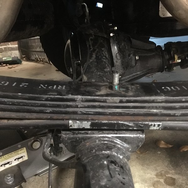

    Tried that first and the center pin was WAYYY off. Even lifting the differential up and down/ beating with hammer/tugging on the differential ect and nope... not even close

    Just gotta finesse it. No Hulk Smash needed.

    Maybe it's cause the other tire is still on the ground? It sure wouldn't pivot lol. Should I have both wheel off the ground?

    yes, both wheels off :facepalm: but only do one side at a time :thumbsup:

    Might be my problem then. I'll give that a shot tonight.
