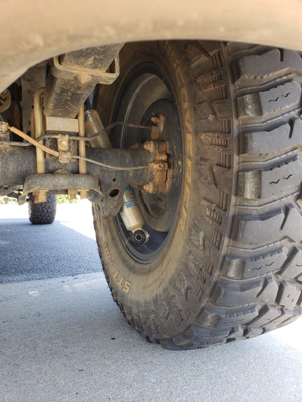

    Well... they replaced the bolt. Didn't charge me anything for it. Went around and checked the other nuts and bolts, too. Not bad. Kinda freaked me out when I saw the shock just hanging like that.

    Believe me one of the first things I looked at was the u-bolts! :rofl:

    Think I should photoshop the blocks out of my picture then re-post it before anyone notices?
    I swear I'm getting a leaf pack soon. :anonymous:

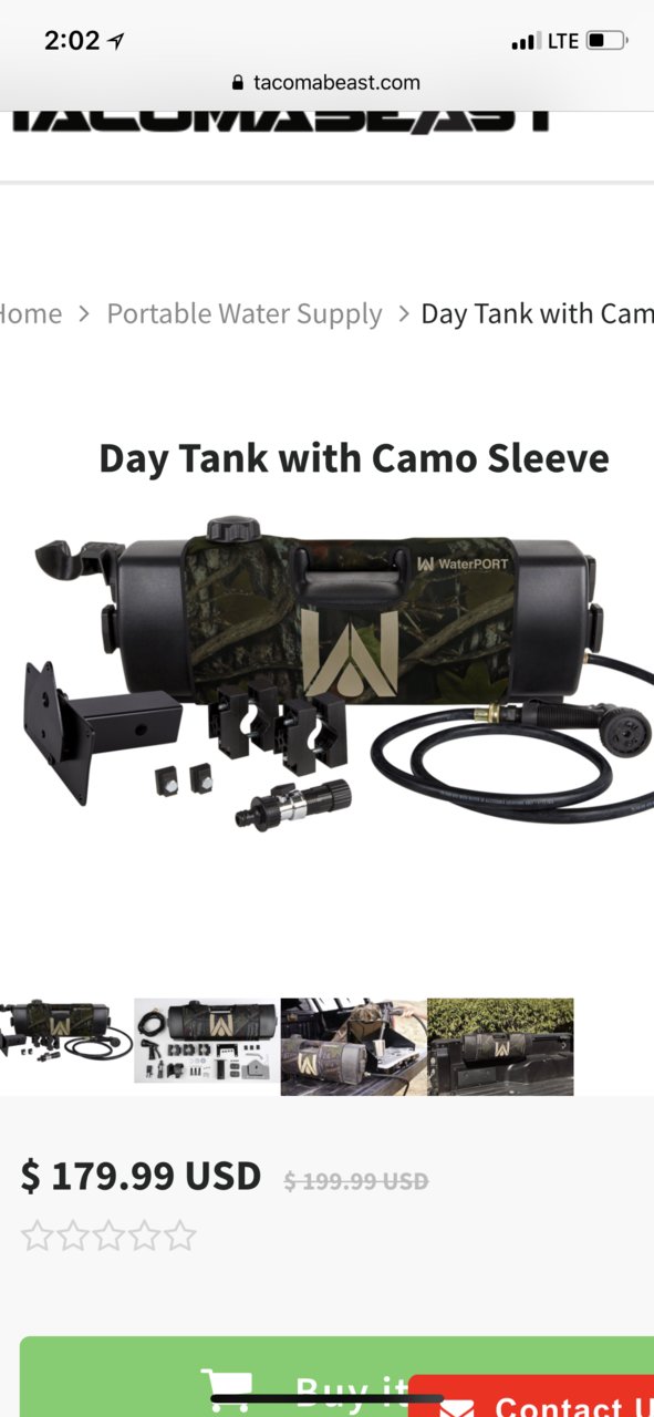

    B859D553-5943-4E30-B92B-0062F3AE03C9.jpg Saw this is a new product. After I just bought the 3.3 gal version two weeks ago. :frusty:

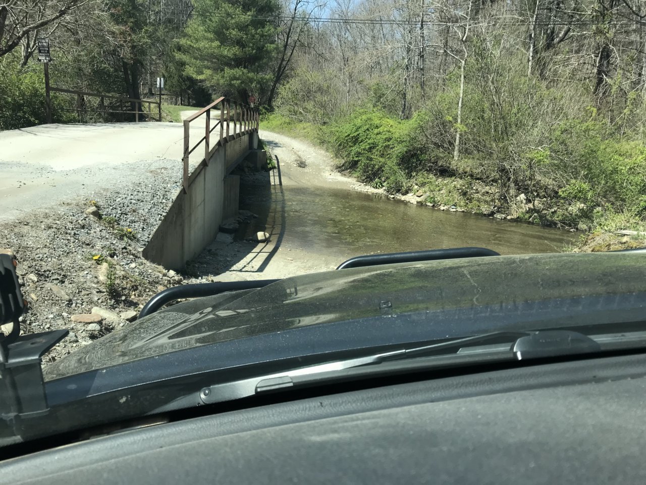

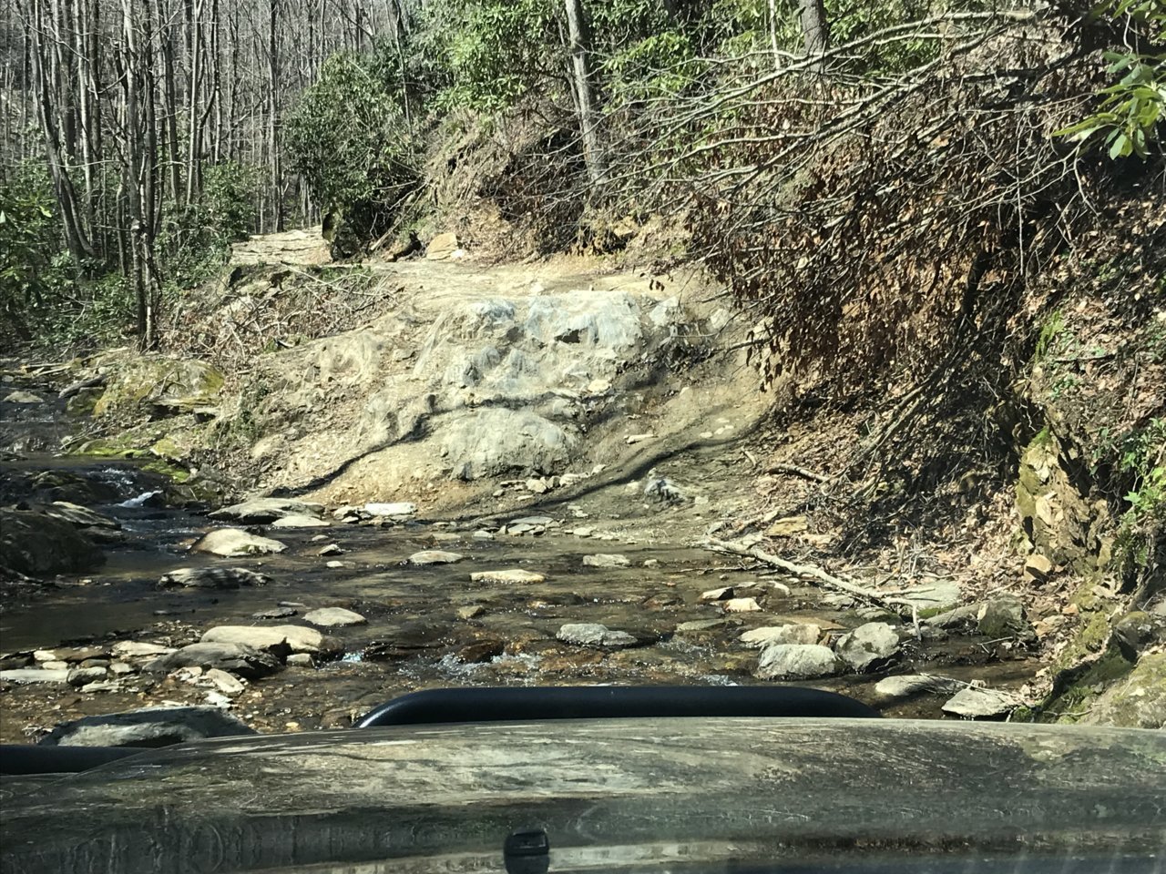

    What a day. Had to go to banner elk to inspect a church at 1. Passed Richland road on way up, thought i might hit it on way home if i had time. I did, solo. Never go solo right.
    Obligatory “prove you wrre there” pic
    The “gate keeper”
    Made it through in a little over an hour. Good run.........

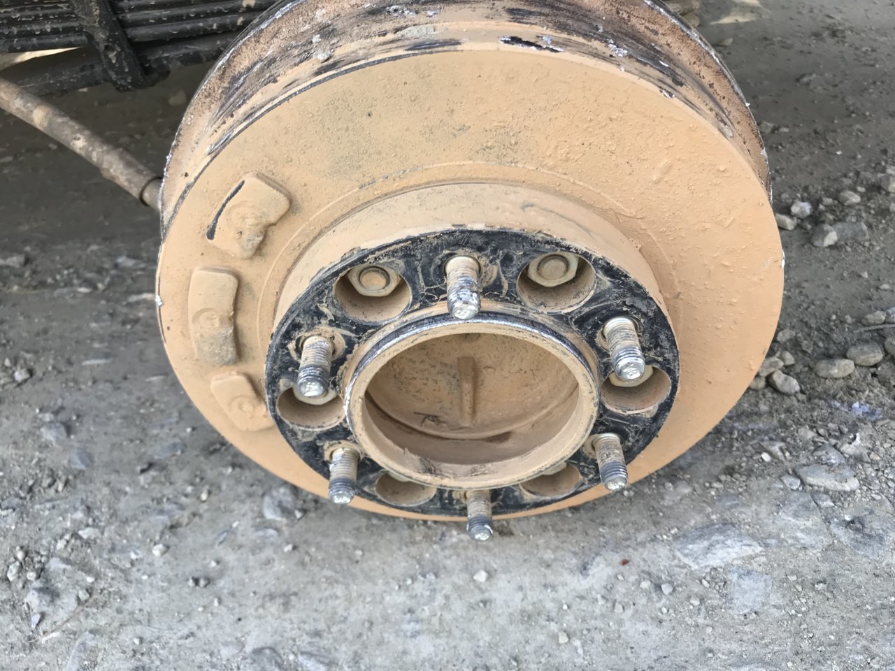

    Part deaux........

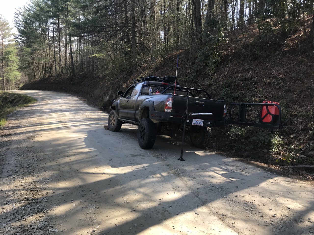

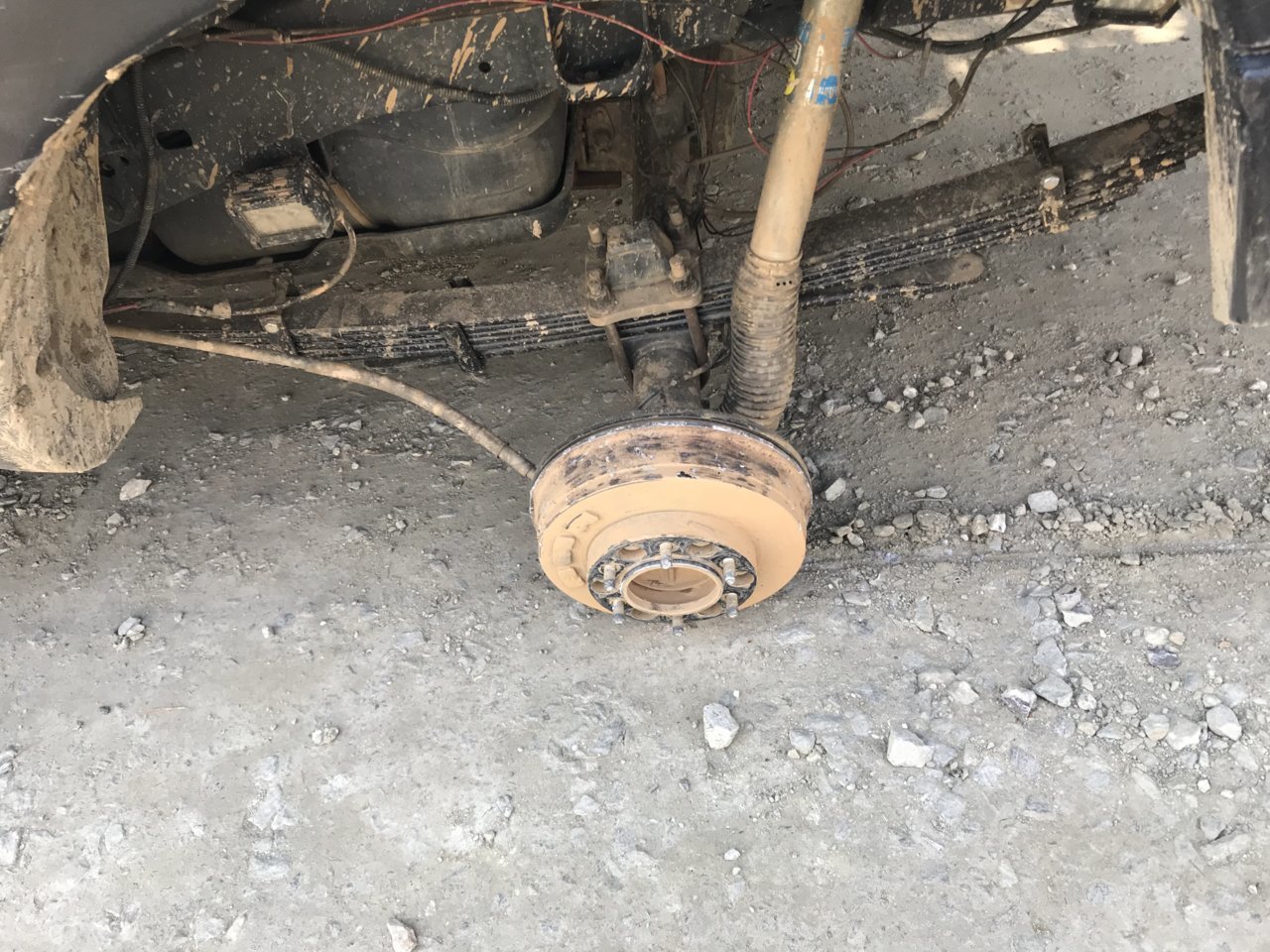

    Precursor, got home, wife said she had worst day ever, i said i bet i did, i listened to her, she listened to me, she agreed with me

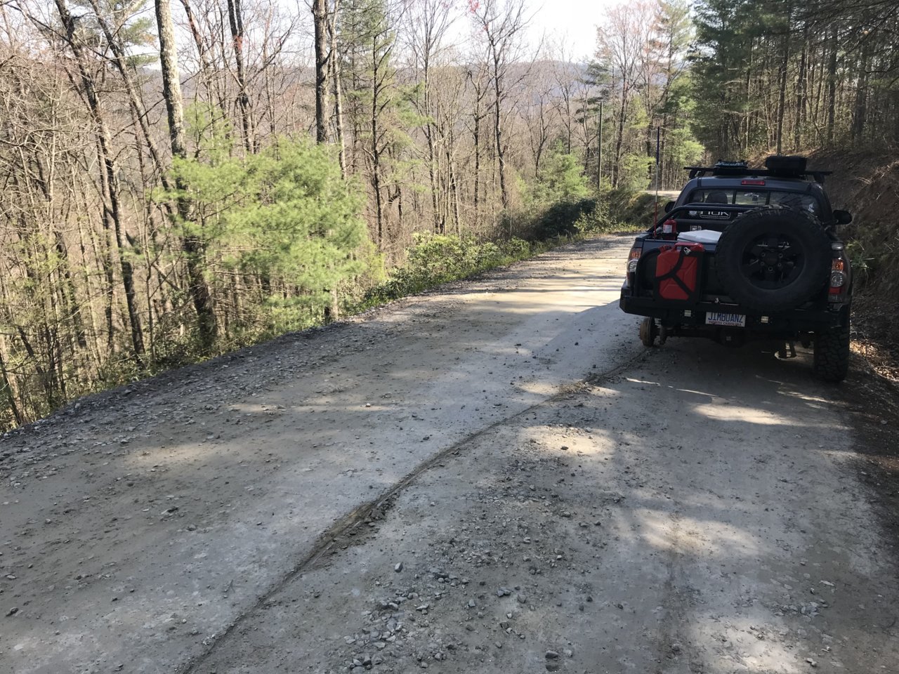

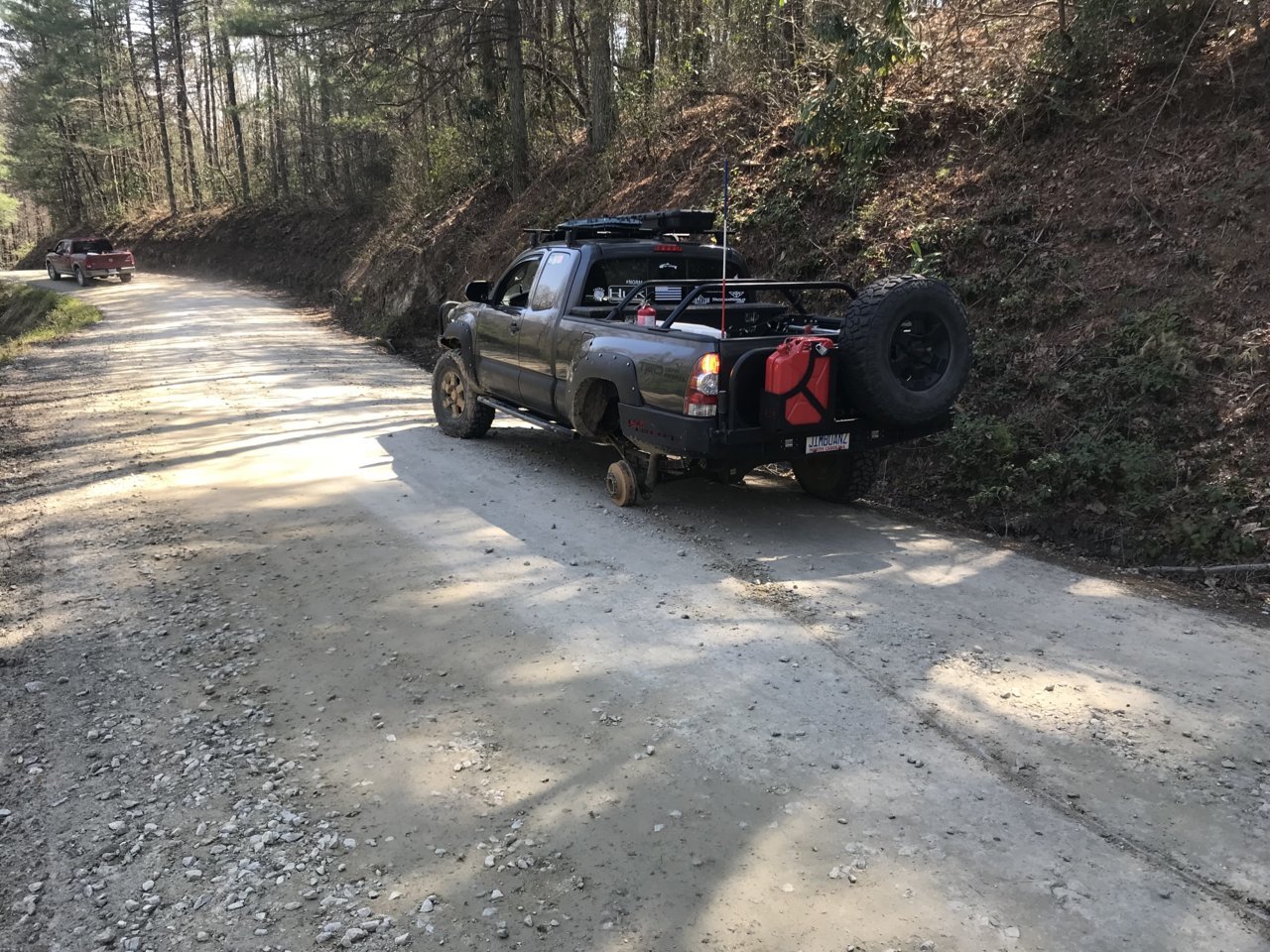

    So, made it through richland, heading out the dirt roads on the other side, i believe i was on samson when this happened

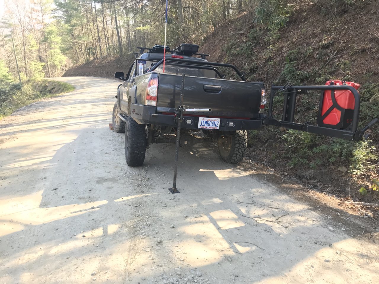

    I thought U bolts immediately, but no. My driver rear came off and passed me and launched down into the ravine. Gone, 100 foot sheer drop. No going after that sucker. Lugs evidently got gone. So i had to swap spare with a pos stanly 3/8 socket set. All my tools in garage from leaf swap. PITA. Robbed a lug from other 3 wheels and put 3 on the rear and made it home. Some pics and dash cam. 2:00 in
    8F923F88-A53D-4717-B6FC-63145D20CDBD.jpg 752F9B43-F94D-4D30-AAA8-4A852EB8027B.jpg 0758FBB0-9C02-4BBC-BE84-BCD3DA5A7AC1.jpg 14F7AC0B-35AD-4367-A6F2-5F858FC6AC92.jpg 024CAF55-C737-4F36-AE0D-93CC7D9C9136.jpg 4E6D9B06-8AE0-43B6-AF21-BC6303B254E0.jpg 21FF2FD1-2731-488F-8BB8-87F636F2E76E.jpg

    Lessons from today
    Check nuts, all nuts
    Dont bother with a 48” high lift. Needed the 60 stretched out to get rear high enough to get new tire on
    Carry tools in truck
    Something to chock a tire, i had bricks
    Check nuts, and lugs
    Nut check.
