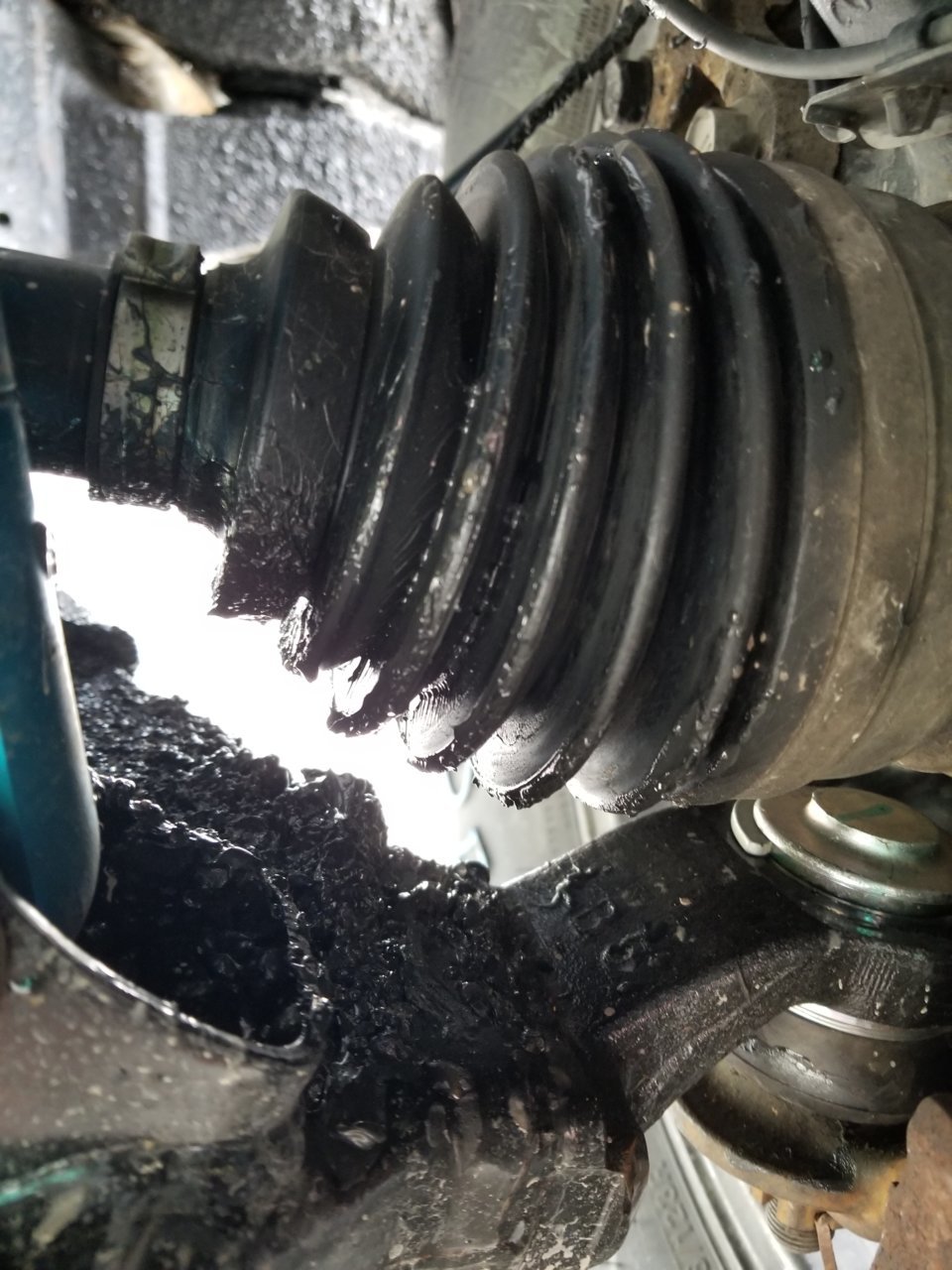

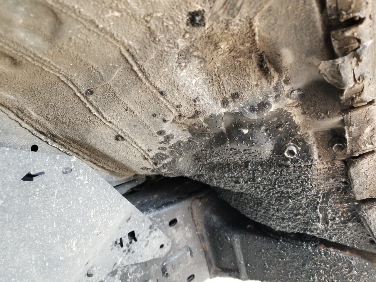

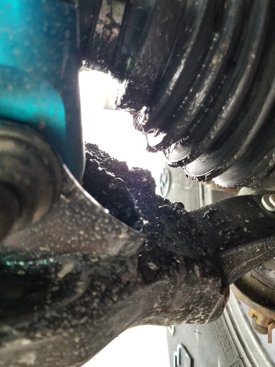

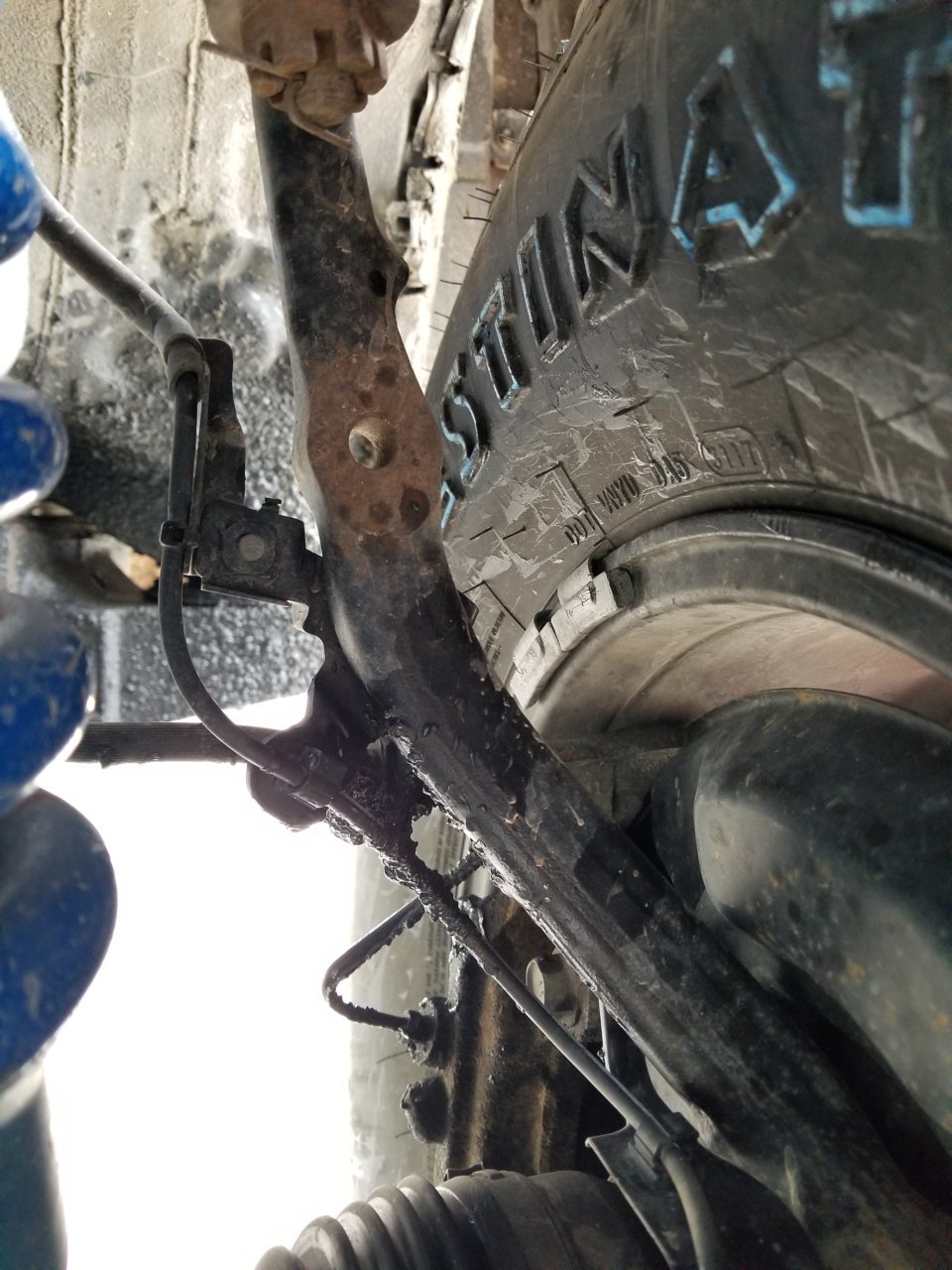

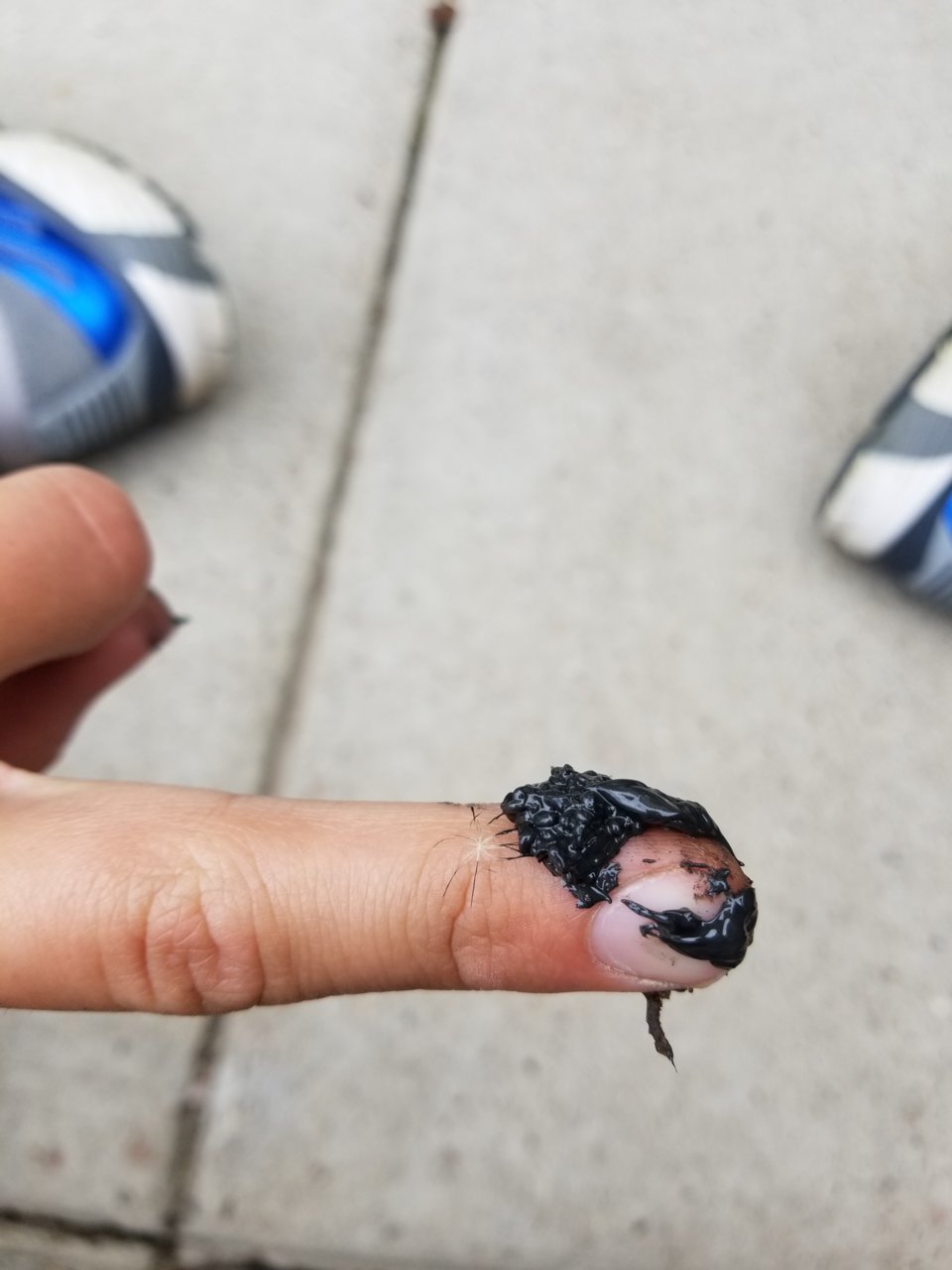

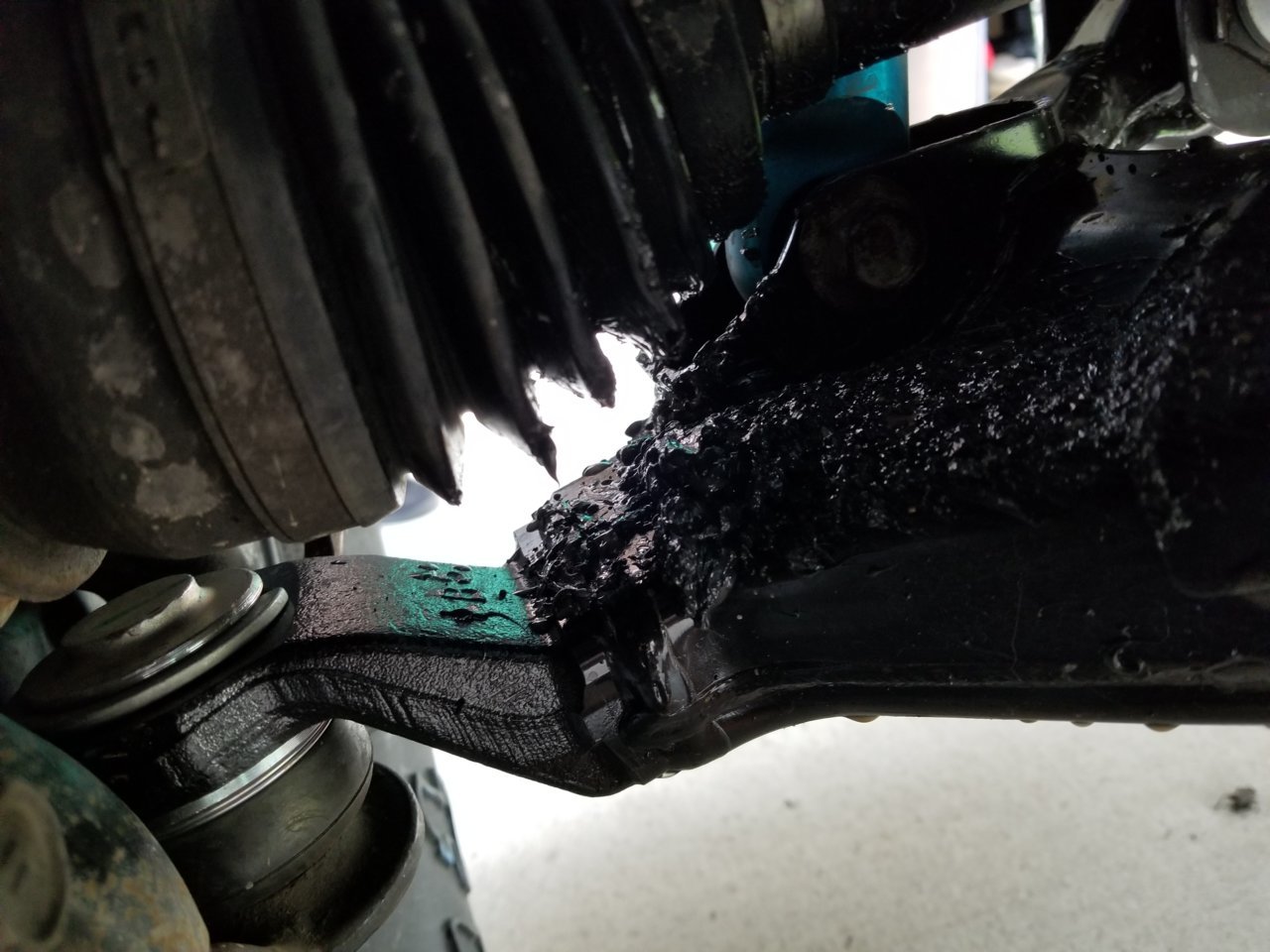

    Guys, need help. Replaced my LCAs two days ago. Got gas today and noticed a fuck load of grease all over the LCA, Boot, break caliber, brake lines, and the back of the wheel well...
    What could possibly cause this? It's only on the drivers side. Didn't notice anything coming out of the UCAs...

    What he said ^^^^^^^ need to put a new boot on. Or you could just go get a new CV axle and then take this one off and take your time in replacing the boot and have it for a spare.

    This.

    Well damn! That was fast. Thanks yall, looks like I have a memorial weekend project

    Just reading the first line I was like axle boot! :thumbsup:
    I have seen cars get crap wrapped up in the cv and tear the boots also just age deteriorates them.

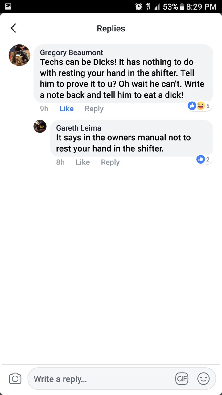

    I started a shit show on my Scat Pack forum with this post. The sticky was on my invoice because I specifically asked the service advisor to ask the tech what could cause such a catastrophic failure of 5th gear.
    I'm in no way taken back by the way it was written just the fact that such little weight from your hand/ arm. Plus the weight of the shifter would cause it.
    My grandfather always told me never to use the shifter as a hand rest, but that was back in the late 70's and 80's. You would think with today's technology, they could build a trans that could stand up to a bit of weight.
    And yes, I'm 100% guilty of doing this. Especially in 5th gear on long trips home.
    And the dealer still covered it under warrenty.
    Btw. So far I've found 4 different vehicle manufacture quick start manuals including my SRT manual. Audi, Ford, Chevy and Volkswagon as well, that specifically say. "Don't use your shifter as a hand rest"
    I'm curious if any of you manual Toyota guys have ever spotted that in the quick start guide portion of you vehicle manual?

    Never been a fan of Dodge but if I owned yours I’d trade it in based on that sticky note alone.

    I mean, if when I went and picked it up today, if the tech came out and said "Hey, do you happen to rest your hand on the shifter"?
    That would have been more cordial, but I wasn't even worried about that. I was more concerned that it's a brute of a transmission. the Tremac TR6060. And they should be able to withstand a few lbs of someone's hand resting on the knob.
