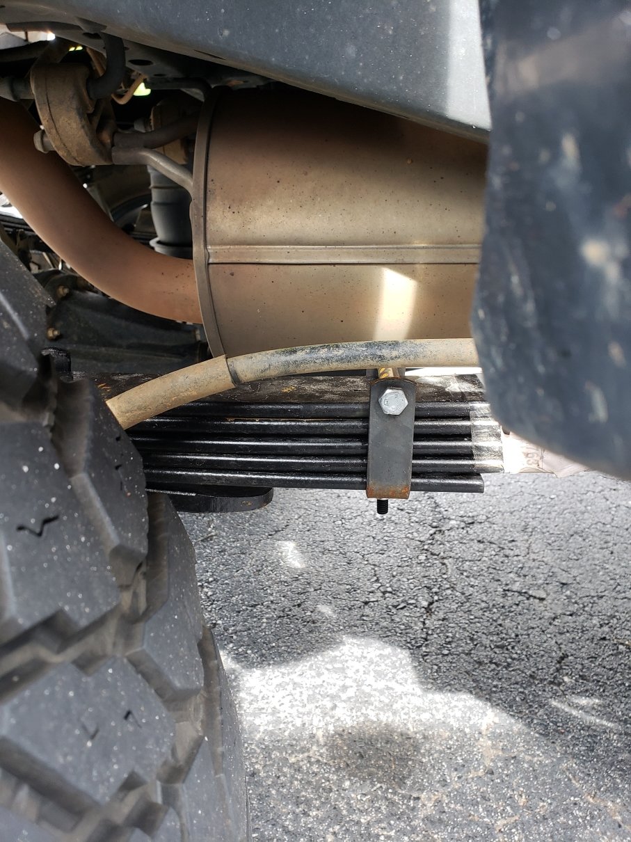

    Front long travel and Rear long travel including upper and lower rear control arms. Running 456 gears with rear ARB locker . LFD full roof rack with clamshell RTT
    damn that be alot of leafs .

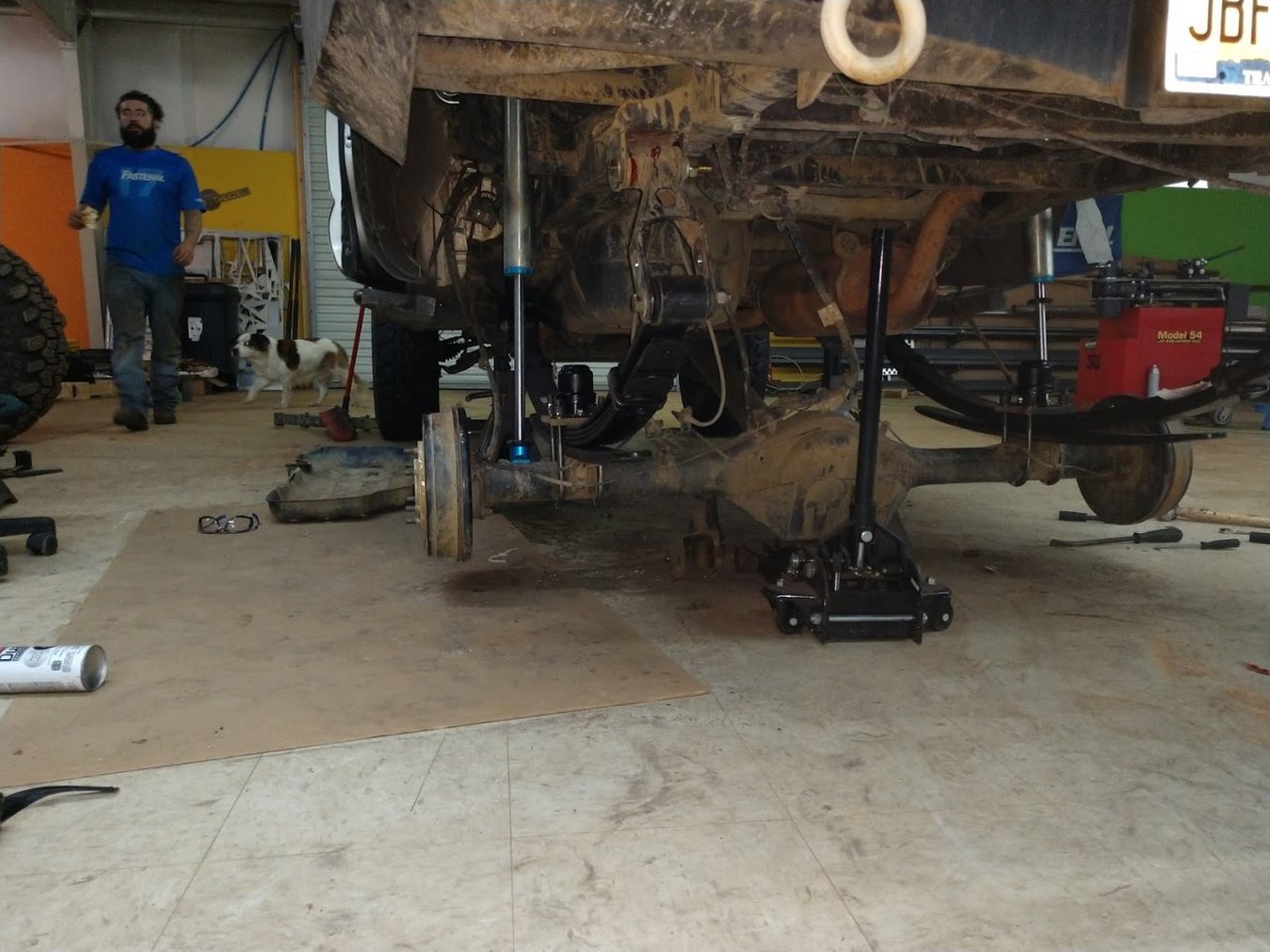

    As long as we're talking suspension setups, I'll cross post what I added to my build thread earlier:

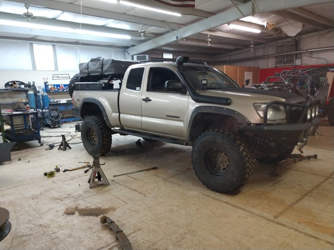

    Spent a little time in Eddy's shop this weekend. We pulled my Allpro expo leaf pack out and swapped it for a set of Chevy 63s. Also pulled my rear Bilstien shocks and replaced them with 2.5" 14" travel remote resivior Kings.

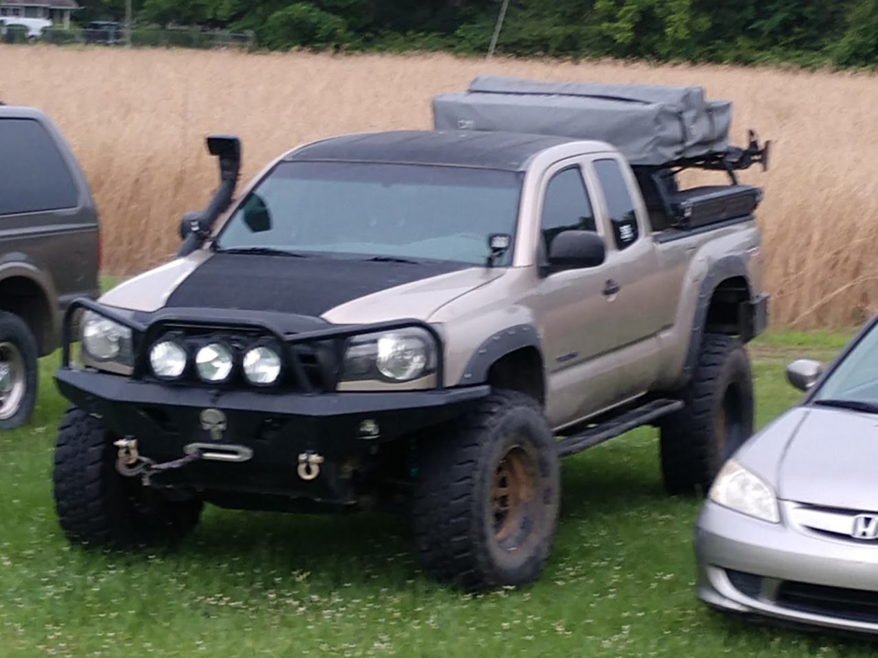

    This is how it looked with my OME 886s up front and the 63s in the back.
    But we weren't done yet.

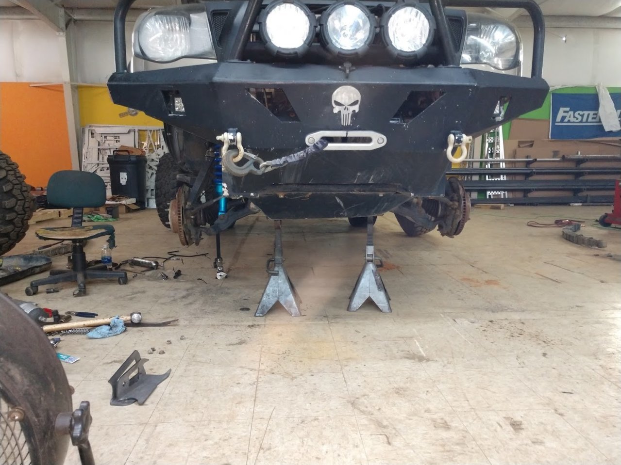

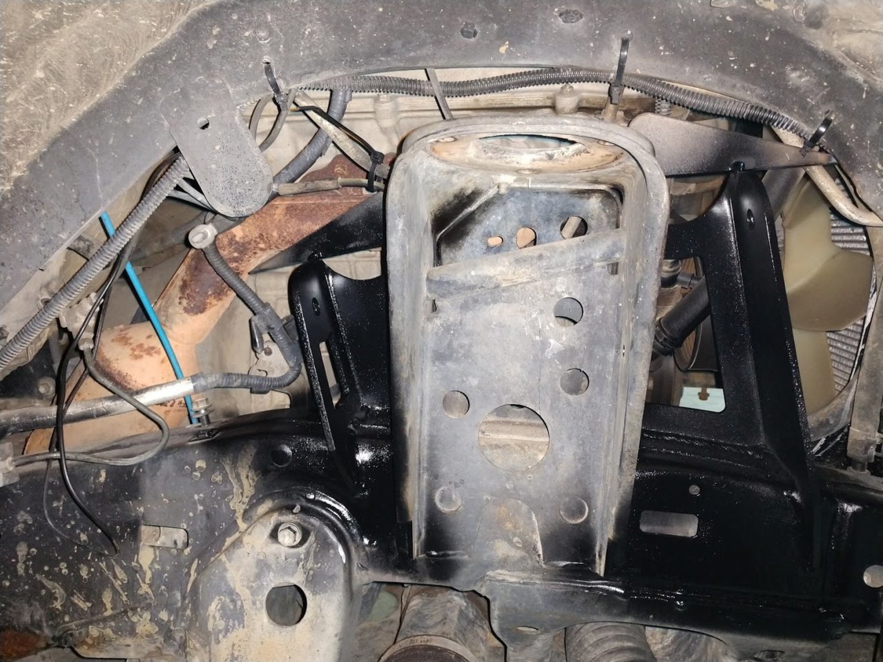

    Gusseted the coil buckets up front. Then installed these:

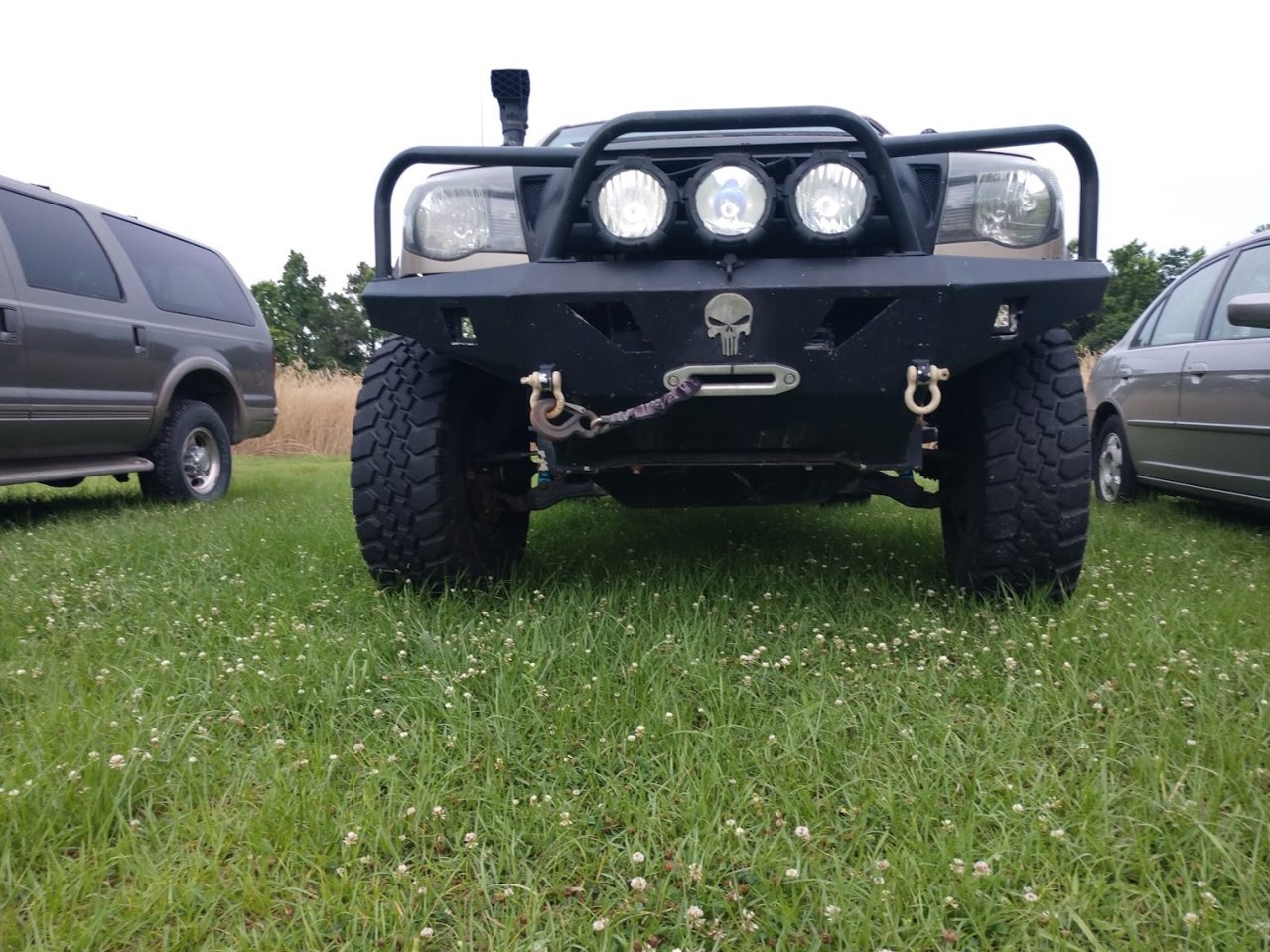

    They did add an inch of down travel as advertised. OME on the drivers side, King on the passenger
    I need to adjust the preload on the kings, the front is sitting back at factory ride height right now. Controll arms are flat. But it does prove you can clear 37s with no lift. I ordered a cheap spring compressor this weekend. When it comes in @ahspurlock and I will get them adjusted:
