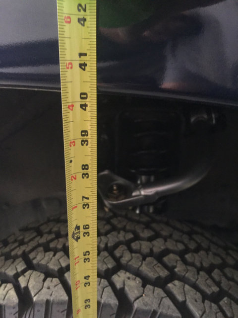

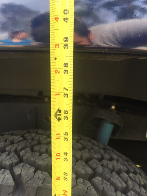

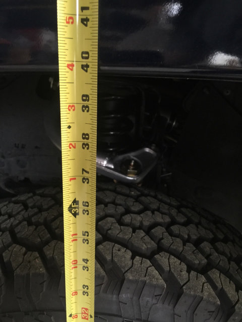

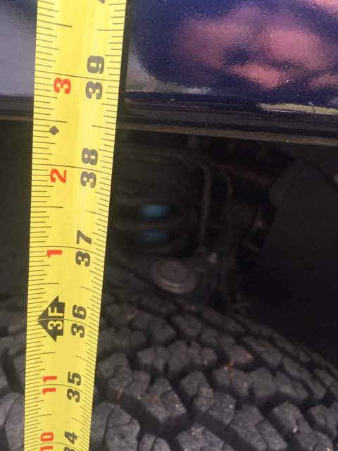

    Ugh!!! I'm still concerned to why I have an extra 2+ inches.

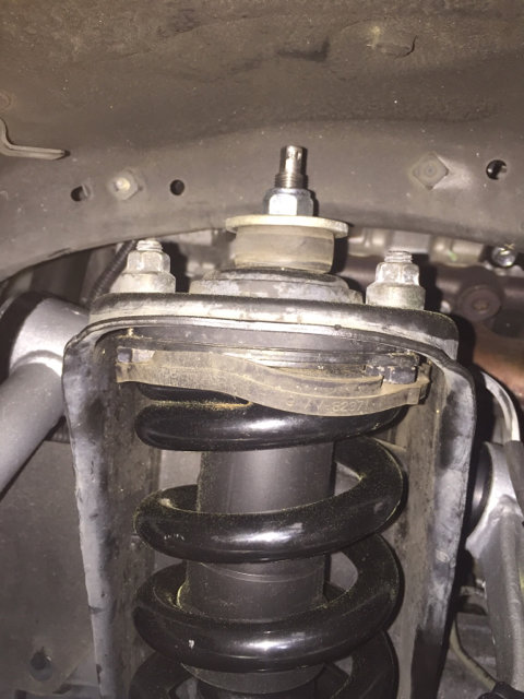

    Pictures of the shocks, specifically the collars.

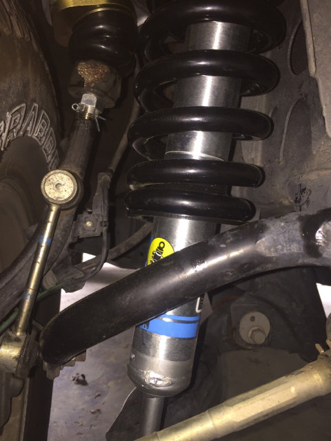

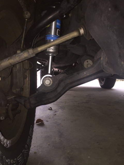

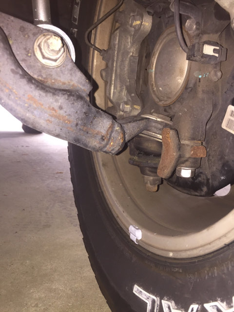

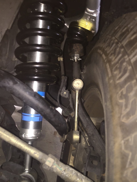

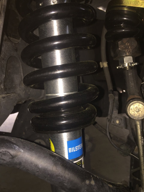

    Before (Dr):
    After (Dr):
    Before (Pass):
    After (Pass):
    Driver:
    Pass:

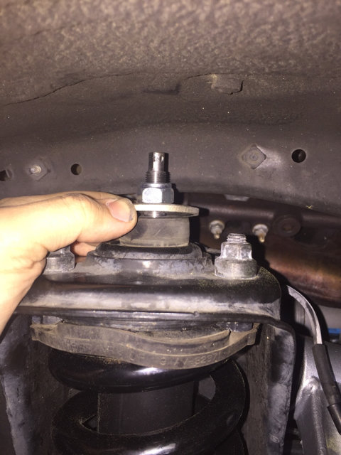

    Don't see anything out of the ordinary. Let's see the top hats. Did you take the spacers off?

    Collars are with skinny part up and fat part down. 7b1bfb63b60384010c38c53e7ad7536f_17a2aa8191cea26634686408ea1f322c7c900eb8.jpg

    Big spacers off, top plate spacers on.dd7e8cceed5b2e9a809e0db2973ceeb0_42dc55d62c62327619a8eebeea9ef133494326db.jpg

    Hmm Idk. Is that top bushing touching the frame plate? Doesn't look like it.

    ¿que? The coil rubber pad? Well I just found my knock! Maybe on at least the driver side perhaps.

    Yea that's what I saw, that gap up top.

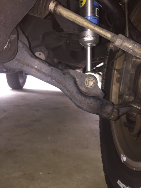

    Good eye! Passenger side is fine, I was really just worried about the lcas, I'll double check nuts and bolts, maybe the alignment shop tomorrow will put me to ease after I see the numbers.

    You're running top plate spacers, 5100s at .85, and 885 coils... There you go. That's a lot of lift

    I thought that's what you had to do for the full 3". I guess I can't read (no surprise here!!) I'll probably drop it down to 0" tonight, or should I just pull the top plate spacer.

    Mine did this for awhile.. I thought it was lca bushings then I thought maybe uca uniballs.

    The strut washer and nut? I'll keep an eye on them and meet retightening.

    Yep. Mines still a little loose, rust took its tole.. my fix is some fox 2.5s...
