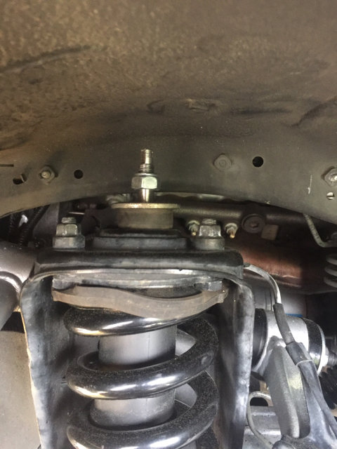

    Of course not... :facepalm:

    Idk. But something is wrong. That stem shouldn't be that high even with the missing bottom washer. It's like the rubber grommet isn't tall enough.

    I'm so mad at myself right now. I'll change it tonight and put in the washers correctly this time. I just want a drink haha. Good news is I'll never do it wrong again!

    If I'm not mistaken, the bottom of the coil spring sits in a groove that's lower than the rest of the bottom bucket. Did you get that in?

    What I'm saying is, even with the other washer in there, it isn't going to be right. Something else is amiss.

    I believe everything else is good. I have it set to 0", the bottom collar is installed the correct way, and the coil is sitting where it's suppose to on that collar.
    Not the best pic but I'm not home now to take more pictures. I've checked everything else and doubled checked they were set right. The new 5100s didn't come with new rubber washers, just the top washer and nut so being tired and in a hurry (11pm on a Friday) I didn't even think about the bottom set.

    So you moved them down from 0.85 to 0 and they got worse?

    No, my initial issue was my concern over how high the lift was. After dropping it to 0" it's not a tad higher than it was about .5" to 1" I can't remember my after measurements, I didn't take any pics. After putting the AAL in the rear the rear now sits level with the front to 1/4" lower, which I'm not a fan of, but you can't visually see the difference. Once I load the bed up though... I might end up taking that spacer out later to get the front a little lower. We'll see.
    Now the problem is with that top washer not sitting all the way, but I didn't put the bottom washer and rubber in.
